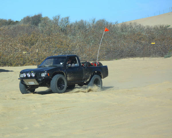

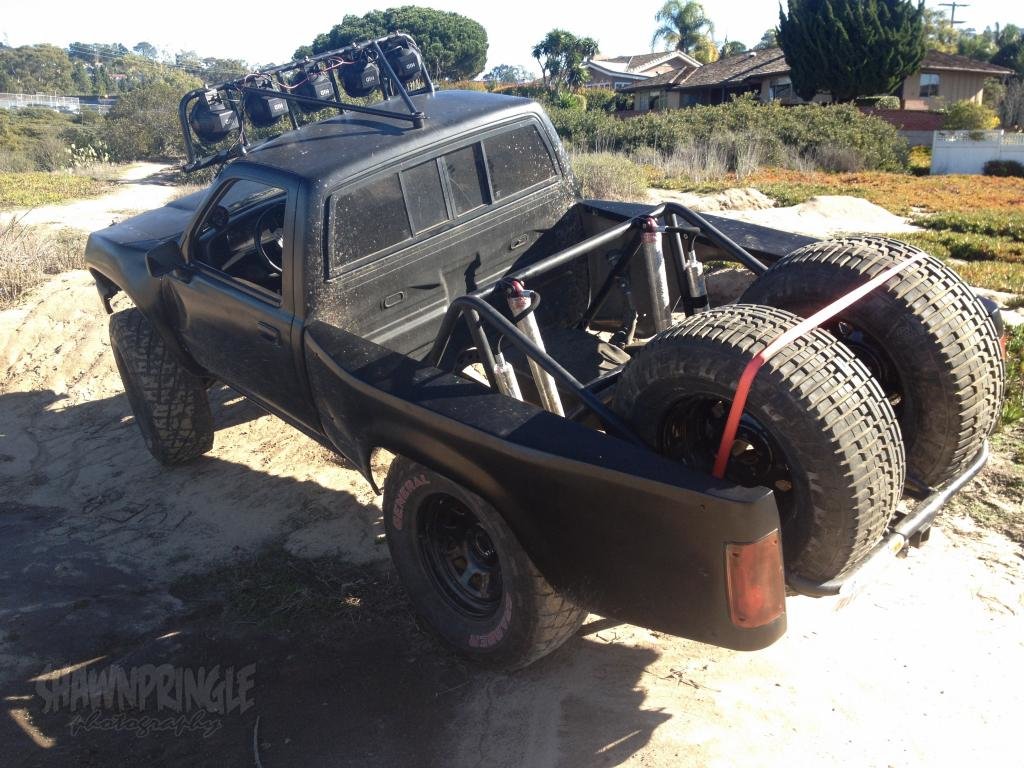

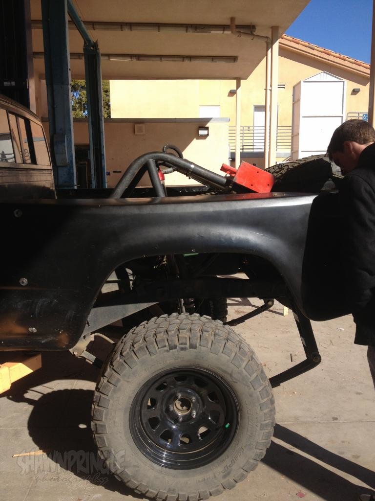

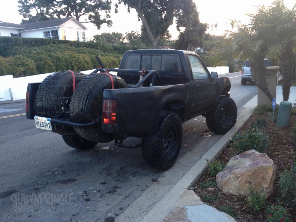

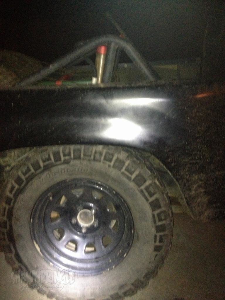

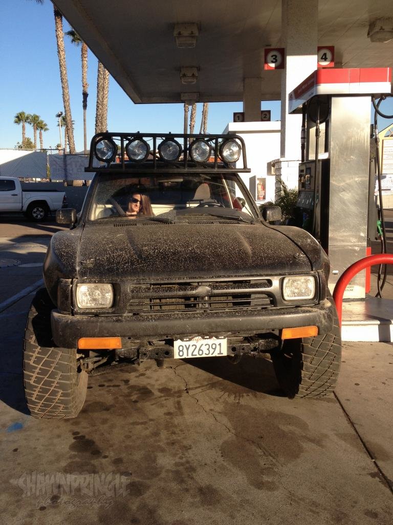

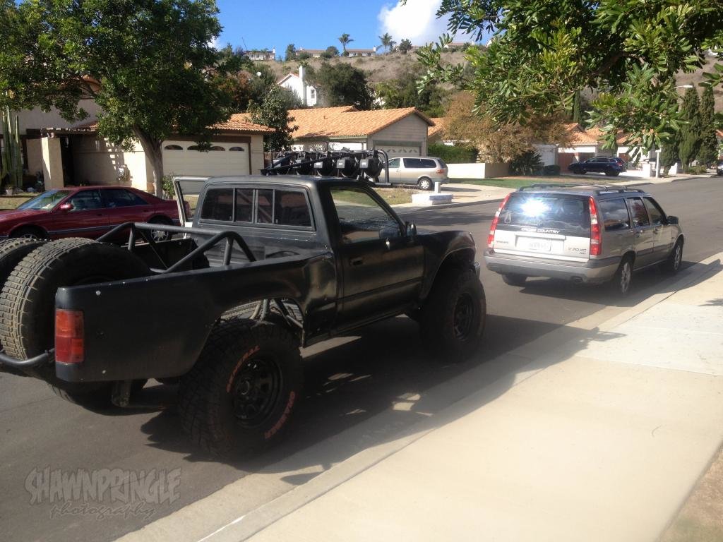

    Hey guys, figured it was time to make a build thread for my 1992 22re pickup. Heres the specs and some photos:
    6" over, long travel front end, all custom with subframe
    swayaway torsion bars
    All pro long travel rear springs
    16" race runner resi shocks
    dual fox shocks and reservoirs up front
    full tube cage in rear
    bump stops
    HID headlights

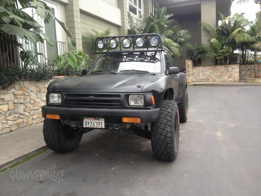

    Roof rack with HID liights (5) (now 3 on bumper)
    Hanneman 4in front fenders, flat top rear fenders, hood
    Grant Steering wheel
    CB and PA
    6 17x8 wheels (steelies)
    33" BFG Km2 mud terrains (In desperate need of a used tire to replace a baldie)
    Magnaflow exhaust
    SR5 seats (buckets soon hopefully)
    shackles, mounts, and bumper w/skid
    How she sits now
    The day i traded for her

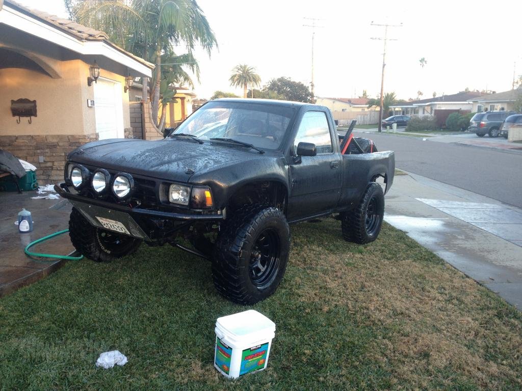

    first bath

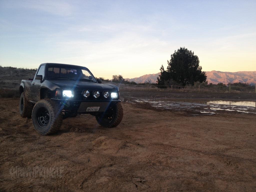

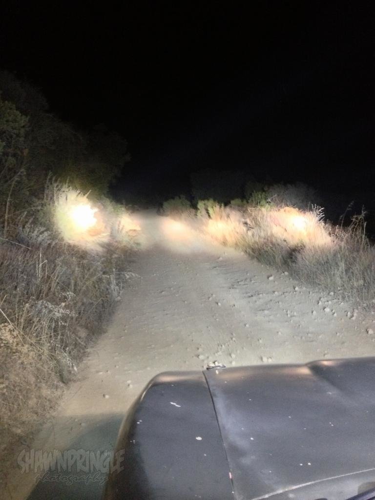

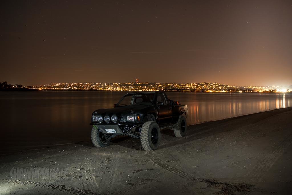

    the lights
    one of the first times at west, with anthony250f

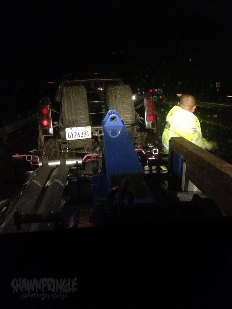

    getting towed down the mountain that night (fried maf sensor)

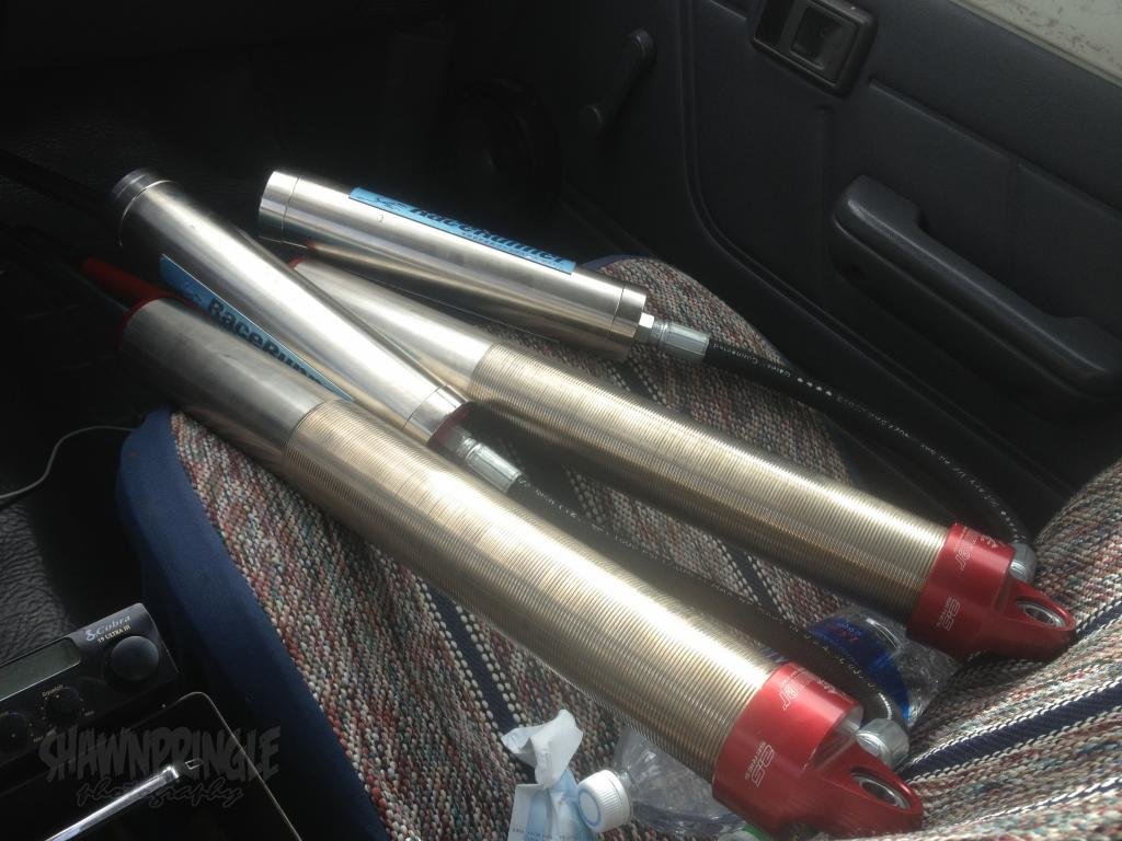

    got racerunner 16 2.5 resis for a great deal

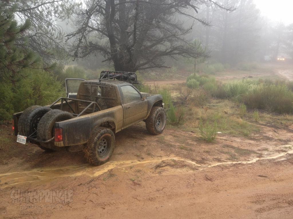

    sketchy rain at west with a few members on here, still stock rear suspension :turtleride:
    pulled valence and plasti dipped bumper

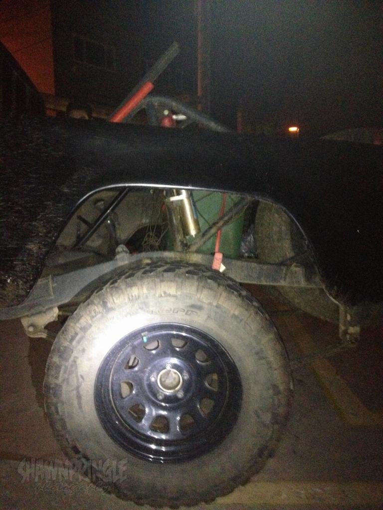

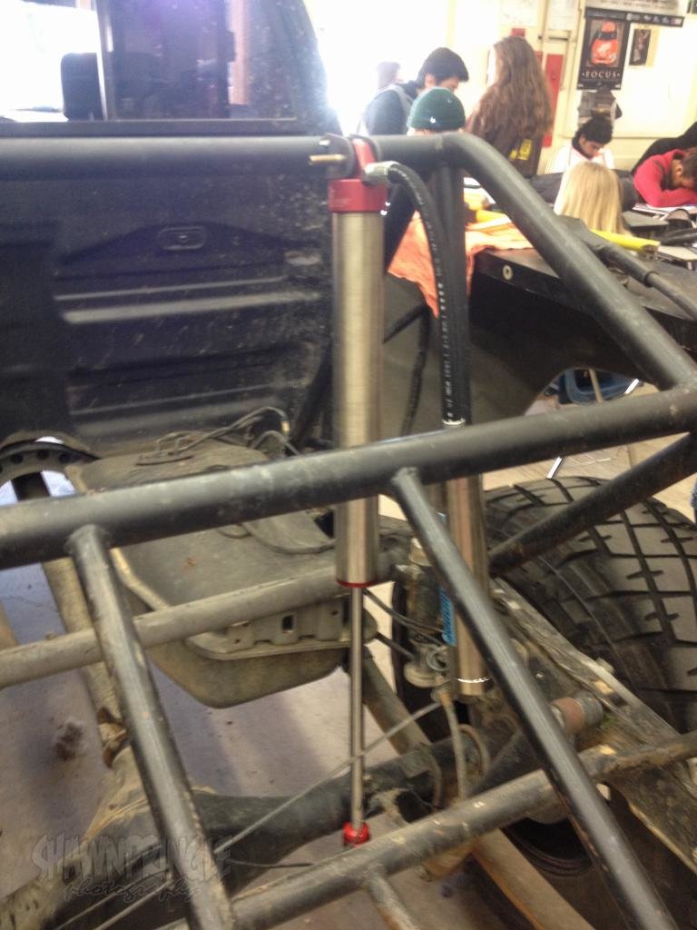

    got tired of the clapped out gas shocks in the rear so i slap these in in my autoshop class for the time being. Jason aired me up all around to correct psi and she rode like a champ.
    made worlds of difference, but still had similar droop and up travel
    some more froadin
    With the lights
    pulled light bar, got rid of stupid 35" grabbers, now running bft mt km2s
    built a bumper with zzr

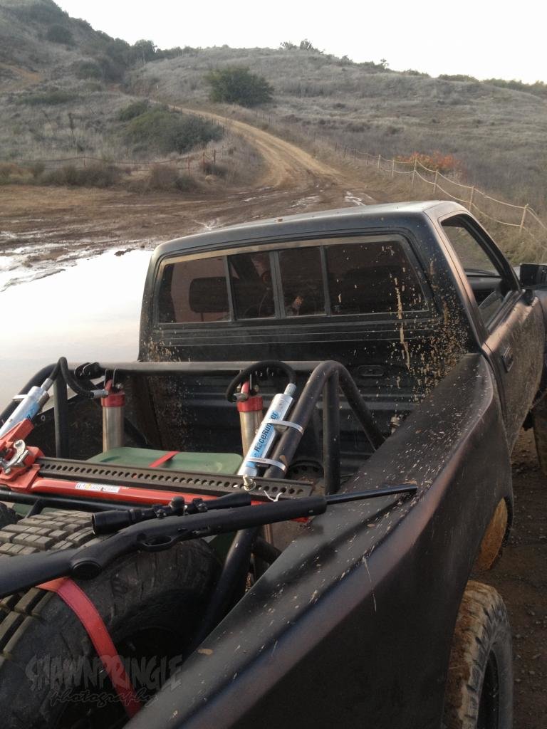

    zzr shackles and mounts, moved upper shock tabs, using full shaft now (strapped 1.5 inch short of full droop)
    shooting at west
    took it to pismo with everyone, did pretty good except for me forgetting to turn up my torsions and bottoming out on my glass a bit.
    didnt get stuck too bad either which was awesome

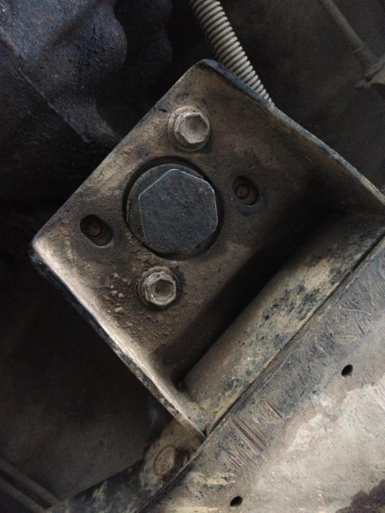

    got home to realize my transmission mount was barely hanging on haha

    opinions on roof rack vs none?
  3. Jan 25, 2013 at 7:13 PM
    BAMFTACO
    BAMFTACO Another day another beer
    Feb 3, 2010
    #30639
    10,904
    Juan
    Woodlandland hills , CA
    2007 Tacoma AC Prerunner
    Kings bruh
    Looks good both maybe daily driving keep it off and then when going offroad trip out it on

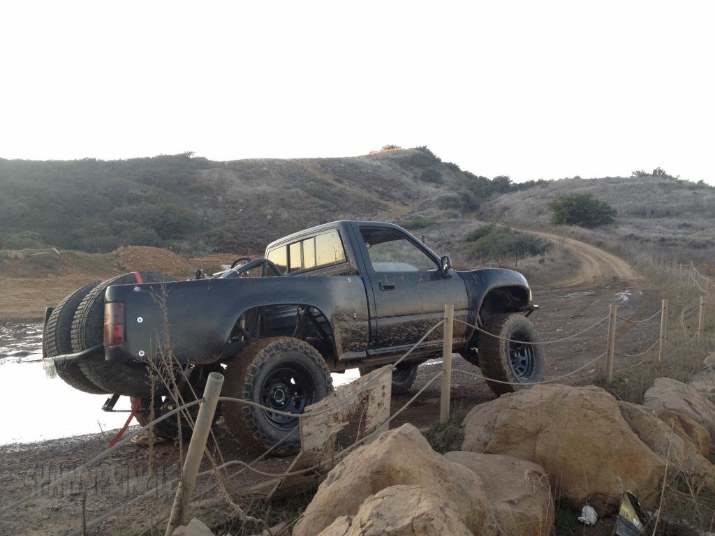

    Am I looking at these pictures right?
    Your rear suspension looks like it has a 12" shackle below the frame with stock front mounts and a stock leaf pack SUA? Please tell me I'm wrong.

    Anymore night pictures of that light rack set up's output?

    apparently you are not, yes it is indeed below the frame, the leafs are a all pro double eye pack.
    on another note, if anyone would like to donate TC shackles, mounts (front and rear), a deaver f67 pack, a slip yoke, and straps (oh hey look over a thousand dollars) to me then feel free. till then im running this set up that i built at a fraction of the cost and can hang with other lt setups...

    anyone care to explain the massive differences between putting the shackle under vs over the frame?

    Well aren't we a bit touchy! My point is all the work you paid for with doing a spring under with those long shackles under the frame is for no real gains. You're using a stock length leaf pack so you're not going to get any more travel out of it unless you're going wicked negative arch. Which, if that was the case, you're spring pack will be clapped out in no time.
    And there's a lot more to it than just shackle over or under the frame....but, in short you get more uptravel and far better ground clearance, especially on descent angles and consecutive whoops. Despite it being SUA, you could have pulled the same travel numbers with a spring over and a normal length shackle with better ground clearance. Just look at your shackles at ride height, they are at 15* max. Judging by the pictures, I'd guess by the time your leaf pack is flat, the shackle angle will maybe be at a 45* so you're loosing all that rotational and vertical movement of the shackle.

    All good, that makes a lot of sense. the truck came with the leafs and sua, but shitty (possibly stock) gas shocks. im getting much more uptravel now, but also significantly more down travel than before. actually getting so much up travel that my driveshaft was slightly rubbing on my cab at full compression before i adjusted bumps? I dont think the shackles are angled how you think they are, looking at them id say theyre closer to 45-50*
    Yes, its not an ideal set up. Yes, i could be getting more travel for a bit over a thousand dollars. However for how little i paid, im pulling significantly more travel, have a significantly more capable rear end, and am able to keep up and enjoy a ride much smoother than before. I think id be a little upset if I spent money and didn't see any gains. However, the gains i experienced going from a stock rear set up to this were exponential.
    Sure, i would love to run deavers and all that shit, however more important goals (aka school, sustaining myself) take priority over a few inches of travel in a truck that still has torsion bars. Yes, i know it will clap out these leafs much quicker than other setups, but leaf springs that i can easily re arch and rebuild for under $50 each time are a bit more viable for me.

    12" shackle over the frame is to help keep the springs flat on a leaf pack with lots of arc and to utilize the full travel. (Leafs get longer when they compress) as of now full bump youll have like 6" of negative arc lol that is not good for springs
