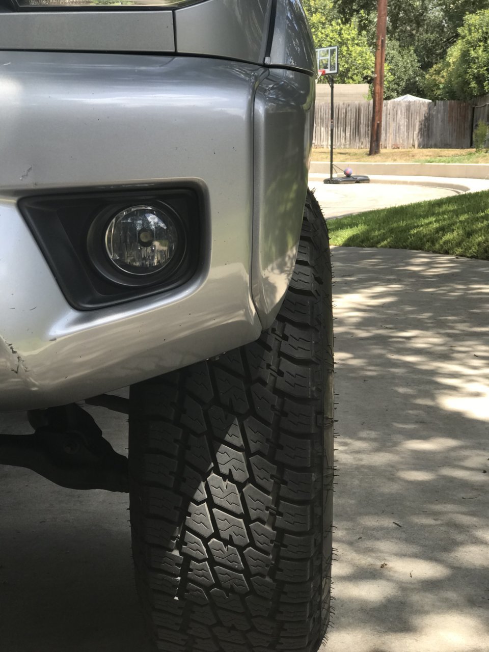

    I run a 285/70/17 on a 17x8.5 -10 offset. Here’s what that looks like. 46E5B94D-5949-485E-AA8F-393081C58308.jpg

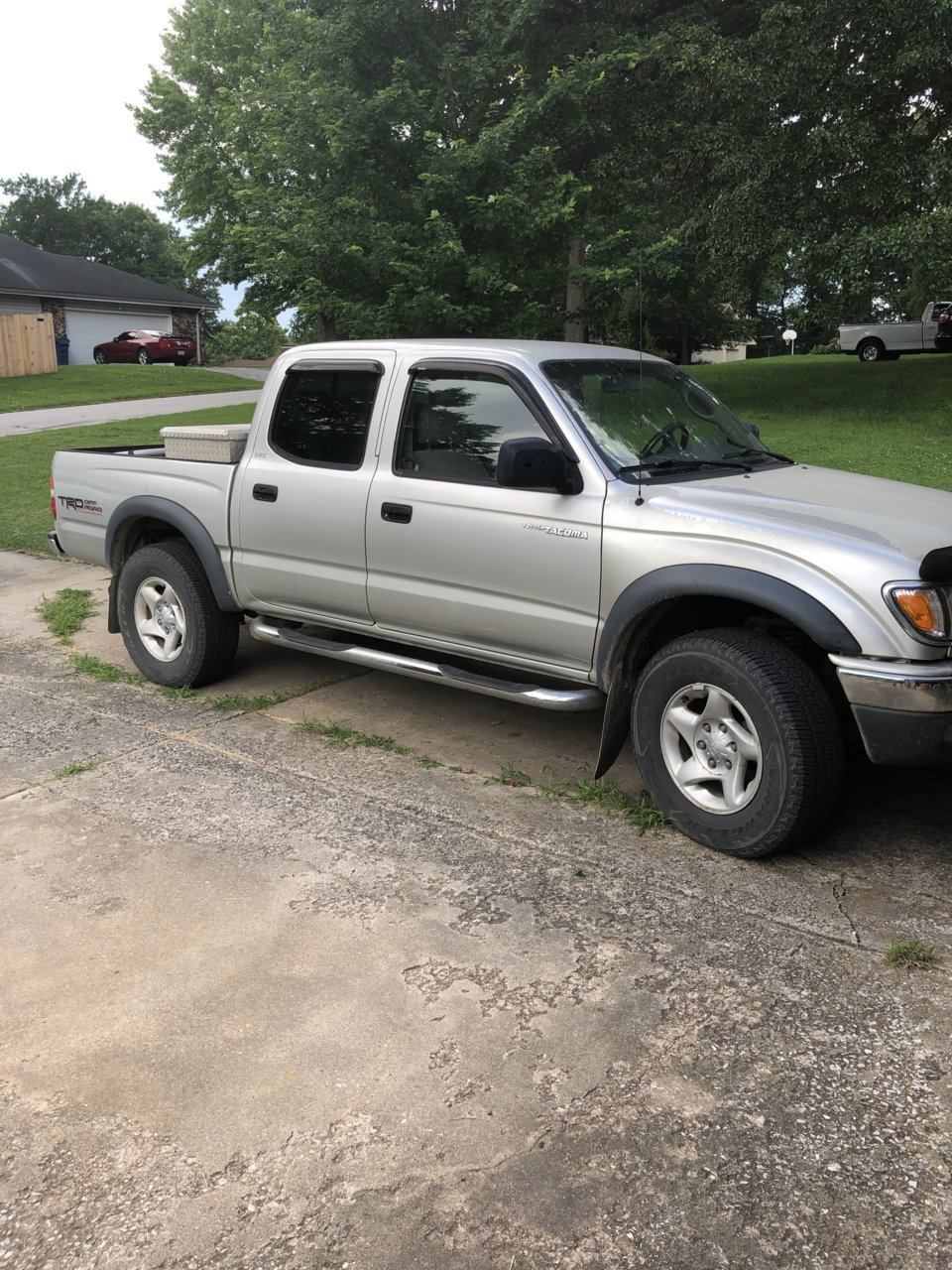

    First confirm you have factory wheels. Toyota wasn’t known for putting a 8” wheel on from the factory. Most of the factory wheels are 7” and have positive offset. Post a pic of the wheels you have on currently.

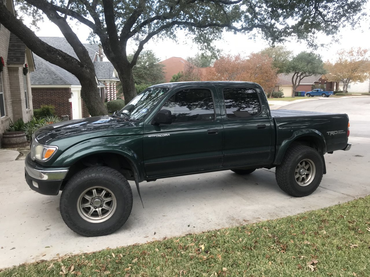

    My first gen on 33s 8” wheel 0 offsetEF4C1BE9-5C02-47BC-BCBE-A408A764A986.jpg

    This is it. Stock wheels.

    Thank you for the photo. Can you tell me why the tire and wheel looks so different in the wheel well? Do you have a higher lift? My visual spatial awareness is awful but it looks like way more open area in your wheel well. Maybe the image I put up has 35 inch tires? Would that change the look?

    Those should be either 15x7 or 16x7 +15 offset.

    The truck you posted appears to have a lift had does my first gen. You truck looks completely stock and I assume your planning on keeping it that way?

    I would like to put a lift on it but have not settled on one yet and it will be a bit down the road I think. Says the rims are 6.5jx16 ET30. Does that mean they are 6.5 inch wide? I know they are 16s. Man I wish discount tire would have been open for me to talk to the yesterday. This is confusing.

    Correct according that the wheel 16x6.5 +30 offset. Giving it a 4.5” backspace. So a 8” wheel 0 offset should put the tire approximately 3/4” further out than what you currently have since it also has 4.5” backspace. Yes it can be confusing if you don’t fully understand offset and backspacing of wheels.
