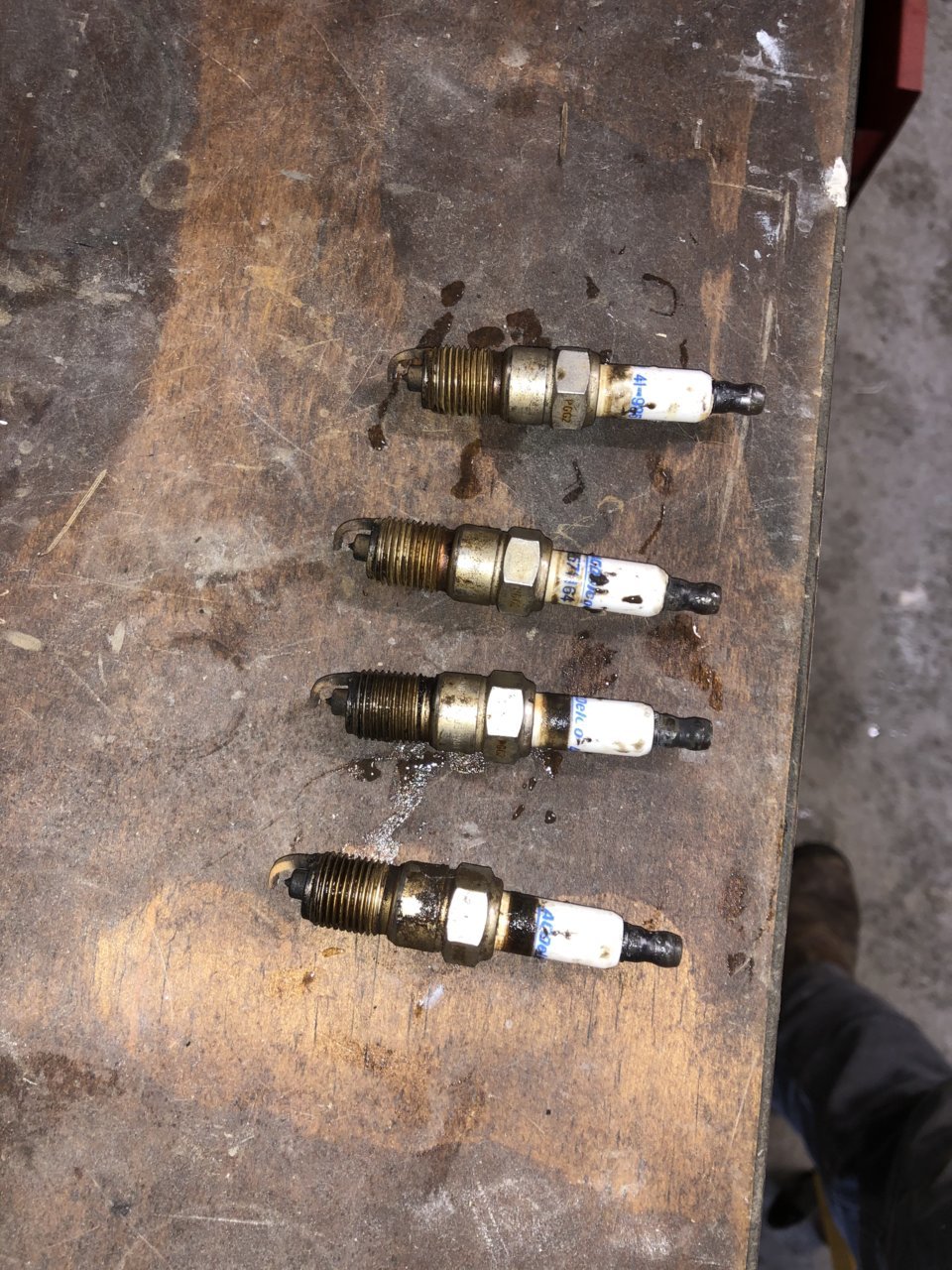

    I bought the truck when I was 17 years old and have slowly been making it my own. In high school a swapped a new 305 in it with a edelbrock high rise intake and carb. It sat for a while and is burning oil and fouling out plugs so I’m giving her some new life.

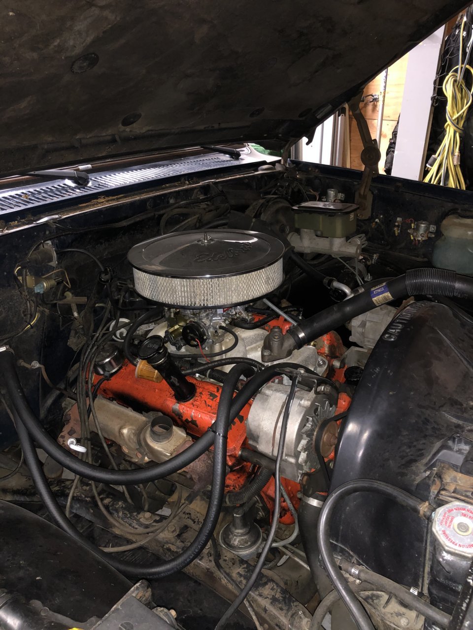

    Existing 305 in the 84
    Good boat anchor

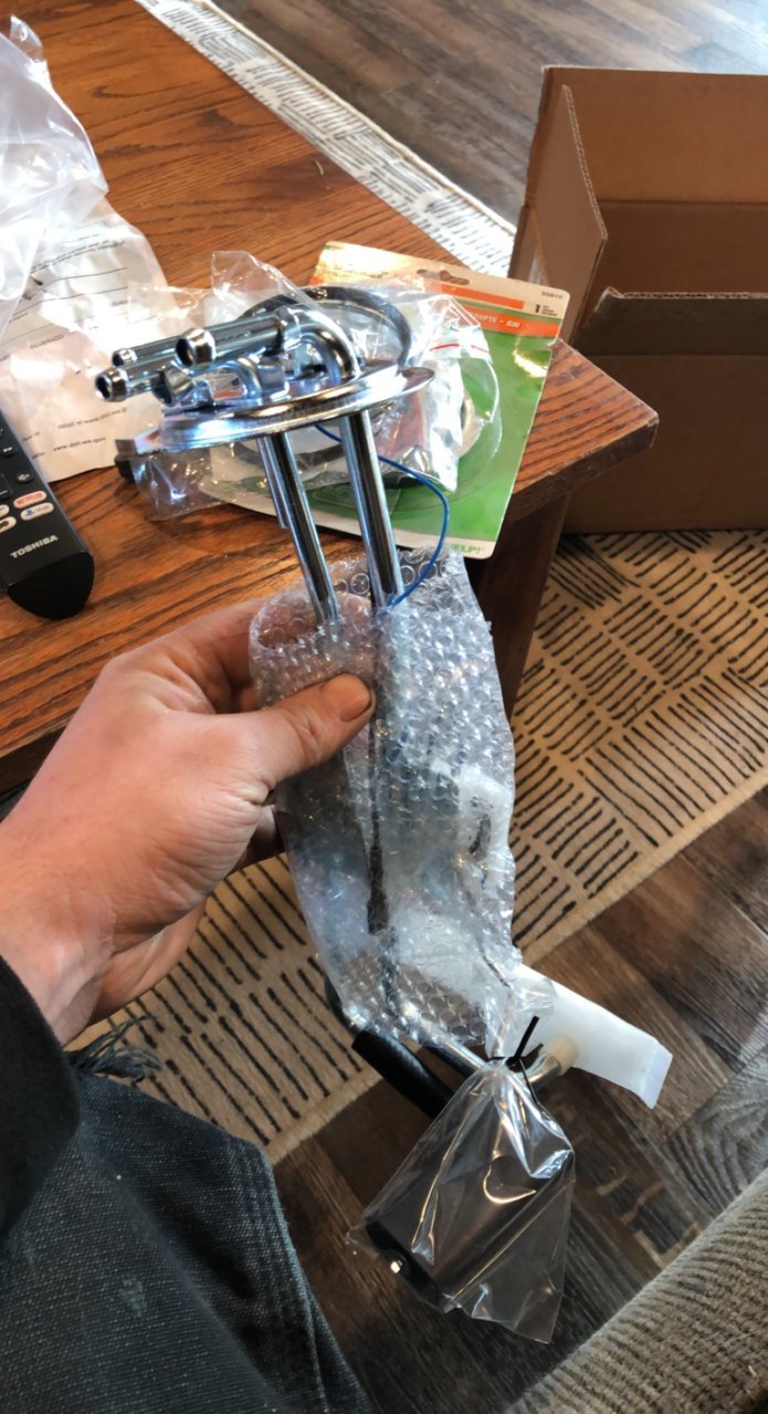

    Got some tanks out of a 87 a while back. In 87 the trucks came factory with throttle body injection so the tanks came with built in baffles. Today I ordered up a new sending unit and orings to get going on the fuel delivery system. Just need to order up the fuel pump and fuel lines to support the 58 psi or so the modern motors need.

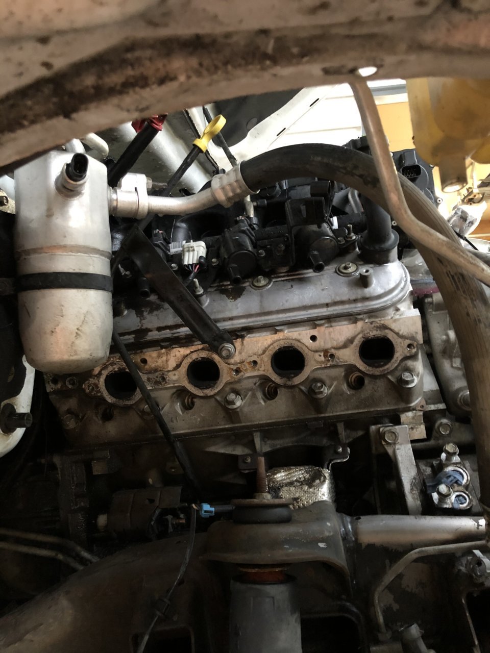

    More work on the L33. Tested positive for the Kung Flu so haven’t been moving to fast this weekend.

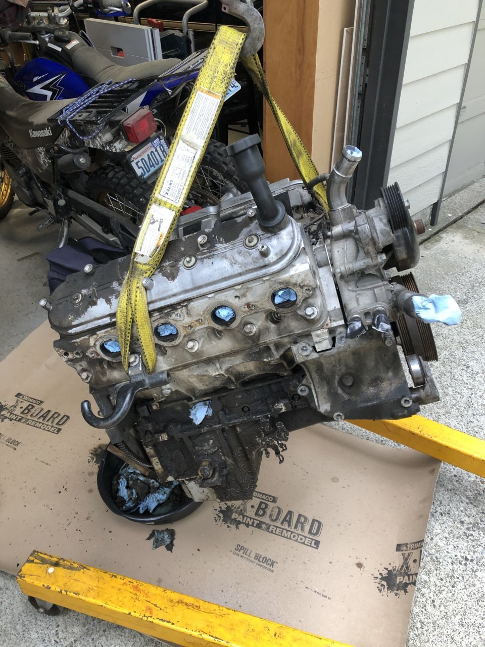

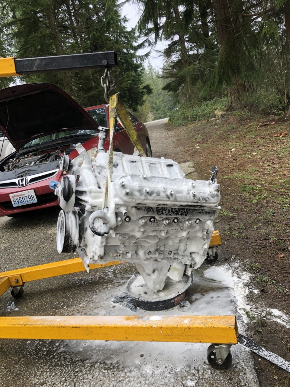

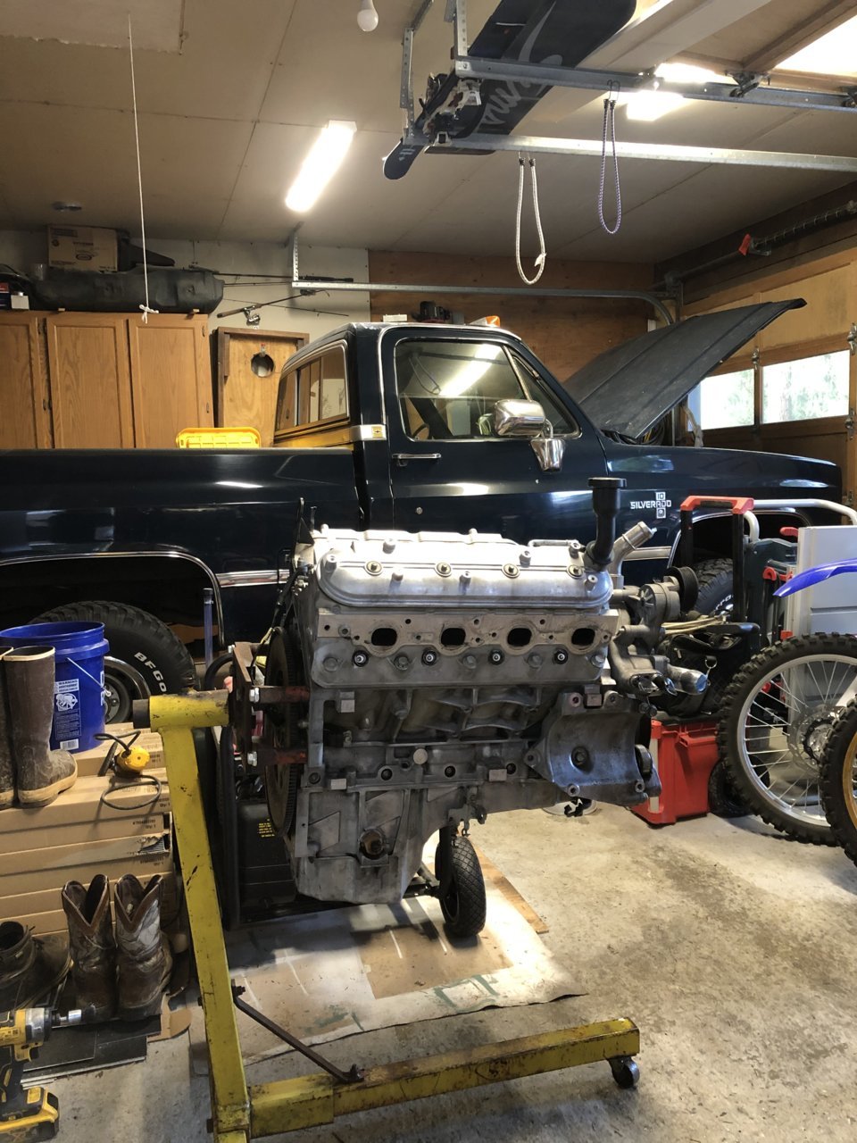

    Motor is out and getting a bath. Covid sucks ass.

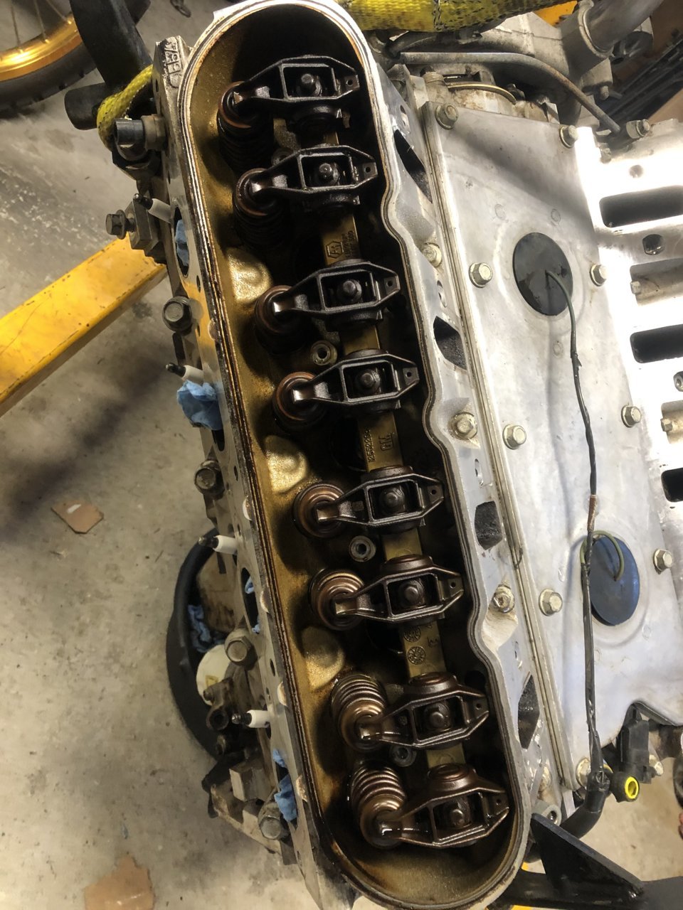

    Need some wire brushes from town and some bolts to get it on the engine stand and she will be all cleaned up. Top end looks pretty good.

    Motors all cleaned up and ready for some hp upgrades. The truck actually came stock with the 799 casting heads which are the same as the 243 cast heads that came on the LS6 C5 Corvettes. Should make good power!

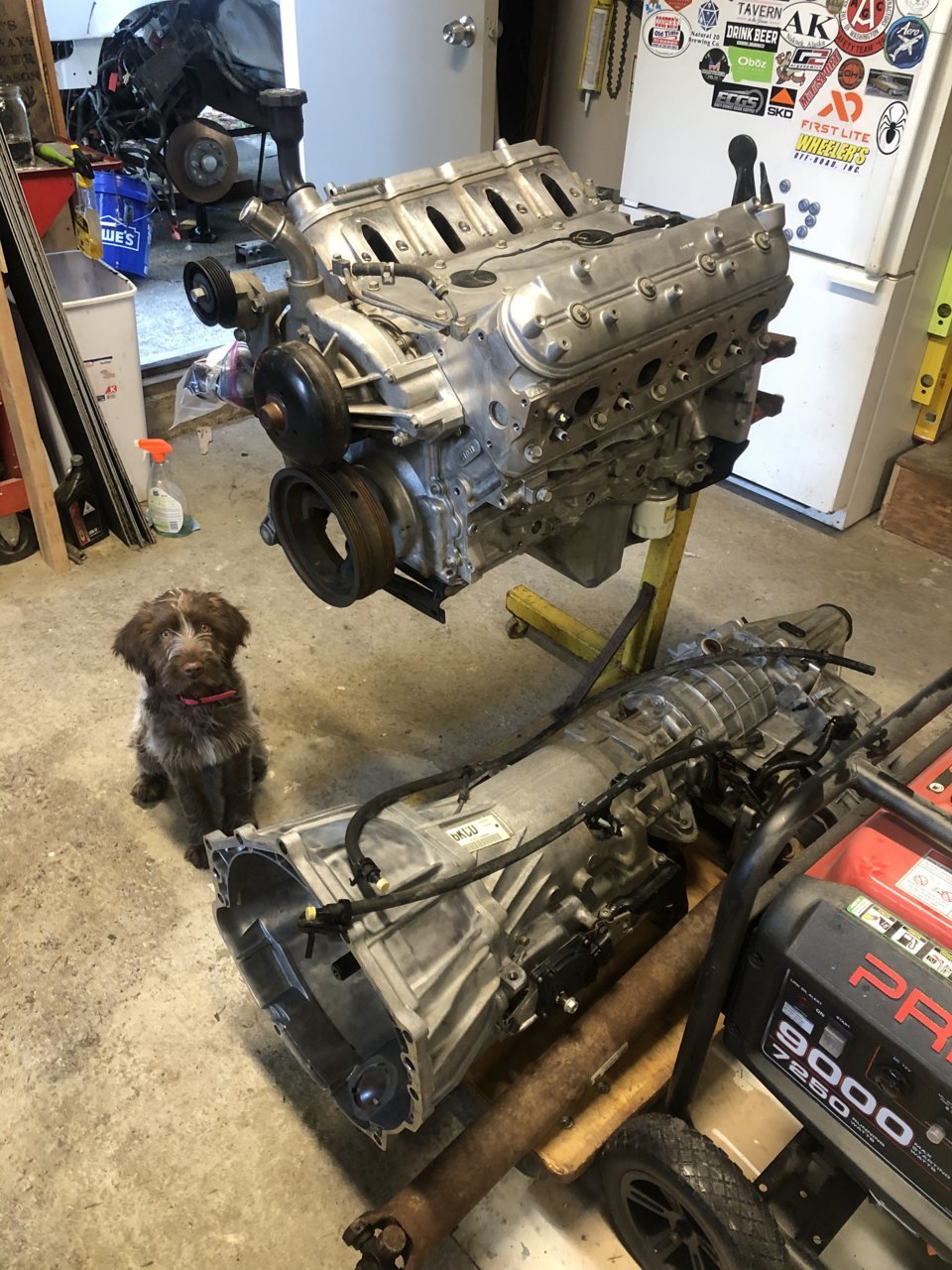

    4l60e is out. She’s dirty and needs a little love. Hopping to do a corvette servo and a fluid/filter change and it will be ready to go.
    First part showed up today!

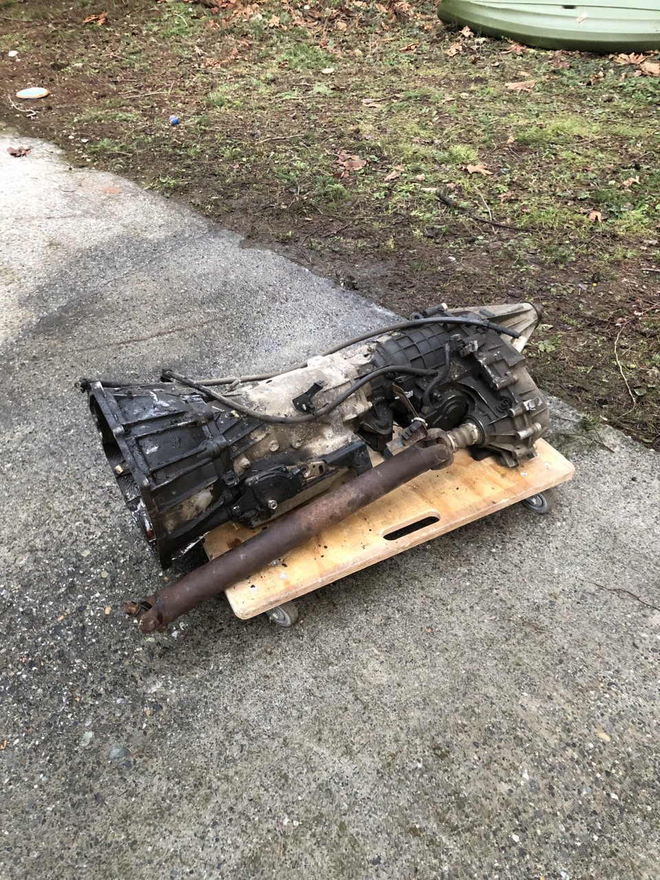

    Got the trans all cleaned up today

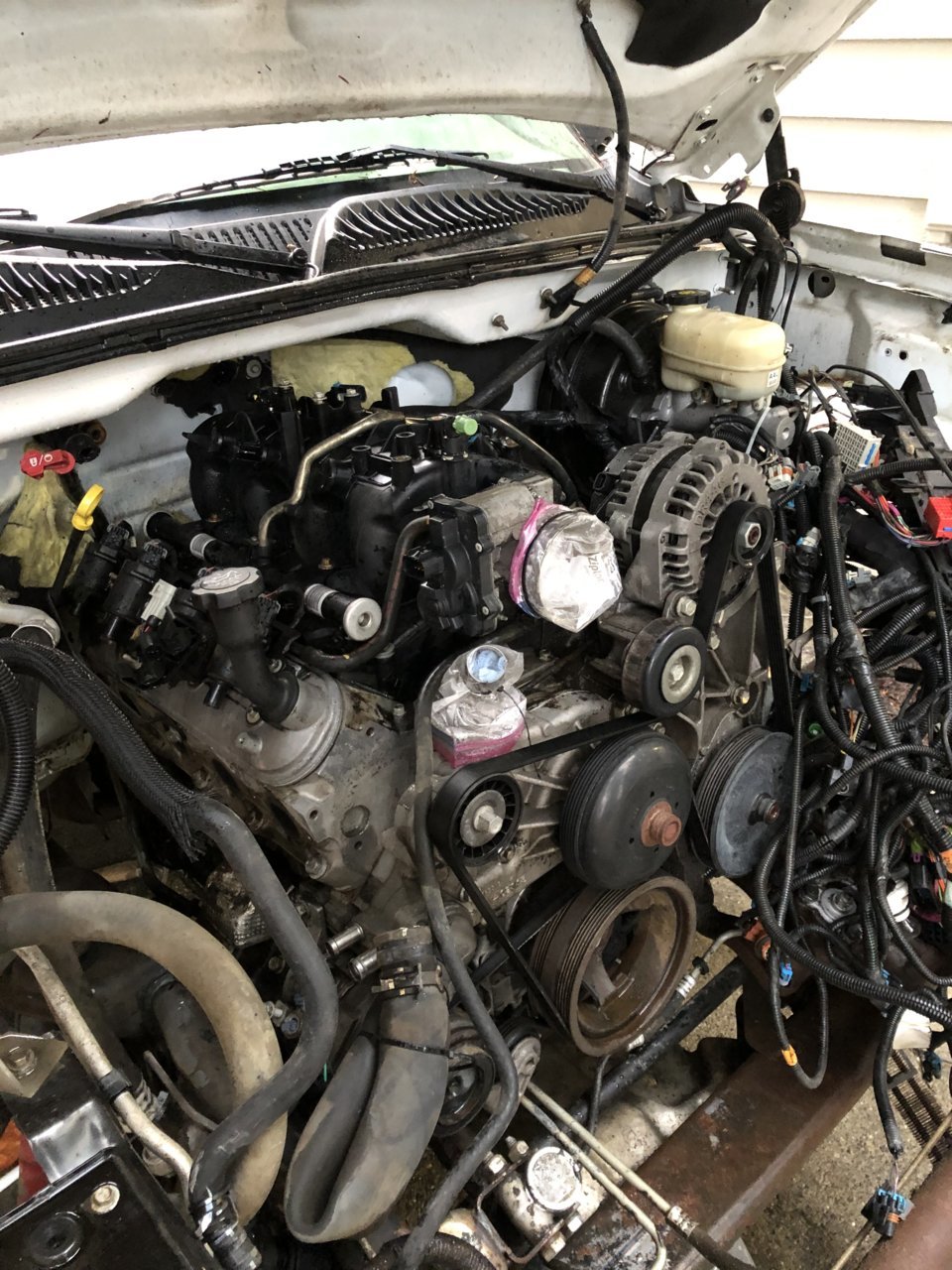

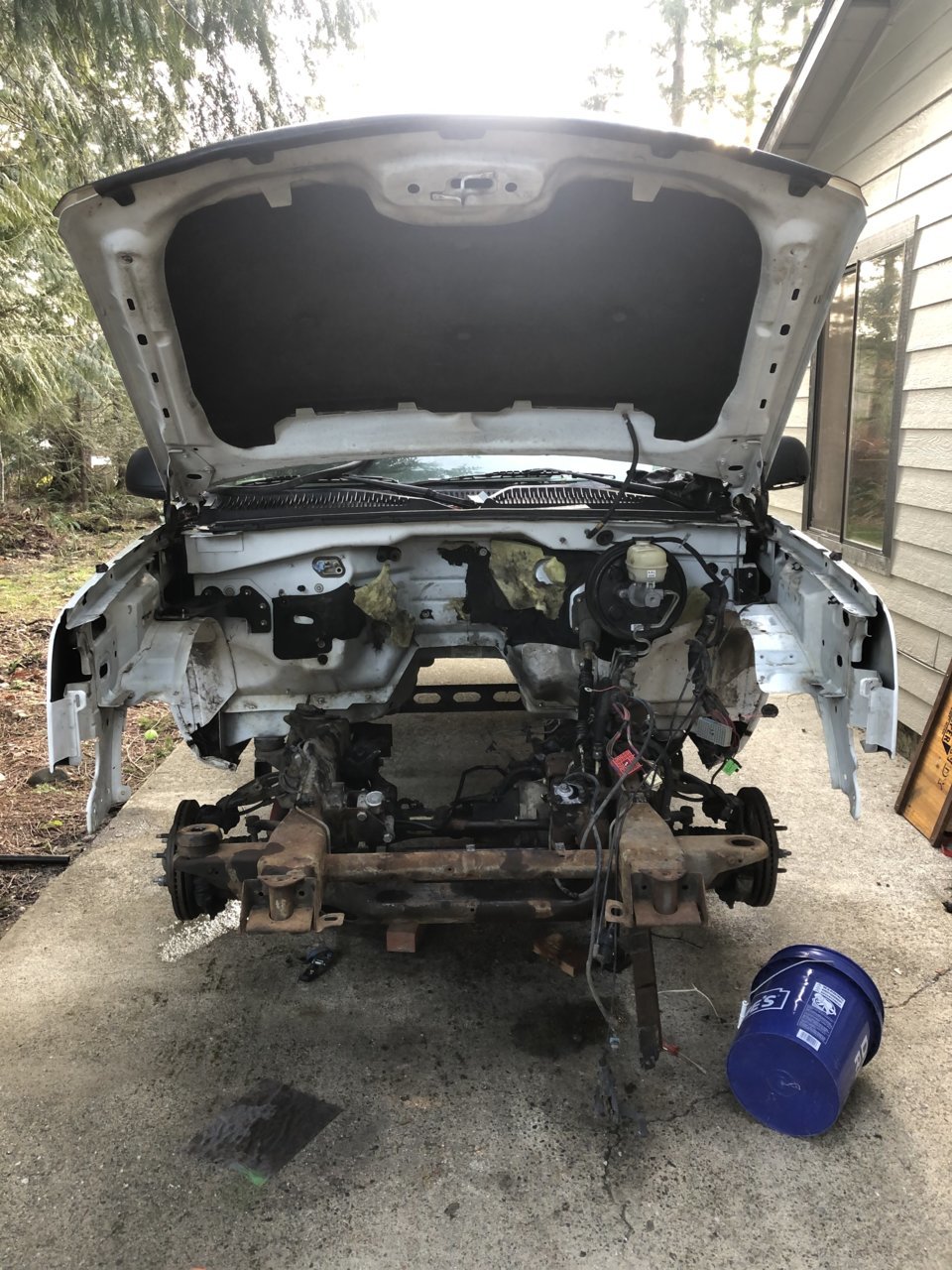

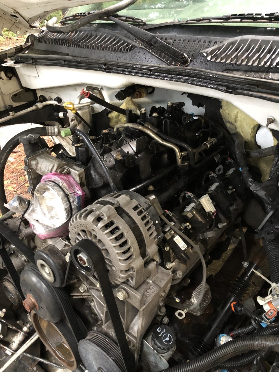

    Donor truck is looking pretty empty. About to hit the scrap yard.

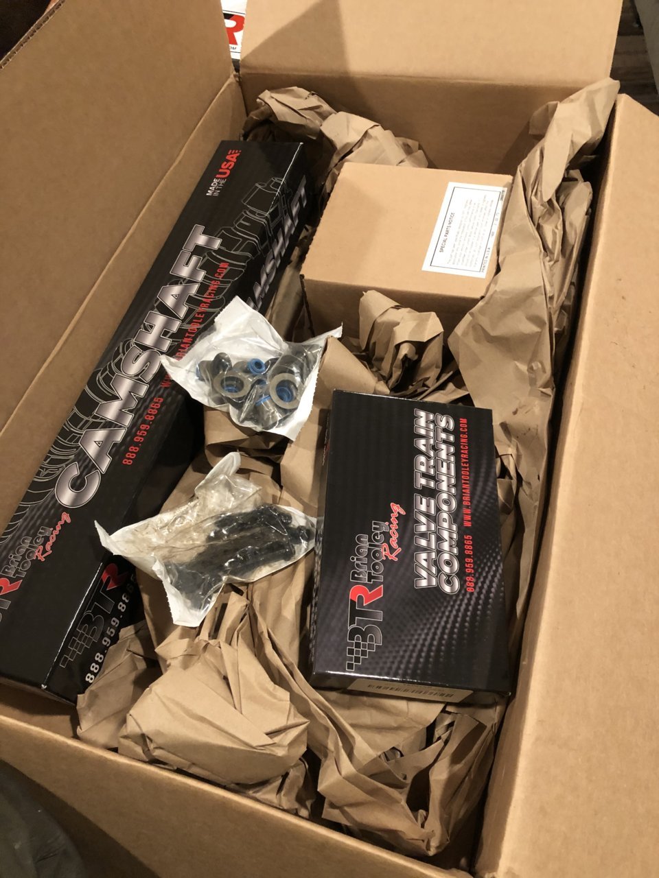

    Dropped the motor off for a rebuild and ordered up a BTR Stage 1 truck cam and trunnion upgrade. Hopefully parts will start stacking up.

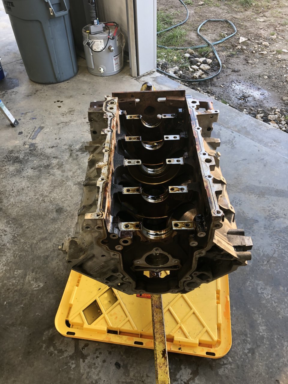

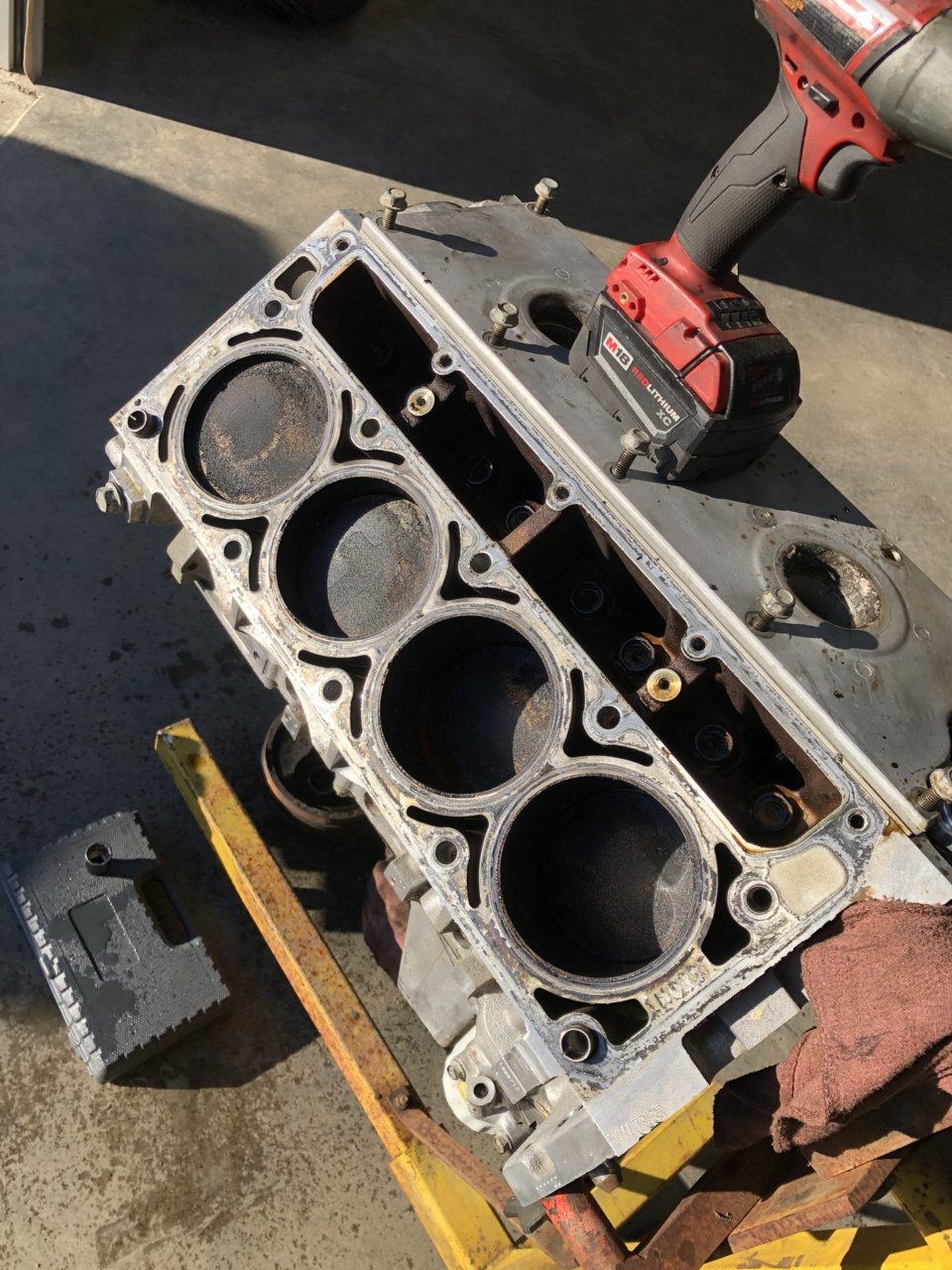

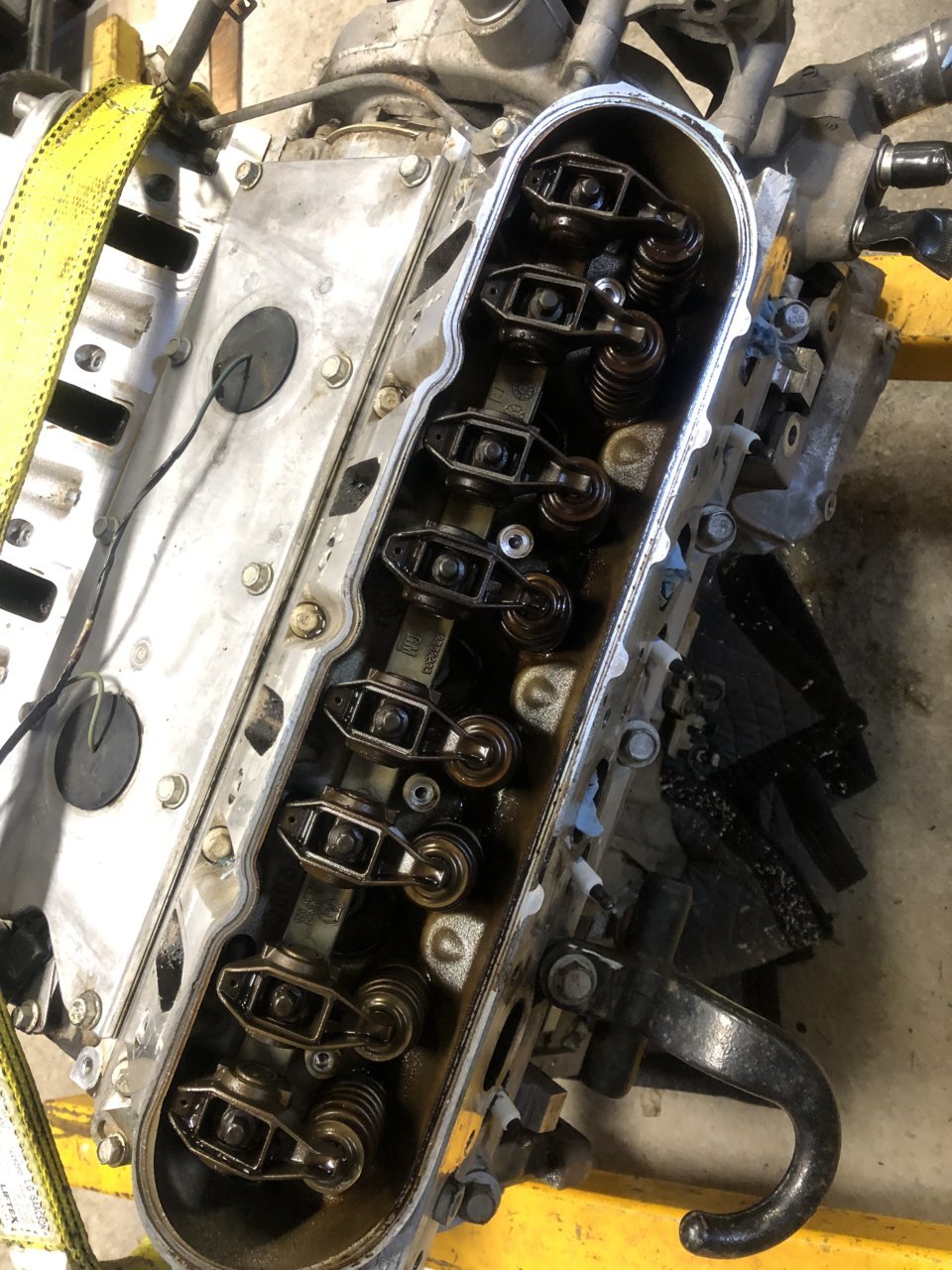

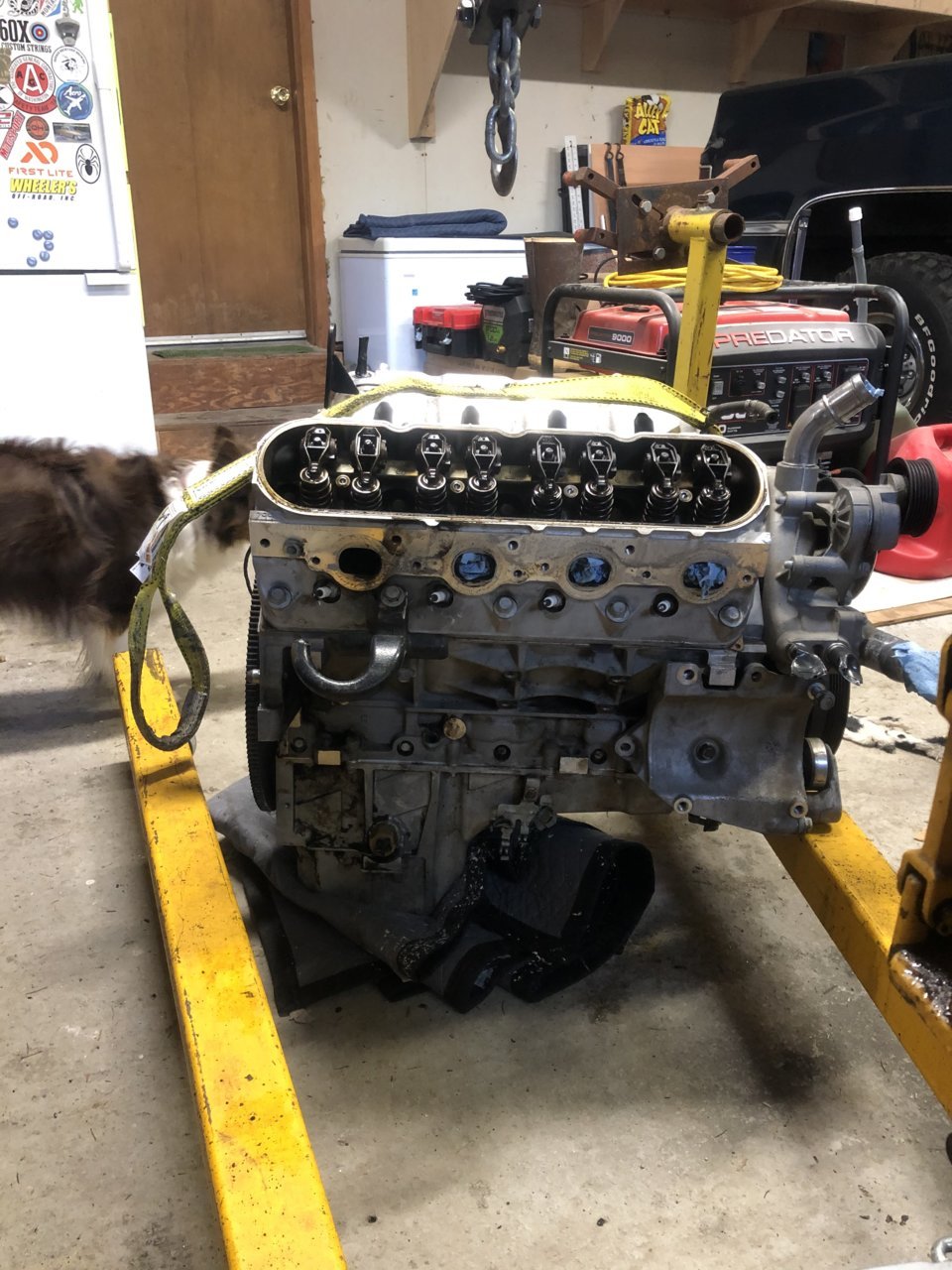

    The motor is ready for the machine shop! Crank bearings looked good still but the cam bearings were about to go. Not bad for 250,000. Aluminum Block is about 70-80 pounds I’d guess. Easy to move around.
