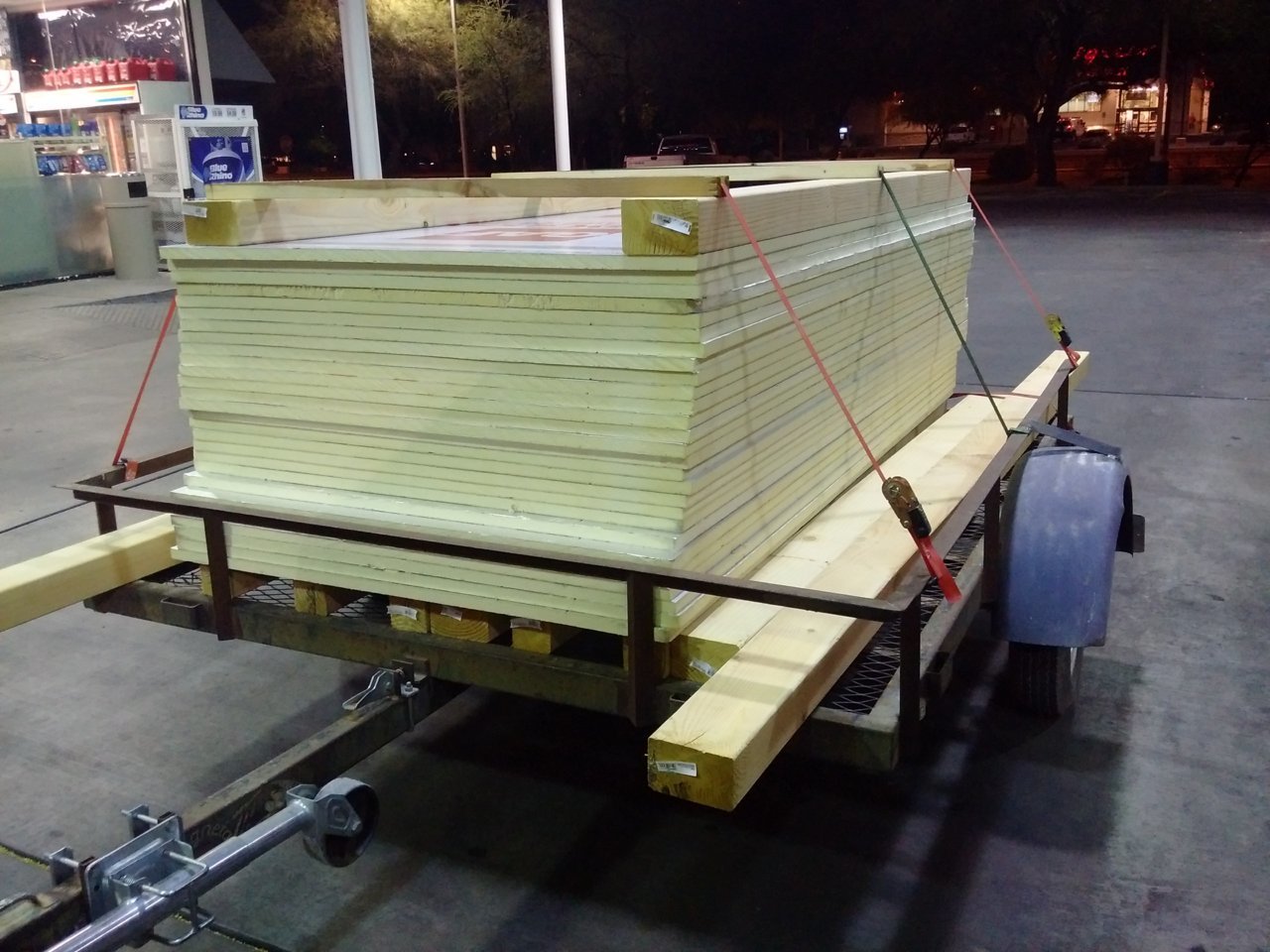

    Figured I would add this while I'm at it in case you've ever wondered what $540 in polyiso rigid foam board insulation looks like. I'm going to end with with R12 walls and floor with R15 in the roof and I calculated weights while I was at it, replacing the OSB walls and flooring with aluminum is a dead wash weight wise after I factor in the insulation and the fact that I'll be doing the ceiling in aluminum as well. If I'm comparing apples to apples it would be 600 with the OSB and 400 with the Aluminum which is a fairly huge savings. That said since I'm not hauling cars and such I'm going with thinner aluminum so there would be no actual weight savings if hauling toys or cars were required.
    I did manage to find a dude to sell me a $500 Lowes card for $320 and I used a 10% off coupon so I'm pinching pennies on this one without compromising.
    Oh and the lumber is for a deck I'm building, nothing to do with the trailer.
