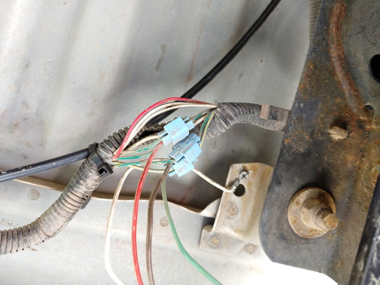

    I'm installing a 7-way trailer wiring harness (ACDelco TC177 Professional Inline to Trailer Wiring Harness Connector) on my stock 2001 Toyota Tacoma SR5. I only need power, ground and clearance lights for my old camper. But I figured I would install the whole 7-wire kit in case I ever need the other connections.
    I've found all the connections I need on my truck except for the power wire. I'm wondering if I need to run a wire from the engine compartment to the back of the truck. Or maybe I'm just not seeing the power wire. I'm attaching a few pictures of the existing wiring, most of which was installed by U-Haul when I had trailer lights installed.
    I'm sure I've left out a few vital bits of information, so please ask for more information as needed. And thanks in advance for your time.

    01 likely had the regular 4 setup, no power wire. You'll want to run from the battery.

    If it's not a factory trailer setup it won't have a power wire. Run a #8 (good for 30 amps) and fuse it at the battery end.

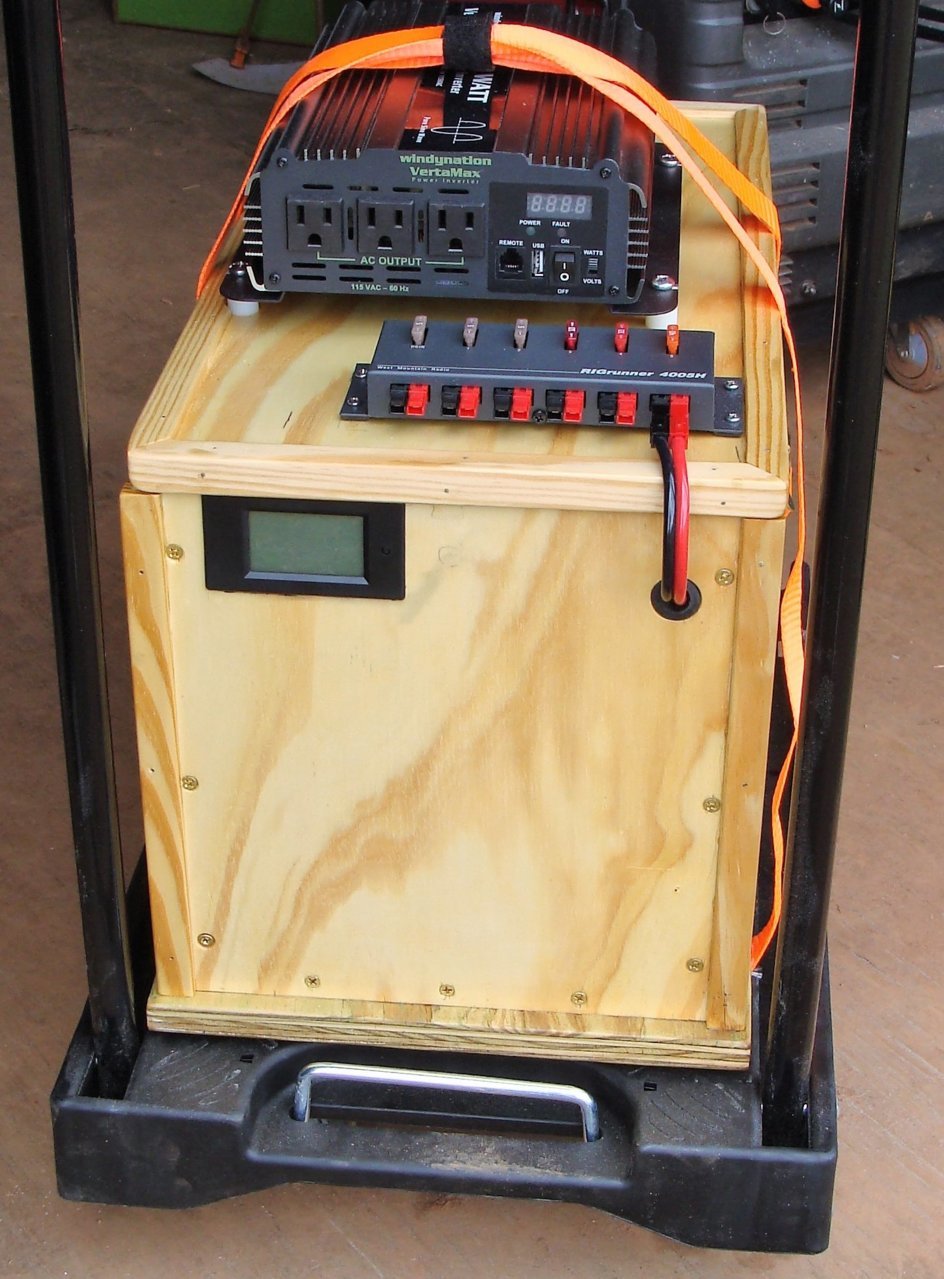

    It's a small cargo trailer and I only use the lights for a couple of hours. I have enough battery power in my portable supply to crank a semi, and if all else fails, I have my NOCO Genius jump starter. It's just easier to run the couple of LED trailer lights off the truck. The portable supply runs my telescopes and cameras, it's a 100 amp-hr deep cycle battery.DSC00582.jpg
