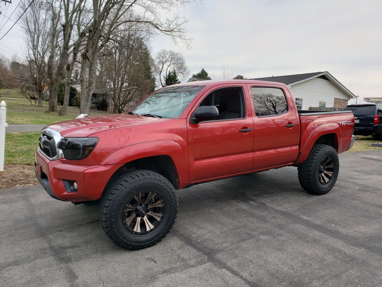

    Wondering if there were any 6 speed automatic transmissions put in the 2015. All that I have seen so far says no but I have been leaving it in 4 when around town. Recently put 285 70 17s on and was on the hwy in drive. Noticed when coming to a hill it would drop and go from 2grand to 2.5grand. I put it back in 4 and I climbed close to 2.9. In drive it seems to have 2 gears. Looking for answers. Thank you in advance. 20210310_165018.jpg

    Those tires are about 7% taller than what came on the truck. Everything is about 7% different than what the computer is expecting. In effect your factory 3.73 gears are now about 3.49 gears. When your speedometer says you're at 70, you're actually at about 75 mph. When your odometer says you drove 200 miles, you actually drove 214 miles. That engine develops max torque at around 3600 rpm. The lift is causing the truck to catch more air.
    All of that combined means your engine is working harder and needs to keep the rpm's up in order to have enough power. Dropping to lower gears, or unlocking the torque converter keeps engine speed up. And since you're driving faster than you think you are that only makes things worse. Re gearing to about 4.10 would get you back closer to factory specs if you run that size tire.
    A manual is no advantage. Yes you can select the proper gear to match conditions better than the automatic transmission will. But there is no law that says you can't also select the best gear manually with an automatic. You're already doing that around town. You're going to have to anticipate that the engine is going to struggle getting up inclines in overdrive and manually downshift to 4th gear BEFORE the engine starts to struggle. Exactly the same as you would if you had a manual. Shift back to OD when you level out or start down.
