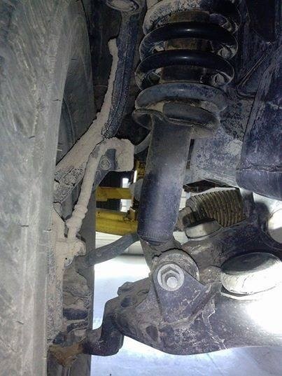

    I have a 2009 QC 4x4 6" stage 1 pro-comp lift with 35". I purchased the truck with the set-up already last year. I could tell he'd been off-roading. Is this set up any good for trail riding? and so fourth? I'm looking to maybe one day do the MOAB or something like that. I'm more into trails, not crazy rock crawls. WHat are your opinions?

    I personally think the Pro comp 6 inch kit is crap. But if i were you i would get rid of those spacers ASAP. Look into icons or kings for replacement shocks.

    This is what happens when you put spacers on it and think you've gained anything more than a high center of gravity.
    You'd probably be best with a good mid travel setup. Save a couple thousand and do it right. I've got 2.5 kings all around with a Deaver eleven leaf pack and she rides like a caddy over stuff you'd buck and total your brodozer on

    Look into getting the Stage 2 coil overs (Loss the Spacers) and looking to getting some leafs (Loss the blocks).
    I can tell you from my experience that I have been able to go everywhere someone with a shorter lift has. I personally love mine.
    Some people may not like it for the look or perceived thought that it won't make it. But there are plenty of us with this lift that do wheel on a regular basis with no problems.
