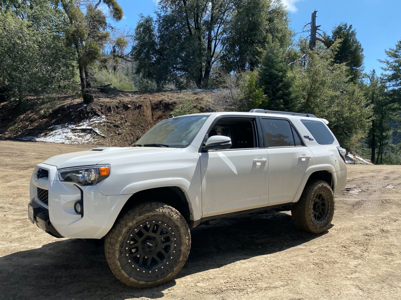

    I have a question regarding the OEM roof rack system on 5th Gens and weight limits. I purchased a Tepui 2 person low pro tent and want to install over the weekend but no sure if possible.
    Is it possible to mount my roof top tent to the OEM cross bars? The tent itself weighs about 85 LBS and the factory system states MAX LOAD 132 LBS. Now I have read about dynamic and static weights and by my calculations this should work no problem. Does anyone know if Toyota states if this is a dynamic or static rating anywhere? I looked in the manual and online and I have not been able to find a definitive answer.
    Has anyone loaded one onto their OEM bars successfully?
