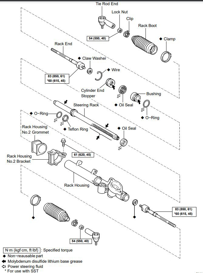

    I can't seem to find the torque spec for the inner tie rod to the rack. Is there one?
    99 5 lug
    Anyone have an any idea?

    I've never torqued it, I usually use blue loctite and as tight as I can get with the tie rod tool or plumbers wrench.
    Edit 61 and 45ftlbs with the proper sst.

    Why are there 2 numbers?

    Aaah, gotcha! Still dont understand the 2 different torque numbers. Why would the sst have a different spec?

    Maybe I'll average it, go somewhere in the middle. It wasnt super tight so 53 ft lbs sounds good to me?!

    They reduce the number for the Toytoa SST which is direct, and the indirect torque is for an adapter.
    I would want tighter honestly, but I've never seen one loosen off.
    Locktite for sure, likely the old one had it. Domestics use locking tabs, toyota relies on the threads.

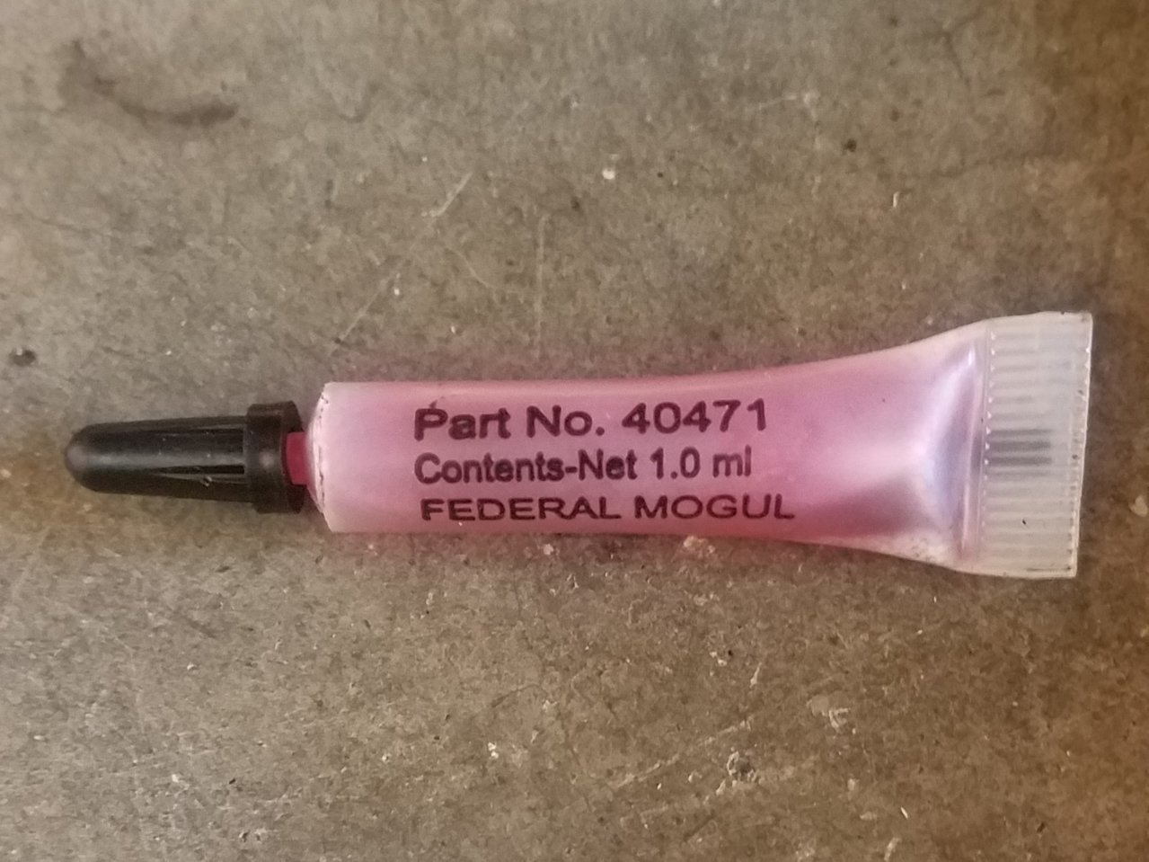

    Thanks! These actually have the washer with the little locking tabs you have to bend to lock in place. These are the original TR and I didnt see any loctite on the threads, they were nice and clean. I dont plan on ever doing this again so I'm sure loctite is fine even if not required. Thanks for the help, I appreciate it!

    Also, moog sent a little tube of what google tells me is loctite so I'll stop yapping and get back to work now!
    Has Federal Mogul Part No. 40471 on the tube.
