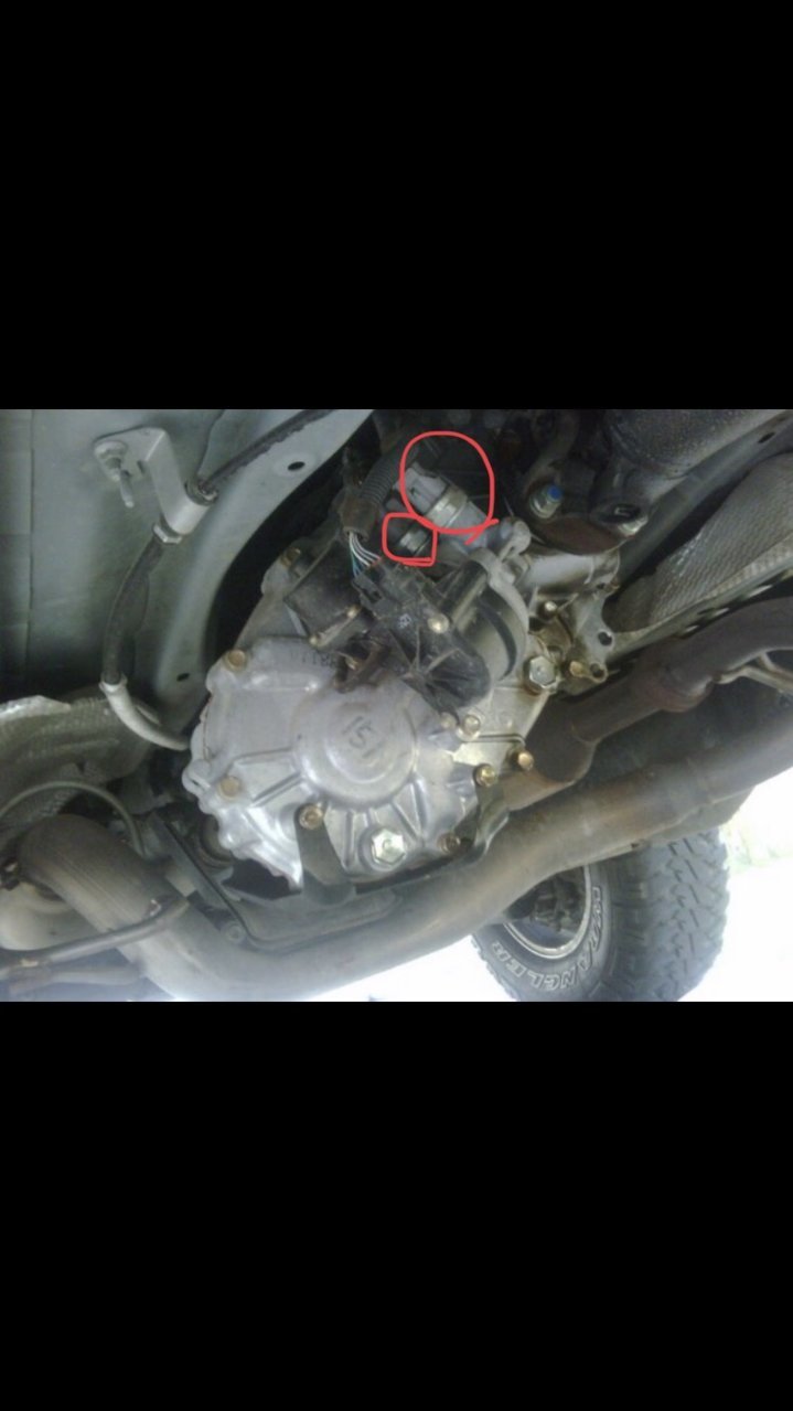

    Did troubleshooting yesterday
    I just plugged in another front diff actuator & I saw the fork moving & engaging just fine. We also confirmed that the t case actuator works because we hear it moving
    Also tried a different ECM & still no luck
    And I bent the 3 little prongs up to make better contact
    Next guess would be these 2 sensors here on the t-case actuator
    PFA **

    Replaced the sensors today & nothing
    Still same issues. Truck will not engage into 4x4 fully & the light will constantly be blinking
