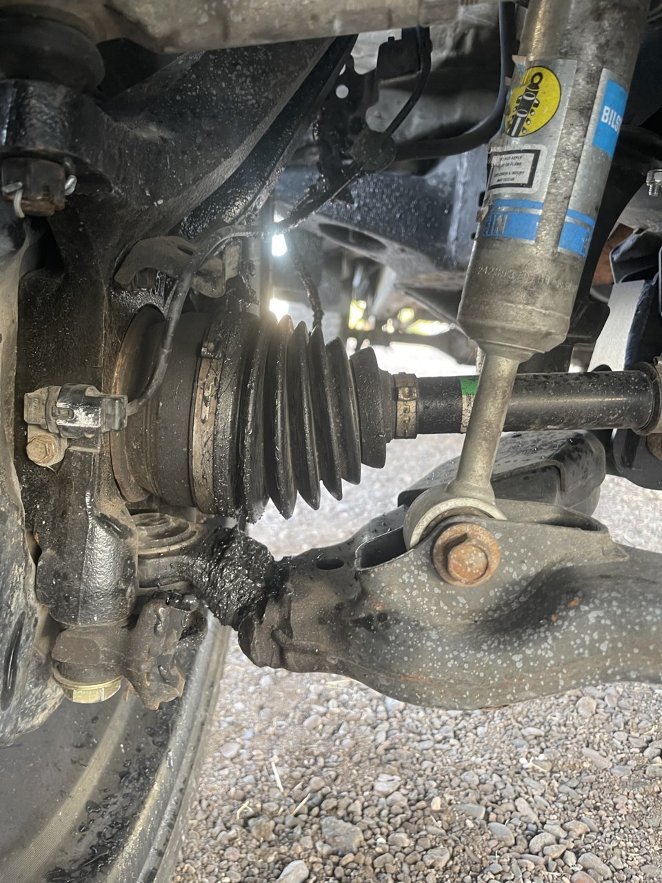

    Hey all,
    last night I was leaving a family gathering and I took a right out of the neighborhood going about 10-15 miles per hour. I heard a loud almost crack type of sound come from the right wheel well.
    I got out to take a look and visually nothing seemed wrong, but I did notice that it appears that the CV axle bolt somehow had a small tear in it and that flung grease everywhere. Besides that everything visually seemed fine.
    I got back in the truck and I noticed that 4WD had engaged on its own and the VSC OFF light turned on. The truck refuses to switch to 2WD or 4WD low.
    Anyone have any idea what could have broke?

    A torn boot isn’t the end of the world.
    I’d focus on getting the truck out of 4WD.
    It engaged 4WD on its own?
    The switch was in 2WD and somehow the truck went into 4WD?
    That’s unusual, you might get lucky by w
    Switching to 4WD then back to 2WD. Then turn the truck OFF.
    This won’t fix what caused the problem. But if you are luck get you back into 2WD.
    You really need to see where the problem is
    Start here with check the 4WD ECU in 2WD.

    That might work. But if the truck is being commander to be in 4WD, it will just go back into 4WD.
    A temporary fix would be to do as you said, then leave the actuator unplugged. This would be my “get me home” temporary fix.

    It was actually just me in the truck, I didn’t do anything besides put the truck in drive. That’s why I’m very concerned as to why it engaged
    and now won’t disengage. I will try this and give an update.
