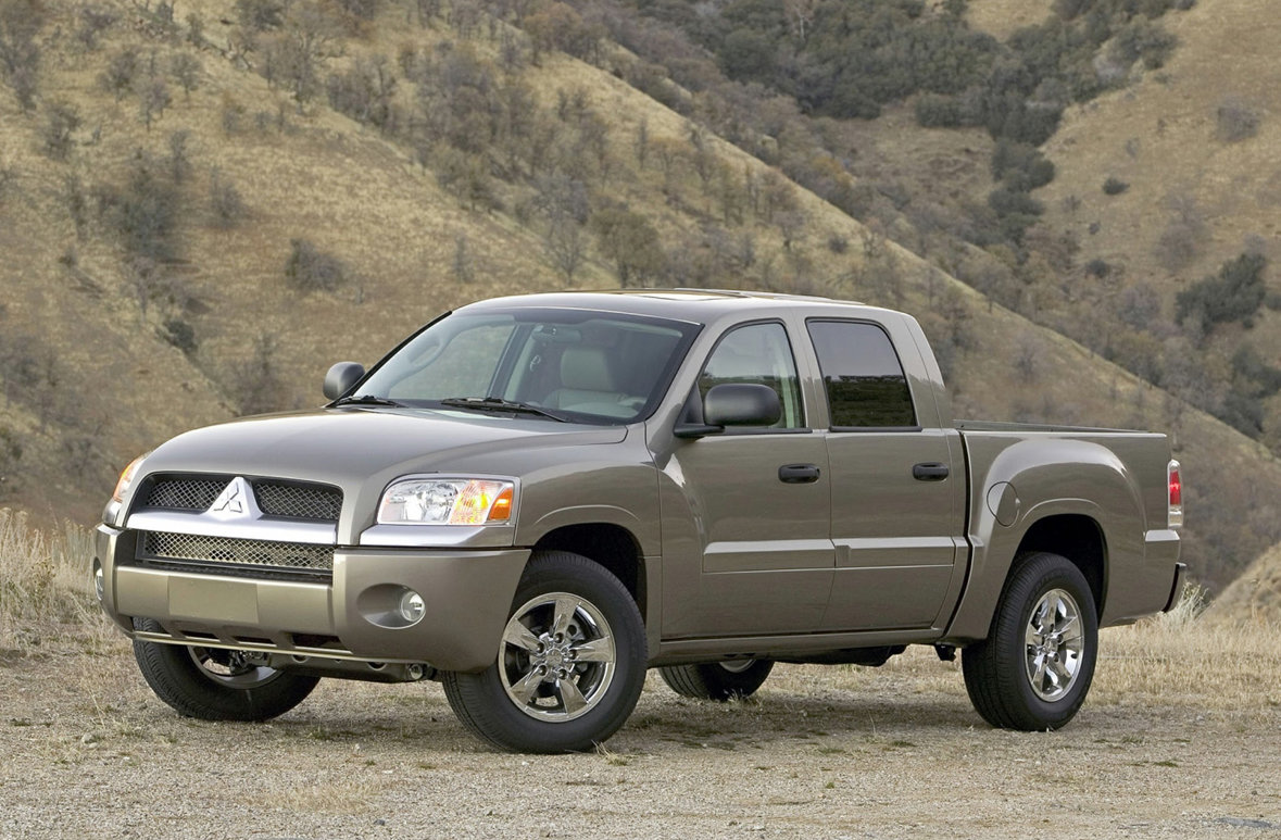

    Butt indentations
    dang
    might as well get a Mazda or Mitsubishi pickup.
