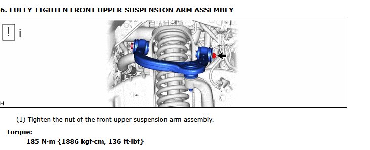

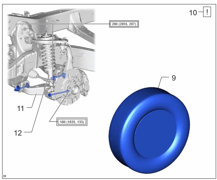

    Hello,
    I did a quick search and didn't see any of these posted for the 4g taco so I figured I'd share some useful torque spec information.
    THESE ARE FOR REFERENCE ONLY!!!!
    These values are not the same for every taco, they are all going to be very similar and in a lot of cases the exact same, BUT, there are variations and you must do your own homeworkand double check everything with the appropriate manual. YOU MUST also make sure your torque wrench is CALIBRATED or what's the point!
    These were early production numbers so keep in mind that things change with time, updated values may be completely different. MAKE SURE you know what you are doing before messing with your suspension.
    That being said...
    There are 3 values for each item, they are in the following format... N*m (kgf*cm, ft.*lbf)
    Hope this helps.
    Screenshot 2024-04-26 124816.png Screenshot 2024-05-14 105552.png Screenshot 2024-04-26 124852.png Screenshot 2024-04-26 124929.png Screenshot 2024-04-26 124942.png Screenshot 2024-04-26 124958.png Screenshot 2024-04-26 125021.png Screenshot 2024-04-26 125033.png Screenshot 2024-04-26 125052.png Screenshot 2024-04-26 125109.png Screenshot 2024-04-26 125129.png Screenshot 2024-04-26 125138.png Screenshot 2024-04-26 125149.png Screenshot 2024-04-26 125237.png
