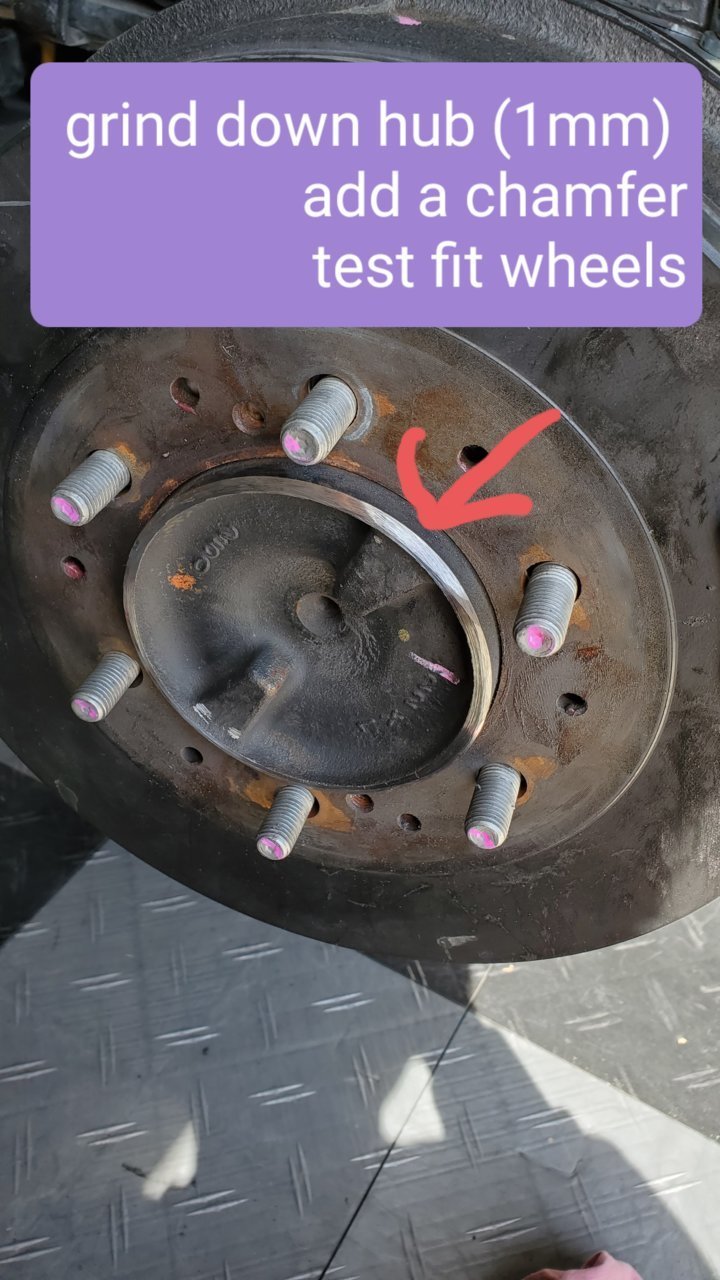

    You'd have to really, really like the most current 17" 4Runner Pro wheels over other options to install them on a 3rd Gen Tacoma given the grinding/machining required to make them fit.

    Yes, machining may be needed for the 2021+ 4Runner TRD Pro wheels. I believe it is only needed for the rear hubs. If you do not machine the bore, the wheels will not sit perfectly flush. However, there is one person that said they did not need to do anything for it to sit flush. 20210413_154059 (1).jpg
    Or you can use a thin spacer like 2mm.

    @pauldotcom did you ever get these and did they fit without modification to the rear hub?

    What or where would you install the 2mm spacer?
