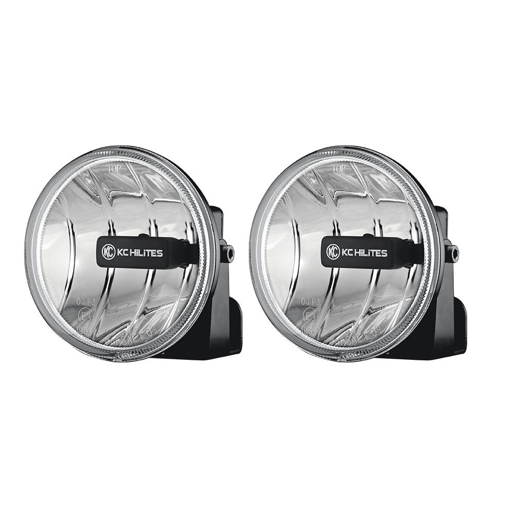

    If you're looking for some fog lights that are street legal, we have ones that will fit perfect. They are in our Gravity Series of LED lights and they are called the G4. It is a 4" round LED fog light, and it is available in either clear or amber LEDs. Here's the link for the G4s: http://www.kchilites.com/light-type/led/gravity-led/4-gravity-led-fog-light-pair-pack-system.html
    If you're wanting something that has much more throw and would be more for off-road only use, check out our LZR Series 4" round light. These are a spot beam pattern pumping out 1,832 raw lumens per light and would also fit great for you. Here's the link: http://www.kchilites.com/light-type/led/lzr-led/kc-lzr-led-driving-lights-4-round-300.html
    crashnburn80 and paranoid56 like this.
