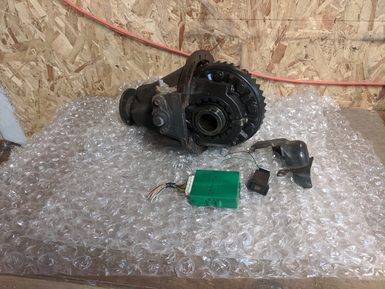

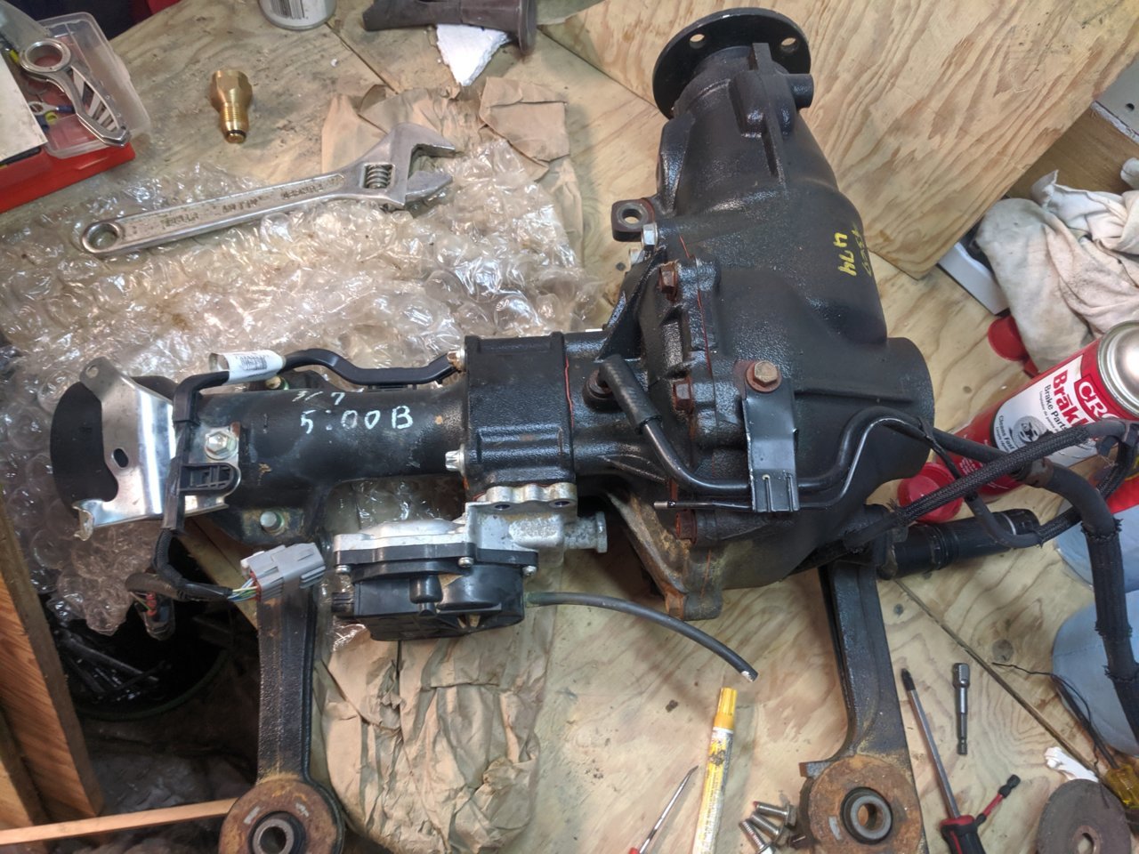

    TLDR: short version is I'm going to put OEM 4.30 gears into my 2nd gen off-road Tacoma. Using a 3rd gen Tacoma front clamshell and the pumpkin from a 3rd gen limited t4r. Should be straight forward plug and play drop in.
    Ok so as some of you may be well aware, Toyota uses the same parts across multiple platforms but features or options on those parts a only available to certain models. Like gear ratios.
    The 3rd gen Tacoma configured in 6spd manual v6 4x4 comes with 4.30 gearing. The front diff uses the same r&p as the 2nd gen Tacoma. That would lead one to assume the clamshell is the same and bolts into place.
    Next the 3rd gen t4r, limited models only, and some 1st Gen 4cyl O/R Tacomas came with factory elocker and 4.30 gearing. Also the fj cruiser uses the same axle and elocker. The elockers in the t4r, fjc and the 1st/2nd gen Tacomas are the same regardless if they are 3.73/3.91/4.10/4.30. The axle housings are all the same but the t4r is setup for coils/links vs the Tacomas with leafs.
    I've sourced and ordered the front and rear clam and pumpkin and should have them infront of me next week. Stay tuned. :popcorn:
    Top pic is the elocker 3rd from a 99 t4r. 2nd pic is front clam from a 2018 Tacoma.

    Front diff will be waiting for me when I get home.
    :bananadance::woot::goingcrazy:
    I think I'm more excited about it than the rear. The rear I know will swap no problem. I'm more interested to see if there are any differences between 2nd and 3rd gen front diffs that may not be immediately obvious via pictures.

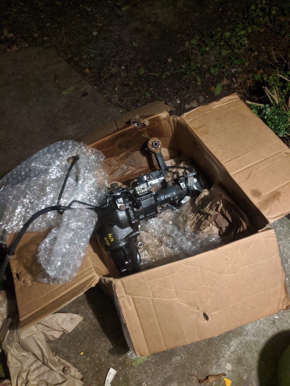

    I bet the FedEx guy was glad to get this off his truck. I could smell the gear oil when I walked up to my front porch.
