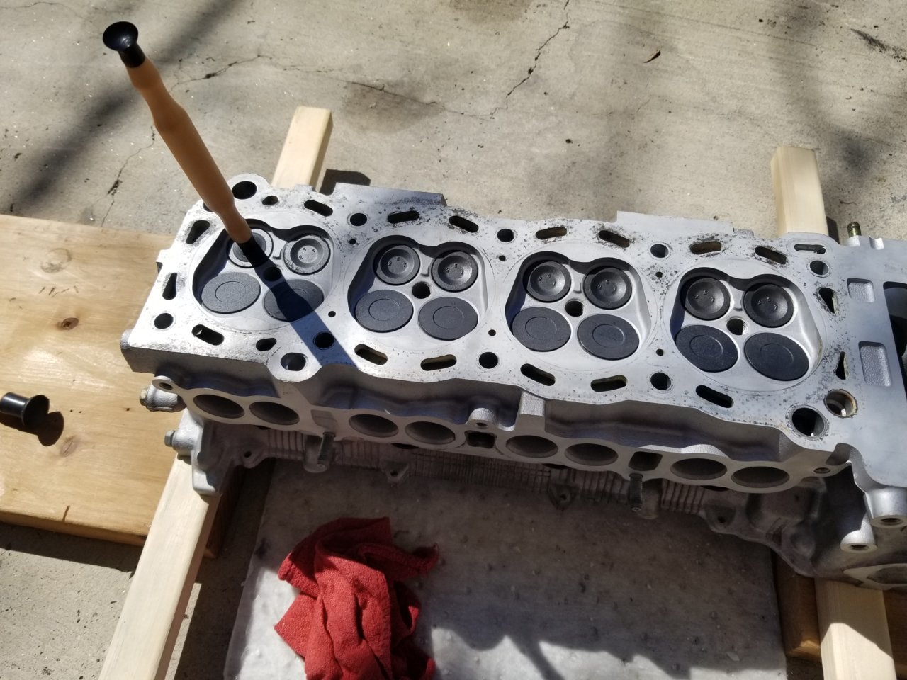

    I had an extra head laying around that I already soda blasted and purchased new valves/head bolts/ head gasket set/etc...
    Went ahead bought some lapping compound and got to work.
    After this I went ahead and started to measure all of the bucket shims I had from 2 heads and started working on trying to get everything to spec. Unfortunately, this did not work as the tolerances were too tight in areas and too large in others for the different size shims to compensate. Some shims after measuring that I would need Toyota didnt even make.
    After this set back I turned to my local machine shop. I knew a guy that worked there so I went over and he tested my lapping job first. Well I was almost there as there was a 20% leakage. Sigh* Well that was a good 5 hours wasted but it was a great learning experience nonetheless. I got them to go ahead and trim the valves themselves to fit the shims and cut new seats. A box of doughnuts made sure it was all done within 2 hours LOL
    Here is the final result.
    All in all it was a great learning experience. The truck now purrs with no issues. The stickshift barely vibrates. No more missfires. No more hard starts. More power. Better fuel economy.
    Compression test is very important guys I'm sure most of you know. If you have missfire codes definitely look at your spark plugs followed up by a compression test.
