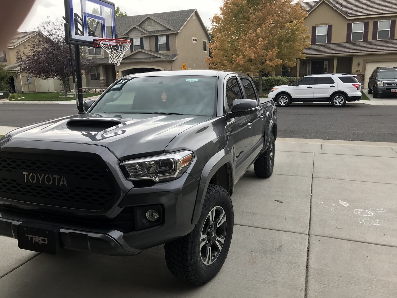

    So I have always wanted to know what this setup would look like. I’ve never been able to find 35s on the stock OR wheels, until tonight because I just got done mounting them.
    This thread is for anyone else that might be curious.
    Important: I purposely adjusted my UCAs to add a sketchy amount of camber so the tires would clear them. This was only to creep my way home from where I mounted the tires. This will be completely fixed when my wheel spacers come on Sunday. I won’t be driving the truck until then.

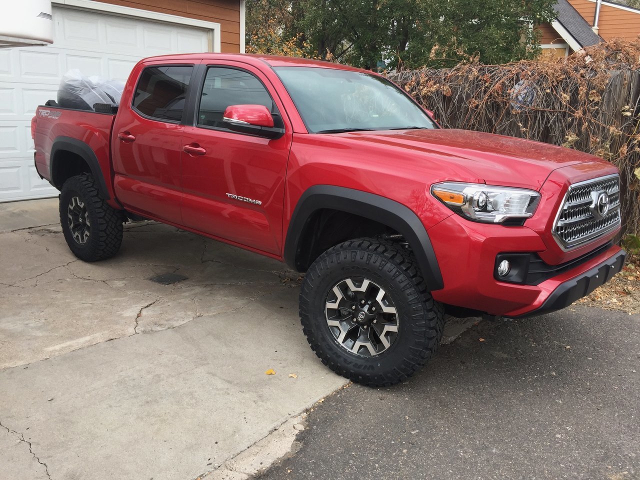

    Ok so bad shot of the tires, but they are 255/85/16 on stock wheels with no lift.
    EDIT: Here is a picture showing the tires a little better.

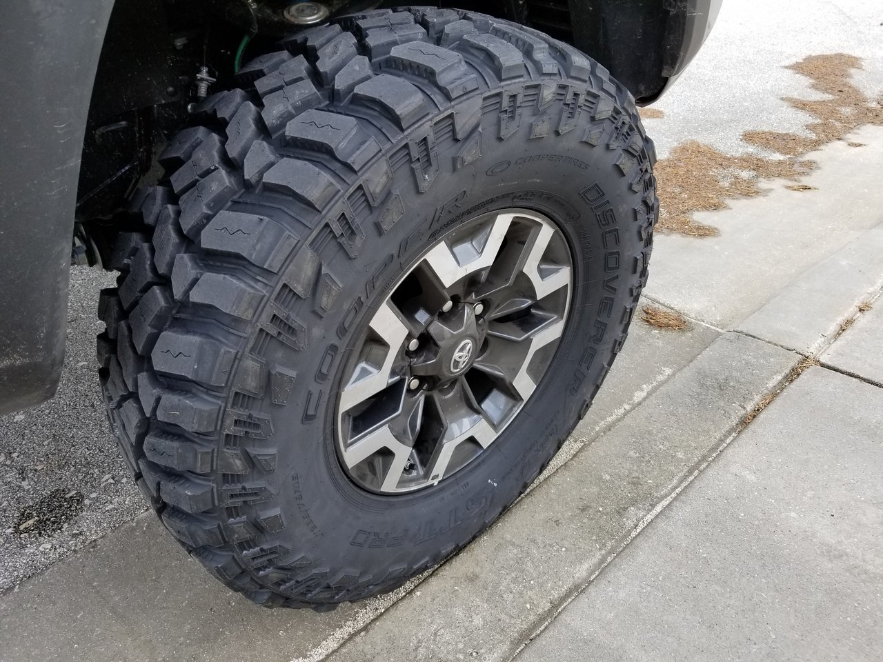

    3" lift, 1.5" wheel spacers, 285/75R16 Cooper STT Pro, 6000K HID lows, 6000K LED fogs, LED interior/exterior lights
    285/75R16 Cooper STT Pro's on stock off-road wheels. 3in front/2in rear lift with 1.5" hubcentric spacers. Hope this helps!!

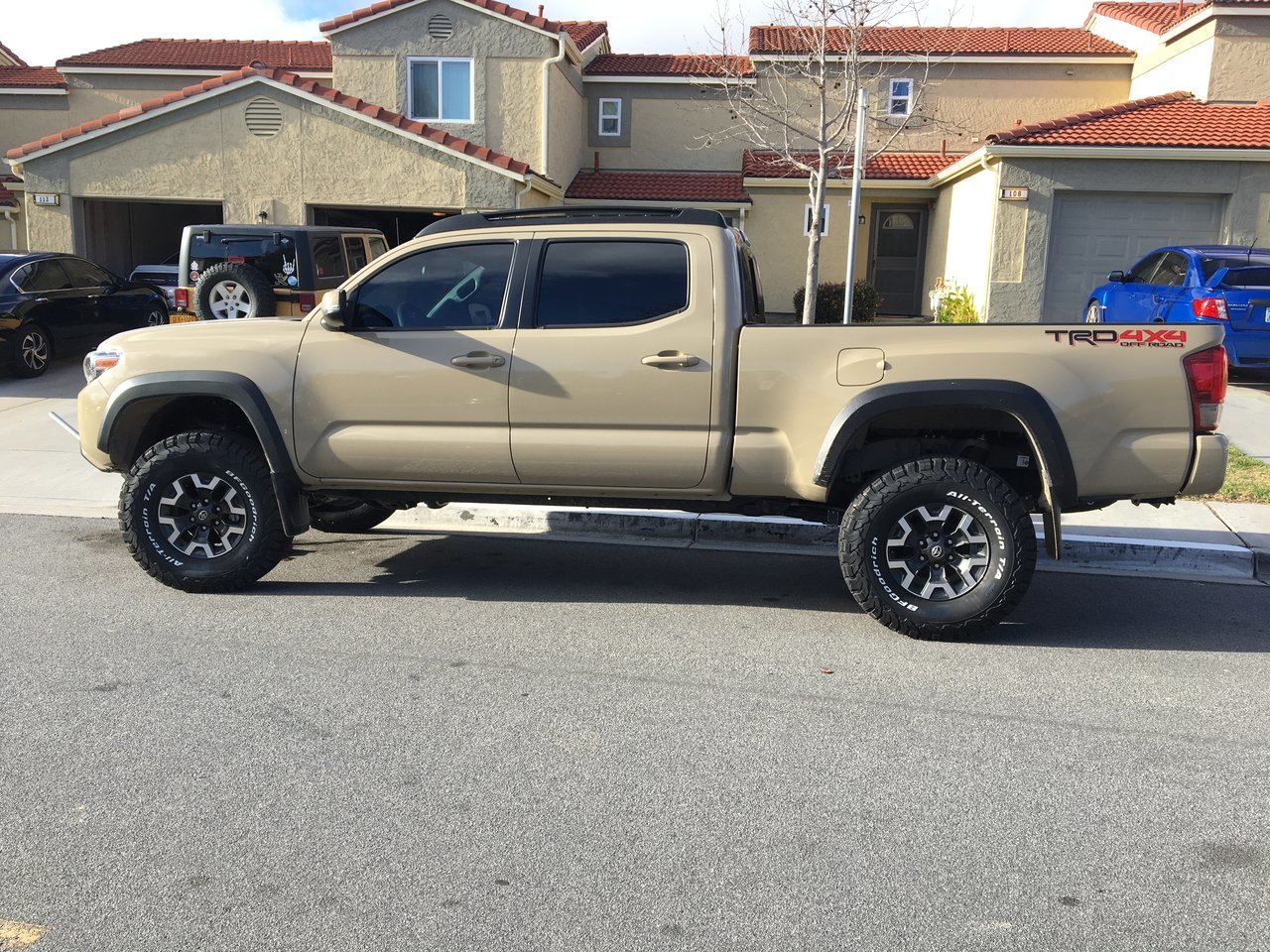

    255/85/16 on stock suspension
