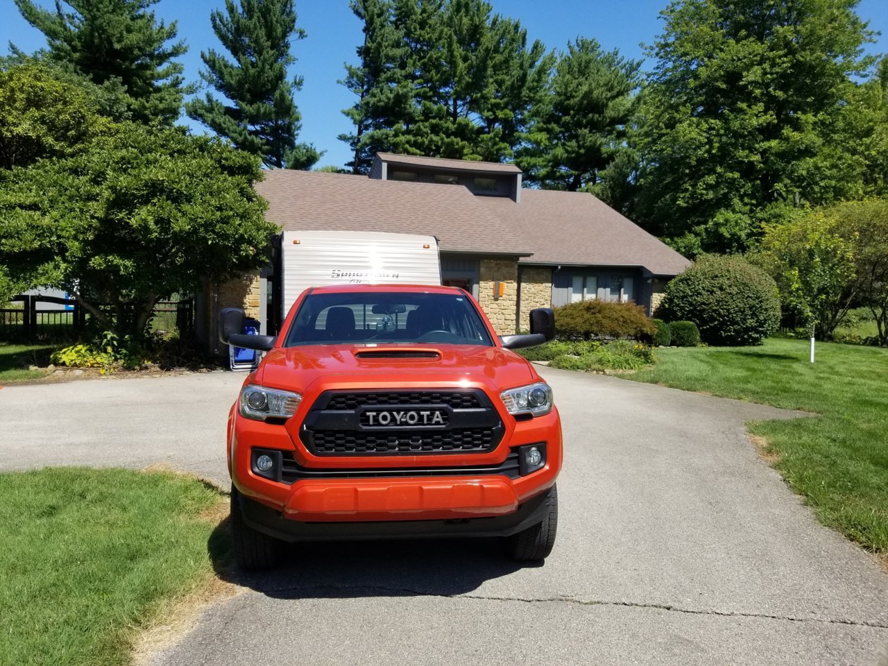

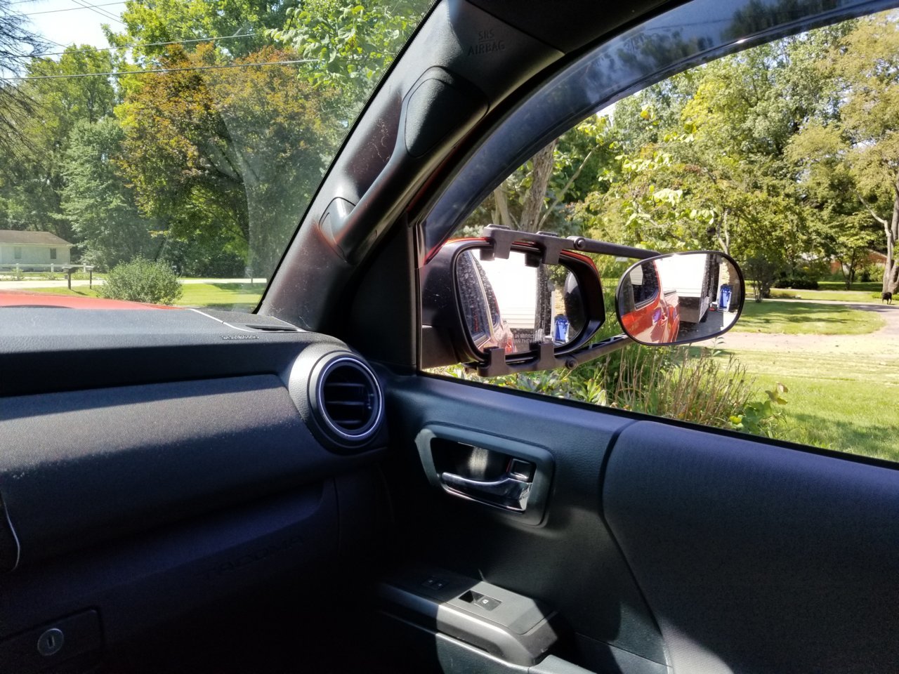

    I have began towing a 21ft small toy hauler travel trailer. The trailer is a fair amount wider than the Taco and the Taco "car" sized mirrors aren't helpful seeing the trailers sides and wheels. Previously I was using Fit System 3891 Deluxe Universal Clip-on Trailer Towing Mirrors. Although they worked they causing scuffs on my oem mirrors and in general are kind of a pain.
    I was happy to see there was finally a 3rd tow mirror solution. These are the mirrors I have
    https://www.1aauto.com/2016-18-toyo...l-ridge-tr00405/i/1amrp02074?f=1172286&y=2017
    They are plain plastic, heated, without a side marker. They make a side marker model but it is chrome and I don't like chrome. I didn't have heated oem mirrors so I can't report on that.
    The install was fairly straight forward. Remove door panel similar to installing front door speakers. Remove the 3 black sticked on dots covering the 10mm mirror nuts, remove 10mm nuts, unplug, and replace.
    The mirrors are bit huge here are some picture of before and after.
    A comparison:
    Clip ons (before)
    Mirrors normal
    Mirrors in tow mode
    All in all I really like the mirrors especially for the money. For the money these might be one of my favorite purchases.
