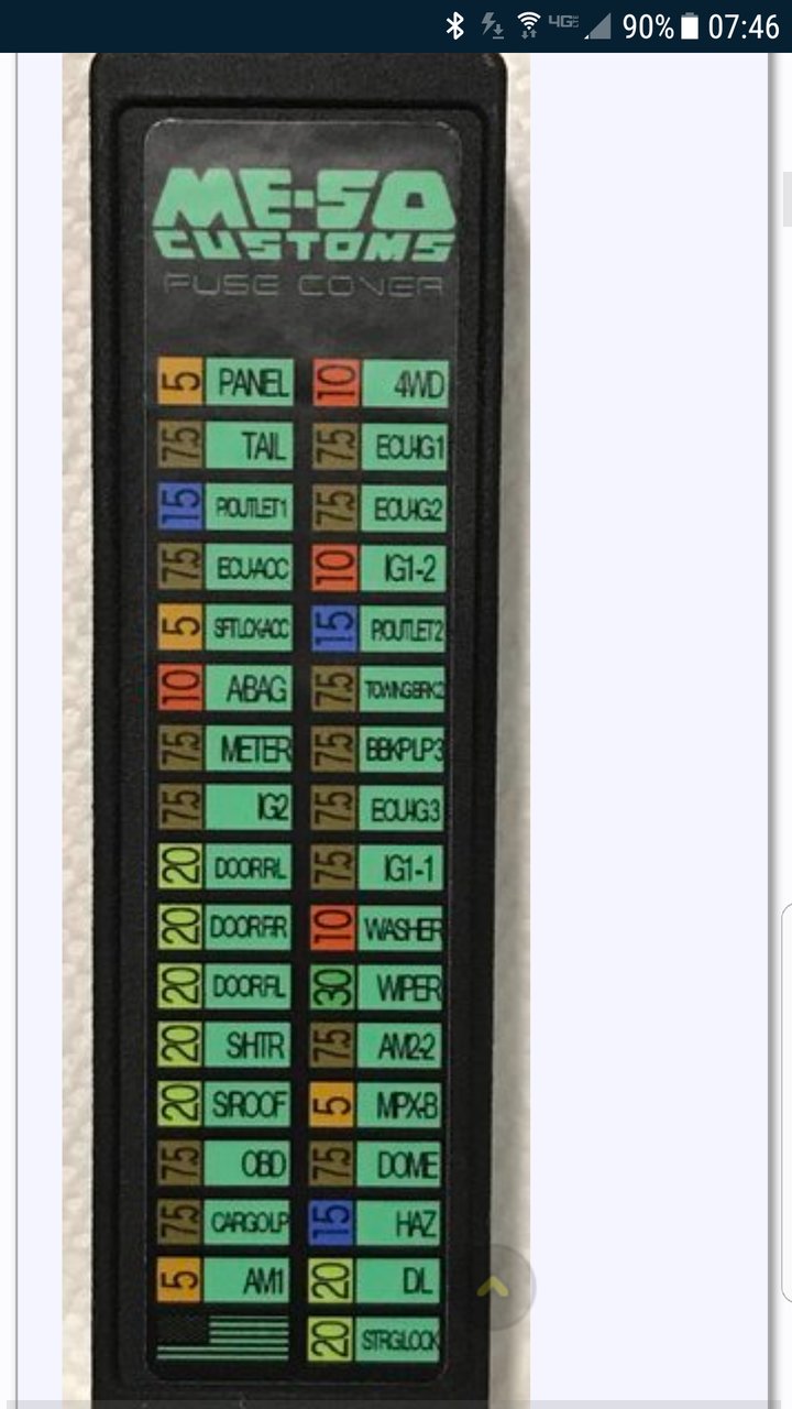

    Here's a pic of a custom cover. At least you will have something.

    Thank you! I'll save this in a few places so I never lose it :)
