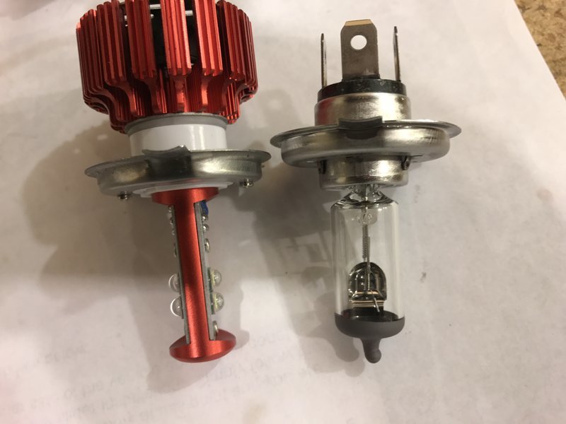

    To further emphasize the point, here is the Opt7 from 2016 vs a halogen H4 I tested 5 years ago. This is my own photo from nearly 5 years ago to the month. Look strangely familiar to the 'new' AuxBeam? The very wide width causing catastrophic loss of beam focus, loss of distance projection and shifting the light to entirely foreground light. They also utilize the old spreader optic dome on top of the emitter trying to make up for lack of focus. This design is archaic for LEDs and no reputable companies sell this anymore because it is obsolete and doesn't work. Except that is for those companies looking to sell obsolete cheap garbage products to unsuspecting buyers that fall for their BS marketing.
    If you want to see what an actual quality engineered replacement LED looks like, check out a real modern LED in post #3897.
