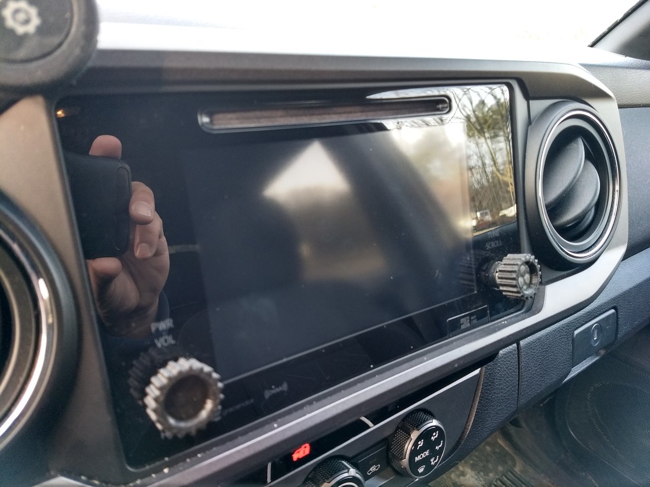

    Yeah looking at it further, that video doesn't seem to show nearly enough wires for reverse camera, steering wheel controls, etc.
    Don't know if it's JBL or not. I'm assuming it would say JBL somewhere, and I don't see it. Sorry for the crappy nighttime pic, but it's all I got.
    *edit - Updated pic. In trying to match up wires on stock Toyota harnesses, everything matches up except 3 from the back of the head unit.
    1. Pink - rear camera
    2. Brown/black - steering wheel key (although orange/black also says steering wheel key, and that matches up.)
    3. Brown - parking brake.
    I was going by the wiring harness ********* sells: https://*********.com/wp-content/uploads/2015/01/Toyota-Stereo-Wire-Harness-Adapter-aftermarket-stereo-installation.jpg

    first, we have to assume you have a non-jbl audio system. the jbl equipped trucks have their own amp and wiring behind the rear seats by the included subwoofer. the amp receives a digital signal from the radio, which cannot be cheaply interfaced with.
    second, you don't want to connect to the rear speaker outputs specifically because they have a neutered signal over the front speaker signal as part of the factory radio eq programming.
    instead, get a harness like this. yes, it's $50, but you'll easily spend that much botching the wiring job and having to pay someone else to fix it.
