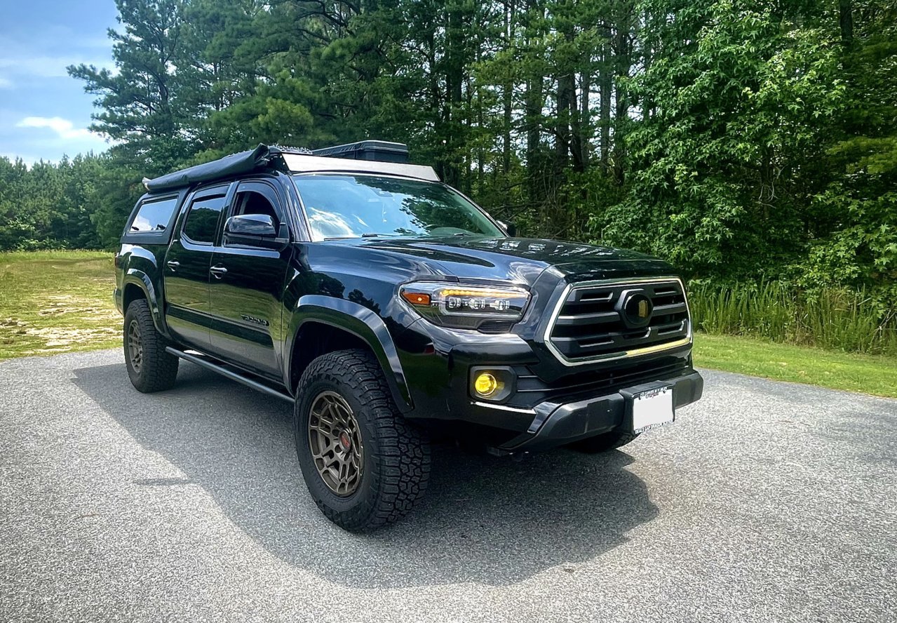

    If its worth anything, I just installed OEM TRD Pro style headlights on my '23 Trail Edition using Puppypunter's harness. I have had it for about two weeks now and no issues. Followed his directions for install (and all the videos for installing LED headlights). The dealership would do it, but it would cost 3000+. So I bought my headlights from Sparks Parts for 1450ish, and Puppypunters harness for 175 and installed myself. It was a pain in the ass with removing the bumper and getting everything lined up. But again, I am very pleased with the results. Below are some before and after pictures.

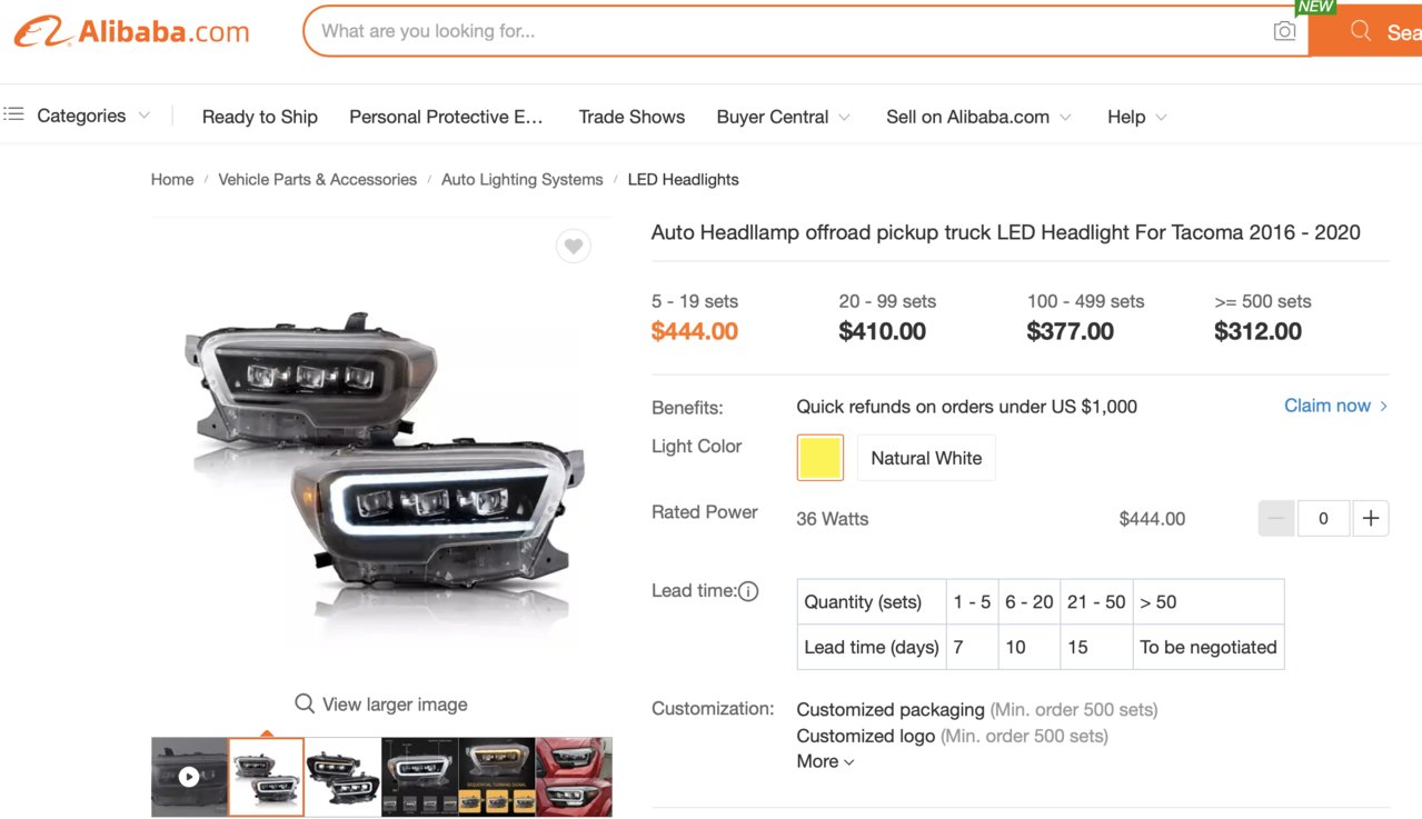

    Definitely no. While Diode Dynamics makes some of the best products on the market, their separate Form brand is just an importer and reseller of cheap Chinese lights, typically from Vland. You can buy this stuff straight off Alibaba out of China, or AliExpress. Vland doesn't hold a candle to Morimoto, much less OEM. They use cheap Chinese projectors that also have no uplight, typically poor/inconsistent beam pattern and are a downgrade from OEM halogens. Definitely avoid. OEM halogens with upgraded bulbs will be vastly superior.
