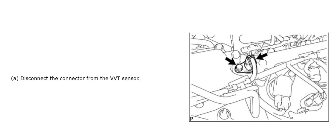

    That's the exact same spot they chewed mine off. What is that sensor?
  5. Nov 11, 2021 at 6:14 AM
    Homiec
    Homiec Well-Known Member
    Dec 13, 2019
    #313204
    310
    2020 TRD Sport Access Cab 4X4 MT
    Looks like the VVT sensor for bank 2 intake. The wiring diagram below uses bank 1 as an example but the concept is the same for both banks.
