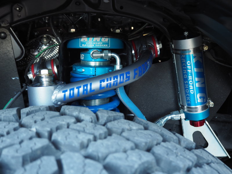

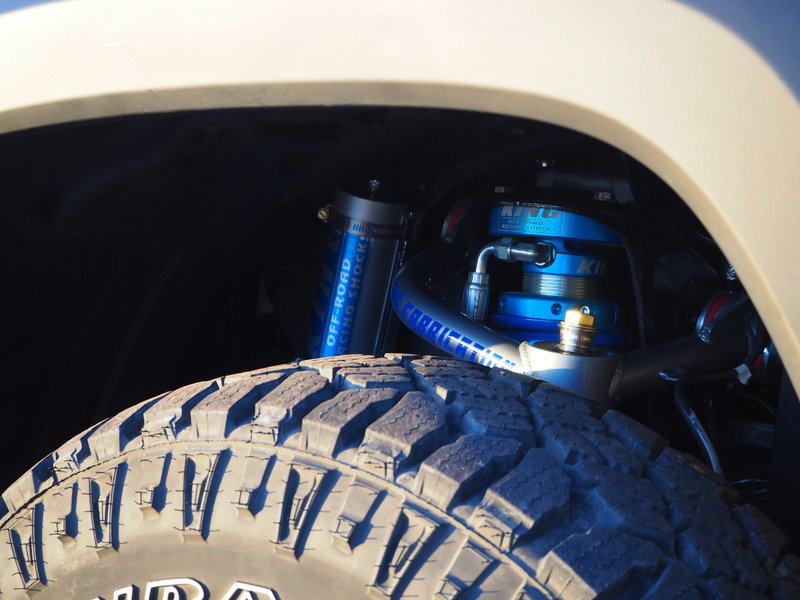

    Thanks Op for starting a 3rd gen specific King Thread. I run them and can share my experience, which can hopefully help others. I have the ext. travel with adjusters all around as well as total chaos UCA's. 600 lb.in springs, and tires are 265/75/16 Duratracs (C) on OEM wheels with no spacers.
    I only wanted a mild lift so the front passenger side is set at factory height (which was about 1/2" thread showing). I had to turn the drivers side to about an inch of thread body showing in order to remove the side to side lean.
    Passenger:
    Driver:

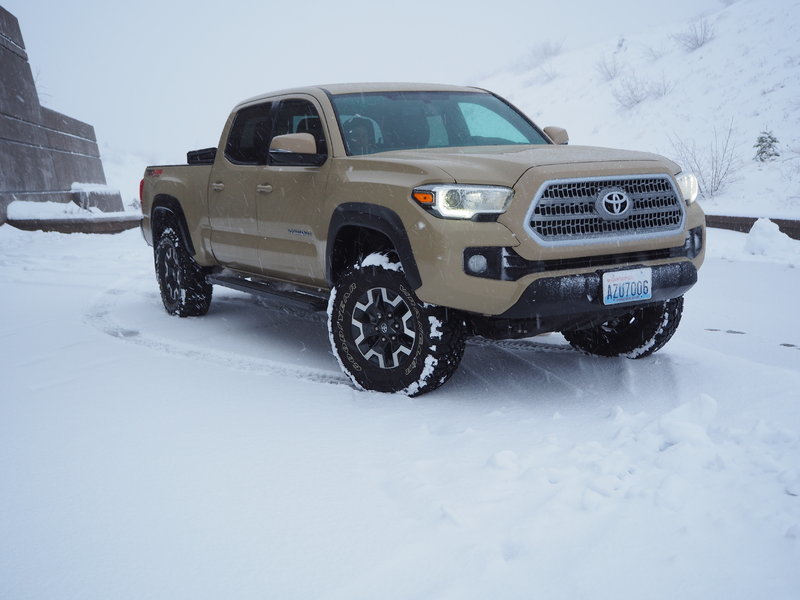

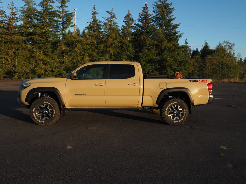

    This gained me approx. 1.25-1.5" up front. Initially I had a single AAL in the back to maintain factory rake. However it added about 2", and made the back intolerably stiff... I would not suggest this. Next I went with the Deaver 10 leaf pack, which netted me about 1.5" in the back. I also had to add a 1/2" shim under the drivers side leaf spring pack due to the lean. The ride from the Deavers was strange... They were incredible on washboards and most off road situations with tons of flex. However on road, they had this weird kind of flat stiff unsprung feeling. Also I had the rumble strip effect when coming to a stop as well as other strange vibration issues with the pack installed, I am assuming it is pinion angle related. Here is a pic with the deavers:
    I ended up removing the deavers and now just run the stock leaf pack with the 1/2" drivers side shim. So far this has been the best overall ride solution that I've tried. With this config. the truck sits level (don't have a good side pic yet):
