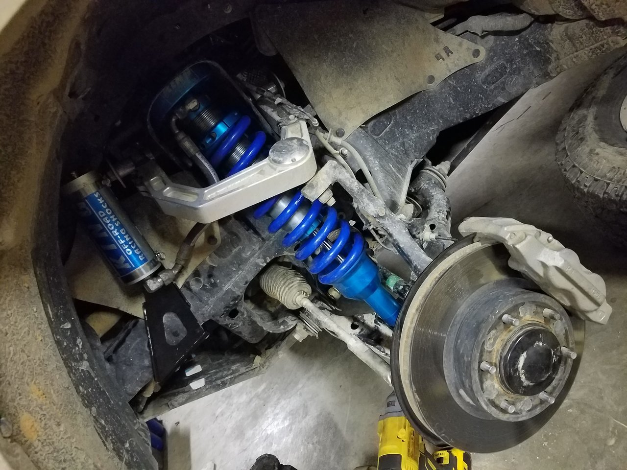

    As an update to this post:
    1) I went back and lowered the pre-load (IE ride height) on the front coilover to get closer to recommended settings, get rid of the clanking sound and soften the ride. I have roughly 9 threads showing on the drivers side and 13 threads showing on the passenger side. This height eliminated my clunking noise, smoothed out the ride, compensated for the "taco lean" and was a good compromise between taller ride height and the King's suggested pre-load setting.
    2) (IMPORTANT) When lowering the truck ride height by spinning the collar back down the shaft, I notied that the WHOLE assembly was rotating at the bottom of the spring perch/cup, NOT just the spring. I did not notice this when initially adjusting pre-load and I think all of those rotations (unthreading the shock internally or whatever) was the cause of the clunking sound, not coil bind. I must have rotated the entire shock body/assembly many times without realizing it when I made my initial adjustments, as I thought I was just spinning the spring around. This is probably the reason King suggests you make adjustments with the coilover NOT INSTALLED on the car. An alternative could be to rent spring compressors to unload the spring and adjust the ride height (pre-load) as to not spin the shock body along with the spring.
    VERY happy with the ride. These things soak up bumps and ruts and potholes with such finesse, I can tell they're much more competent that the stock OR suspension. Now I need to get them offroad and really test them out.

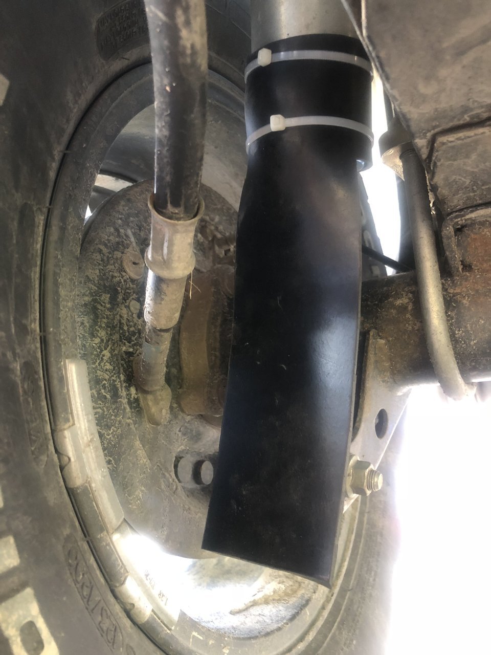

    An unusually high amount of pinstriping.
    The shaft for the passenger side has been getting dinged by gravel so added a little protection.

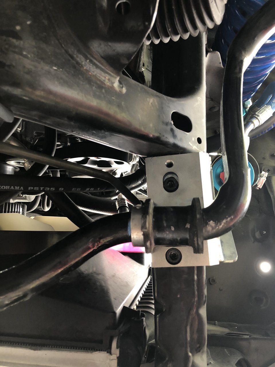

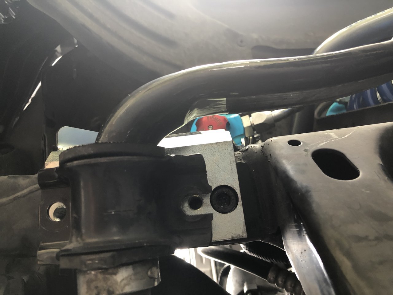

    hey guys, anyone received and installed there eking kit and had the reservoir brackets to the swayer me drilled be wrong? My driver side bracket lines up perfect, my passenger side, the threaded holes needed to be exactly the other way around before they welded the bracket together. Pics for reference.

    Destiny's way of saying you don't need a sway bar? :boink:

    I agree hah. Don’t really NEED to run one. But the passenger side res mount sits about an inch closer to the frame because the hole were drilled wrong. So I at least need another mount fmto get the reservoir away a bit.

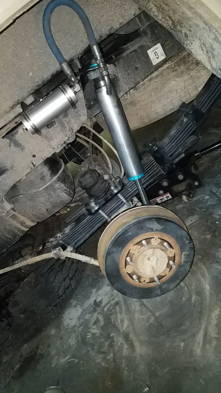

    My truck is stiff now, but I like how well it handles going through my pasture with terraces about 40mph.
    The king coilovers are stiffer than the fox shocks I replaced.
    Differences are fox - 650lbsx13"... king - 600lbsx14" though I included a photo to show difference in preload. The kings also added ~1.5 inches of lift
    My rear set up is OME EL096R with Timbren ubolt flip.

    Sounds like what exactly happened to me. Called them up and they sent out the correct bracket the next day and had it on the day after.
