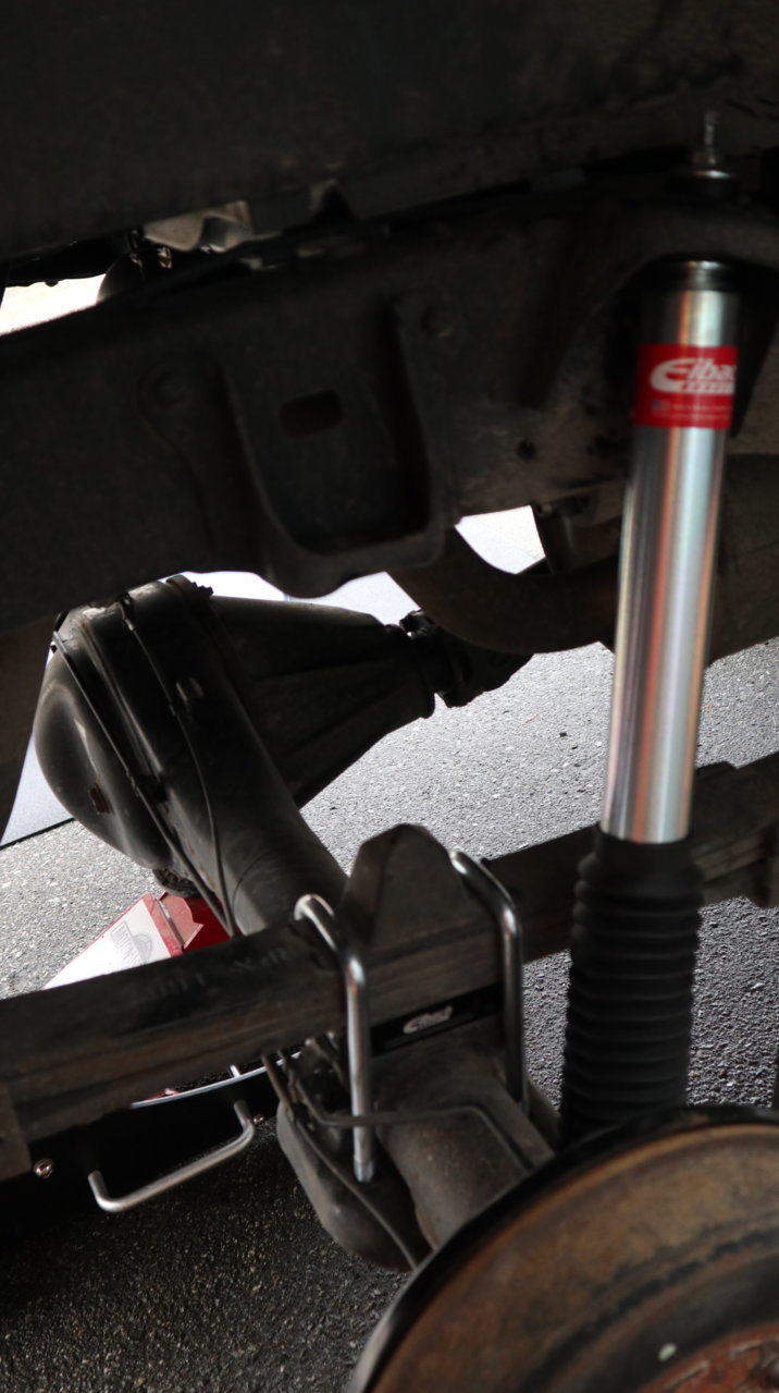

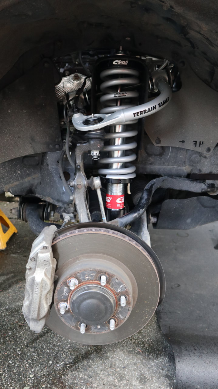

    Yes you are correct. They are digressive, but you will find that most shocks are in the digressive scale, including Bilstein, with a few exceptions (Factory Fox shocks). Really the difference is how the shocks handle the rebound that makes all the difference.
    The Hitachi's handle rebound like there was a metal rod between the upper and lower shock mounts. With no give up or down. This gives that feel of hopping and jitteriness over uneven surfaces.
    The Eibach's take the first hit firmly but not bone jarring like the Hitachi's, and then absorb the rebound where you almost don't feel it at all. The wheels feel planted and the feel of hopping and jitteriness is gone.
