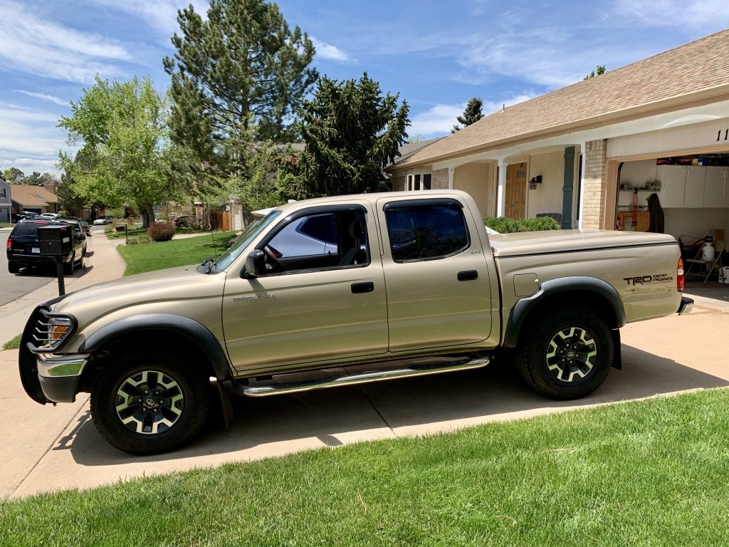

    Hey Gents,
    I have a 3rd Gen 2020 Offroad with the factory wheels (tire size is 265/70/16, I think the wheel size is 16x7?). I just put new wheels/tires on. My neighbor has a 2001 SR5 4x4 with the same tire size (265/70/16). I want to know if my 2020 OEM wheels will fit on his 1st gen? Specifically looking for info on the stock wheel width and offset for the 1st gen SR5 4x4? I've done a little searching but didn't find a simple thread talking about stock wheel sizes / offsets for the 1st gens. Can someone point me in the right direction? I think I've found the width/offset info for the 3rd gens in doing my wheel research prior to my recent wheel upgrade...
    Thanks!

    6-lug wheels are very interchangeable across generations!

    3rd gen wheels will fit on first gen trucks, BUT, they have slightly less backset, so likely you will have a slight rub on the frame at full lock, and there is very little room between the upper a arm and the tire. How much rub somewhat depends on the tires. I have two sets of 3rd gen wheels, with the same size tires, but one set is mud terrains, and do rub on the frame, second set with all season tires does not.

    I put them on my '04 with stock suspension and had no fitment issues.

    I think I saw Cooper Discoverer AT3 tires on his truck. Not too aggressive, so you're saying they might very well fit with out rubbing the frame... Great info guys, thank you so much for the quick replies!

    Yes just fine, have the gen 3 2020 sport wheels on mine in 17" stock suspension 265/70/17 minor rub at full crank

    Backspacing is a huge issue. They sit very close to the truck, tucked into the body.

    I see a lot of posts claiming this and I measured mine with the OEM wheel/tire and 3Rrd gen wheel/tire and came up with 3/8" closer to the frame on each side or 3/4" narrower overall. There may be some wheel/tire combinations that sit closer but the overall stance difference looks negligible to me.
    OEM steelies were stamped 16X7 JJ

    If you run much in muddy conditions, you'll understand that tucked in isn't always a bad thing.

    It’s my daily haha. It grinds like hell on the frame.

    HMMM. Mine is only at full lock, and only with my mud-terrain Wranglers. All season/all terrains with less aggressive bite on the edge don't rub at all.

    This is how it turned out. No rubbing side to side reported so far.
