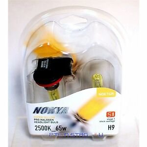

    Trying these out at the moment. Obviously the coating means they won't compete with the Philips H9. I like the color though. Easy on the eyes.

    Yeah. The yellow actually seems lighter than it did with my H10 fogs. Maybe due to the extra 20 watts. Maybe they don't adjust the coating to compensate for higher wattage :notsure:

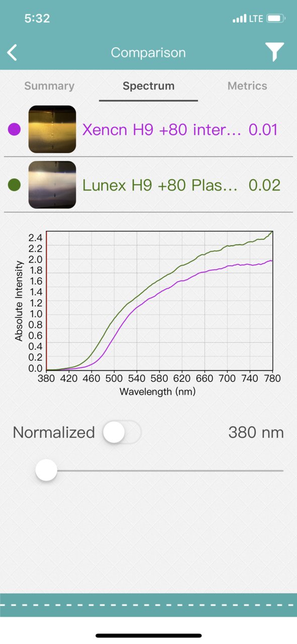

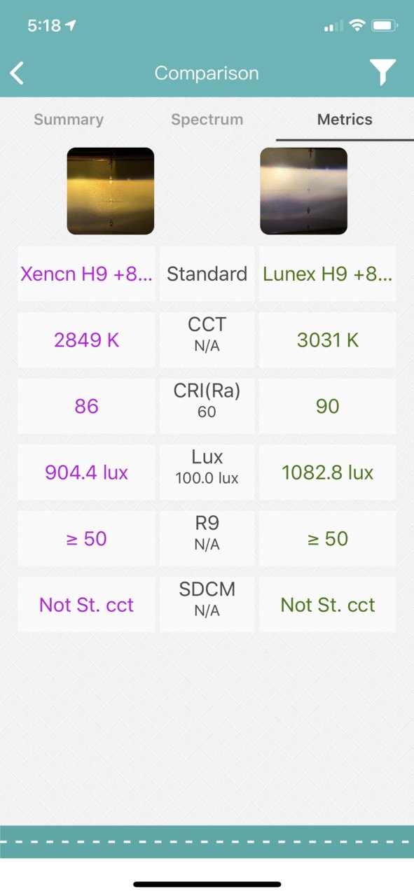

    I've got some diffraction coated H9s you are welcome to try if you like. Lunex provides a golden hue while Xencn is a lower color temp but also lower output. Diffraction uses a coating to diffract/bend the targeted light spectrum (blue light in this case) out of the main beam. In the Tacoma projector the majority of this blue light then appears to be blocked by the projectors internal light shield, leaving a lower color temp light for the beam. I wouldn't recommend either Brand brand per say, as they are not mainstream brands known for quality. But I have tested both these and they are higher output over stock.
    203DC386-E11A-452D-9055-A9F1BBA1501A.jpg 39E521E3-3920-4A98-BE92-D0778D03F743.jpg

    I've heard of xencn before, but haven't tried them. Have you tested any Nokya bulls before? I'm not sure how their output compares to the bigger brands, but they seem to be good quality and have a pretty good lifespan.

    Xencn is a China brand. I bought their diffraction 2500k H9 bulbs for my Tacoma Subaru fog H9 conversion, as they were the lowest color temp diffraction H9s I could find. I think they are a bit too low color temp for headlight use. I haven't tested Nokya, much of their halogen product line focuses on blue coated 'white' bulbs. They do offer some clear 'stage 2' higher wattage bulbs, including a 75w H11 which I've thought about testing. If you are looking for an 'All Season' bulb, the Lunex H9 I think is a better fit, they give more of a pleasant golden color that is easy on the eyes vs coated yellow . Lunex is an India brand that masquerades as a UK startup brand. Again, neither of these are high quality reputable brands. If you'd like to try them out I'll send them your way for the shipping cost.

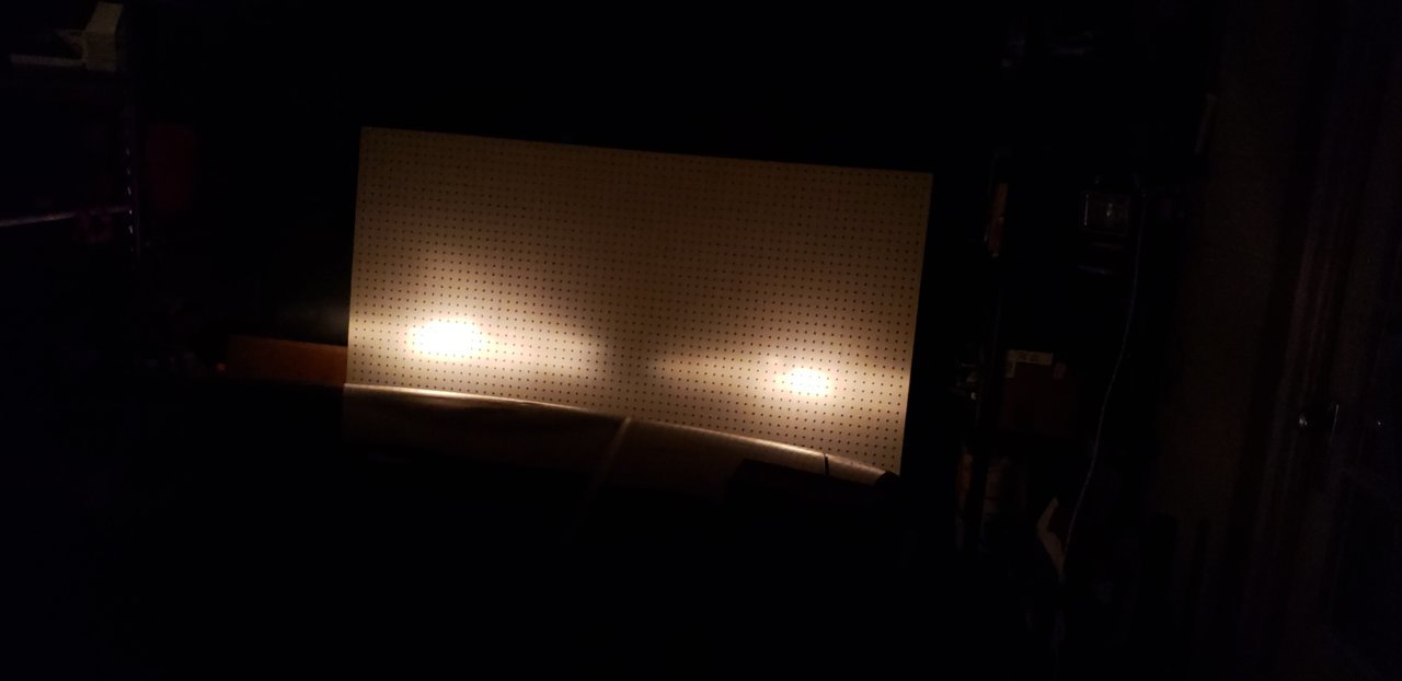

    You make quite a few comments about not running them in reflectors due to glare. As I said, I put the cheaper versions in my Mustang, which obviously has reflectors, and they look fine. The pattern does looks like it might have a few more strays than the stock halogens with a glare cap, but not something I think is gonna blind anyone. I'll post some pics. Maybe you can tell me I'm an idiot that can't interpret proper headlight patterns. The deal with the fog light, IMO, is probably something specific to certain reflector designs, and not something all reflectors would suffer from. I may be completely wrong on that, though.:notsure:
    The pics LOOK like they have a less defined cutoff, but that's just because I'm so close to the board that the LED hot spot is washed out.

    Your mustang lights definitely suffer from high glare. Look at the top of the board in the halogen only pic. It is dark as it should be, as light should not be going into that region. In your side-by-side comparison pic, the top of the board is well lit, as are the walls and everything around the LED side. That is glare. And while you may find it helpful to you to light everything around the car, it is also blinding to oncoming drivers. If the light is going where it is not supposed to, that is also less light going where it is actually supposed to, meaning the light is wasted, which is the lack of focus. And that lack of focus reduces distance projection. The side-by-side comparison also appear the light isn't as well defined, which makes it more shorter range flood. So while the LEDs look impressive up close, with wasted light and lack of focus the beam does not carry as far. I know photographing this stuff is very challenging, I spend a lot of time doing it. The products are getting better though, and quality LED manufactures continue to work on ways to improve focus. There is a low signal to noise ratio though, many aftermarket brands are often way more focused on raw output rather than optical focus, projection and glare.
