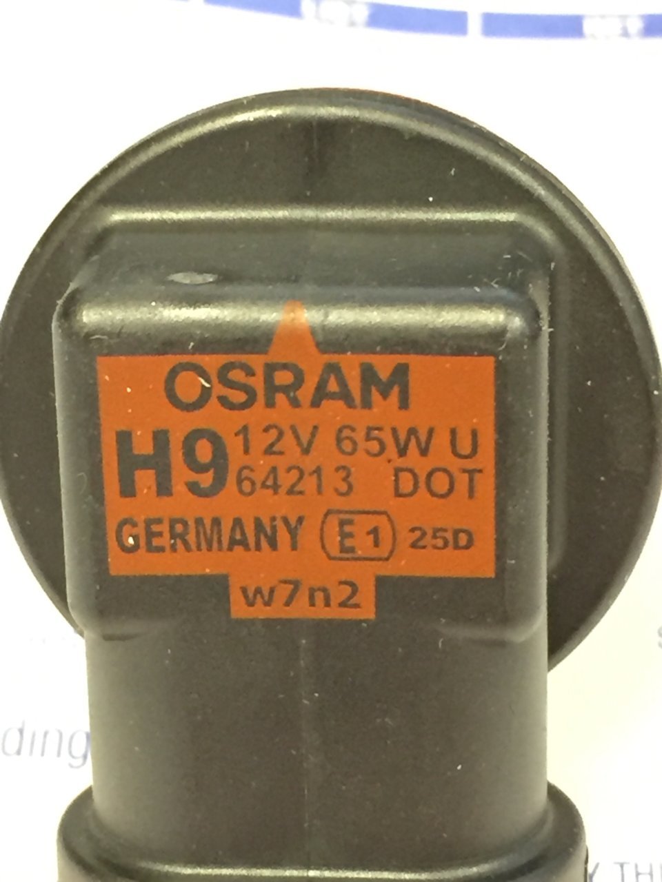

    Hmm. My ACDelco bulbs haven't shown up yet, they should be here this week. Pics I found online showed the German Philips bulbs, but ACDelco may just use Osram and Philips interchangeably or switched suppliers since the photos I found were taken.
    I also ordered some GE H9s, and have the China Philips H9s coming from @Frank_Zuccarini in addition to the Xencn 70w H9s all due in this week. That is the last of the bulbs I plan on testing at this time. I'll then update the first page with comparison charts and recommendations.

    Based on pics from an Amazon listing, that is the "sylvania basic" bulb that can be bought off the shelf at most auto parts stores.

    Right. That is the Osram bulb that was used in the original post of the thread, which is also sold under the Sylvania brand.

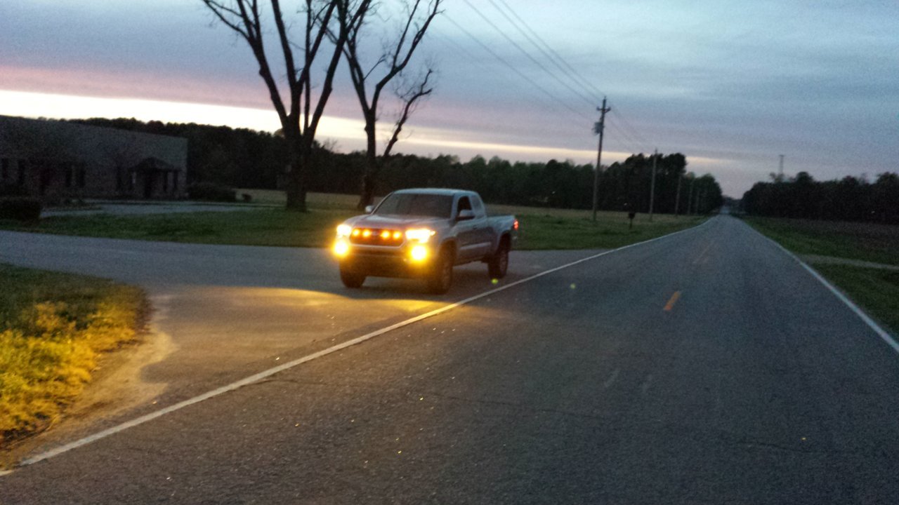

    Here's what they (the NOKYA fog lights) looked like as it was beginning to get dark this evening. Low beam headlights, and H11 Hyper Yellow fogs. It'll be a few months before I have much fog to try them out in. ;)
