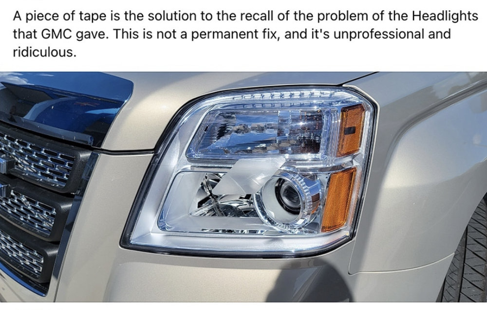

    Per a thread on candlepowerforums, GM had unsuccessfuly tried to petition to not be forced to recall them, as the glare limit was only exceeded in one small area, because of the reflective finish inside the lamp. The "tape" seems like a practical solution to an otherwise expensive problem, given that the lamps are otherwise completely compliant.
    2Nice and crashnburn80[OP] like this.

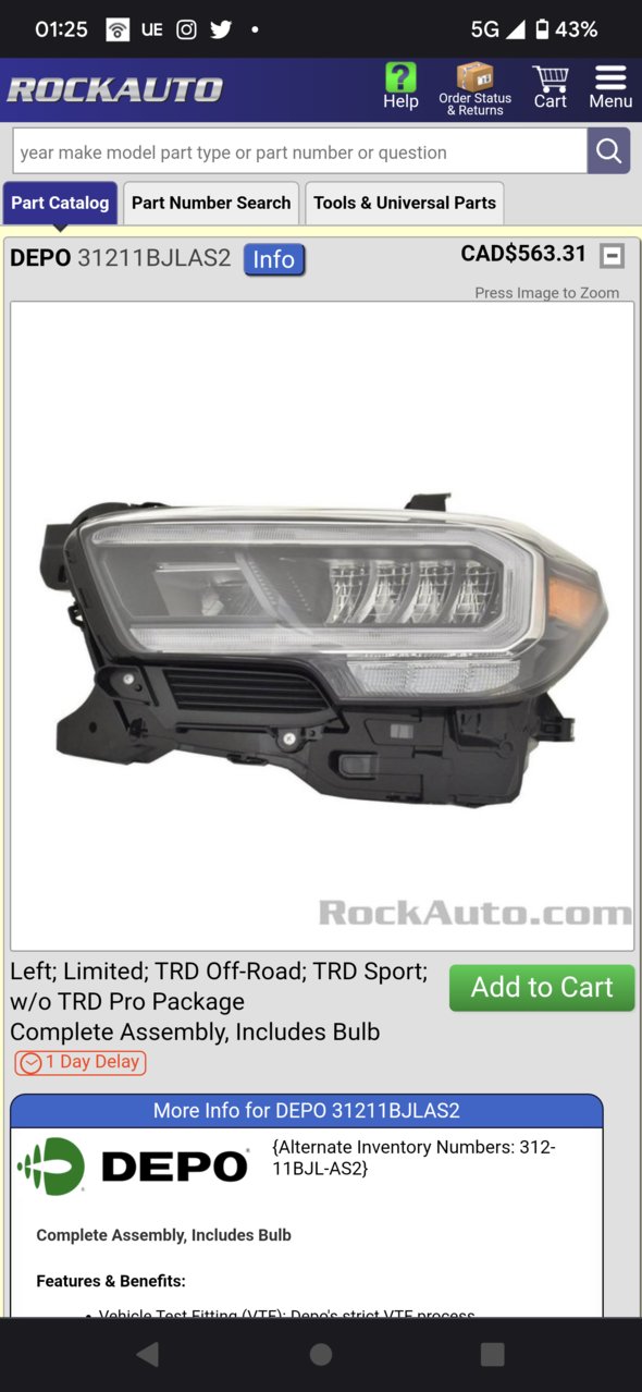

    Definitely avoid. Several brands sell the same OEM style replica Chinese LED headlight for a fraction of the OEM price. They are all terrible. You'll note that all the aftermarket ones while looking similar at first actually have less emitters and less reflector buckets, they also have poor inconsistent output, poor pattern coverage, lack of good hot spot, and poor build quality. Another example of a product people buy to think they are saving a little money, but then end up having to replace them so they can actually see, spending even more money than if they didn't buy them in the first place.
    Example here:
    https://www.tacomaworld.com/threads...s-reflector-style.686238/page-3#post-24417054
    If you are going to spend money on a headlight replacement, save for the OEM LEDs or do a bulb upgrade in the stock halogen units instead.
