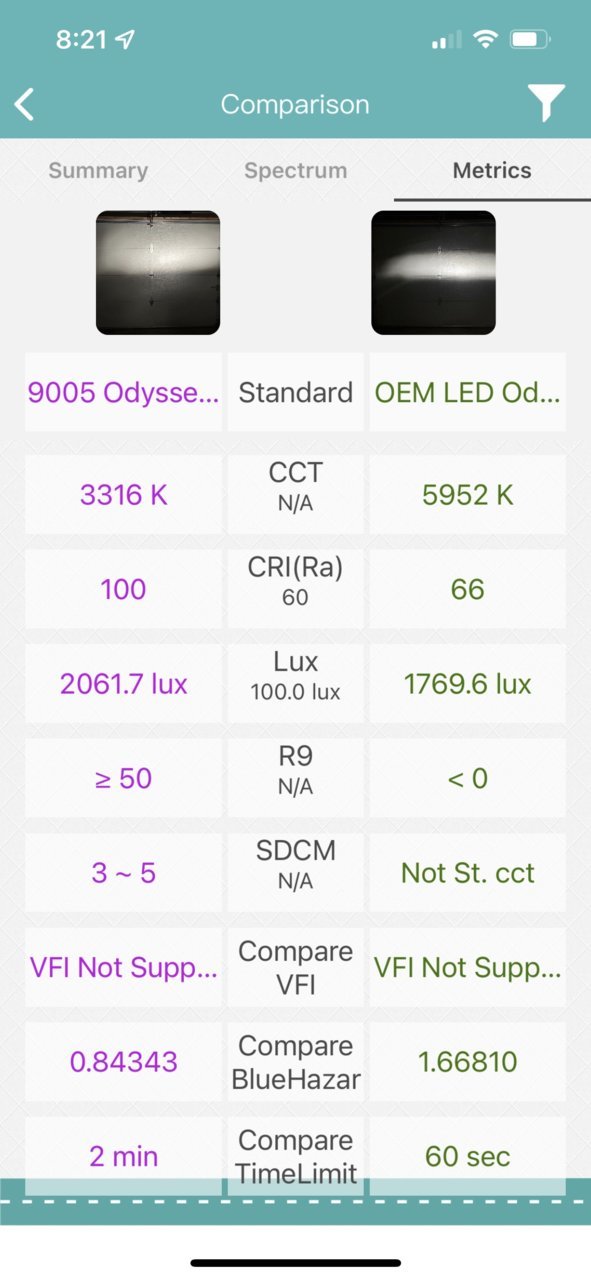

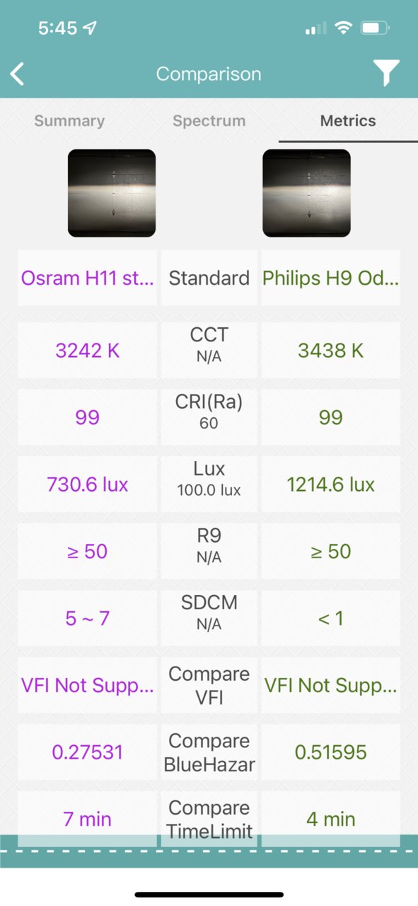

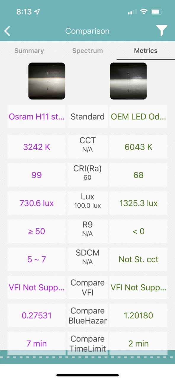

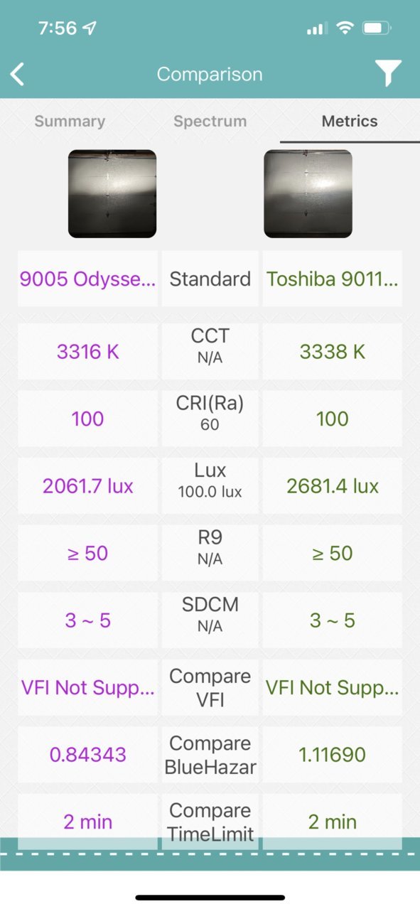

    Off topic non-Toyota post, but I recently tested some lights from @daveeasa and figured I'd share the results, as it was relatively interesting.

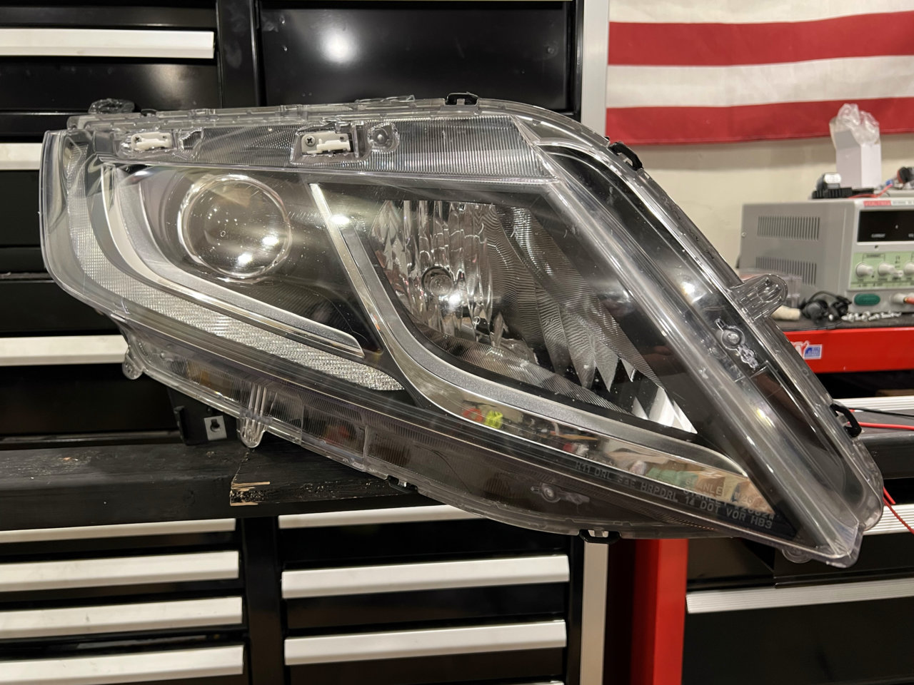

    OEM Halogen assembly using an H11 low beam projector and a 9005 high beam reflector

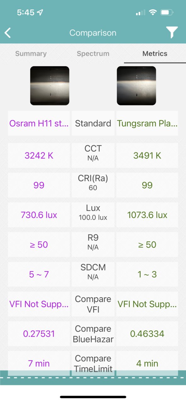

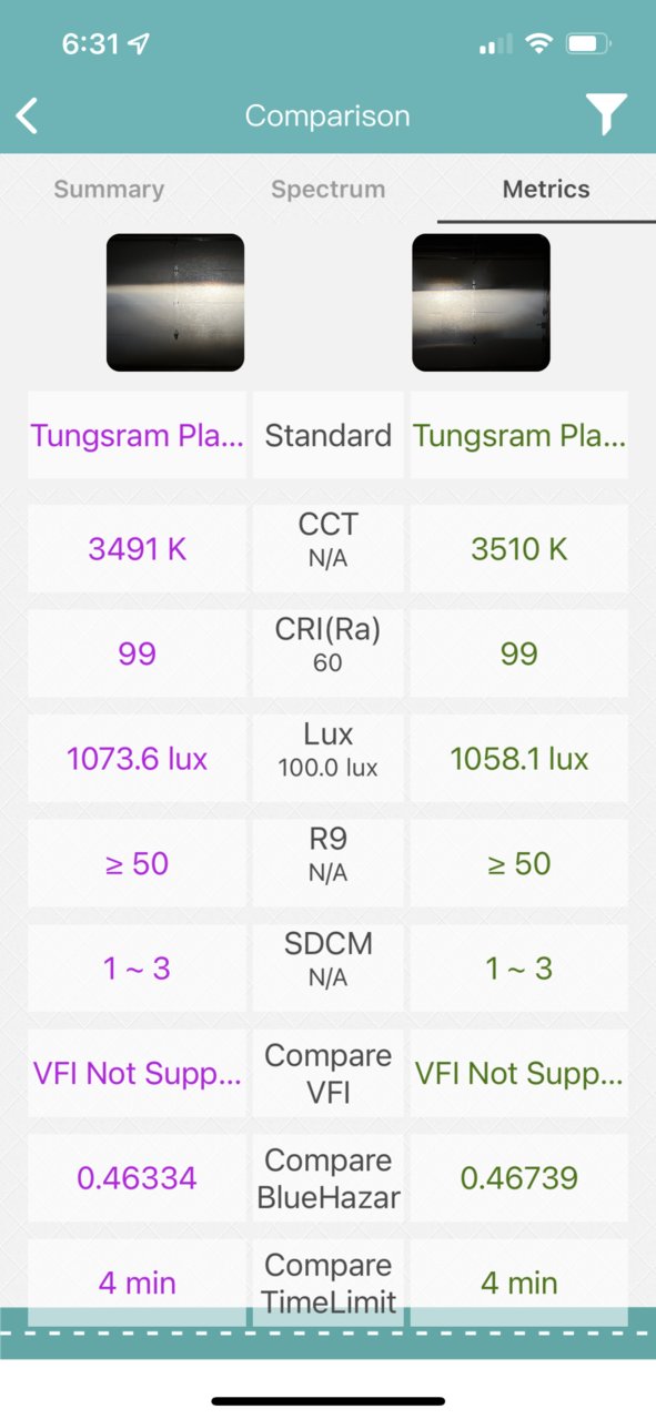

    Osram standard H11 vs Tungsram Platinum H11
    The Tungsrams improve output intensity by about 47% over an Osram standard H11. However, Honda issues these with an even lower performing Long Life bulb, so using the Osram Standard H11 is providing slightly more favorable results as a stock baseline than what a vehicle driven off the lot will experience. Since I only have one assembly of each and not a typical set, I cannot provide the usual side-by-side comparison images for the halogen bulb upgrades.

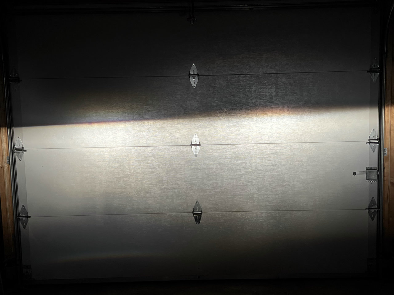

    OEM Beam pattern with Tungsram Platinum H11s

    Osram standard H11 vs German Philips H9 swap
    The Philips H9 swap returns about a 66% improvement over using a standard Osram H11.

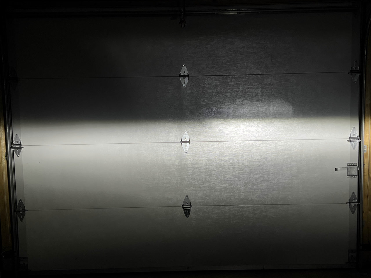

    Stock Sylvania 9005 vs Toshiba 9011 HIR1
    The legendary 9011 Toshibas impressively boost output by about 30%.

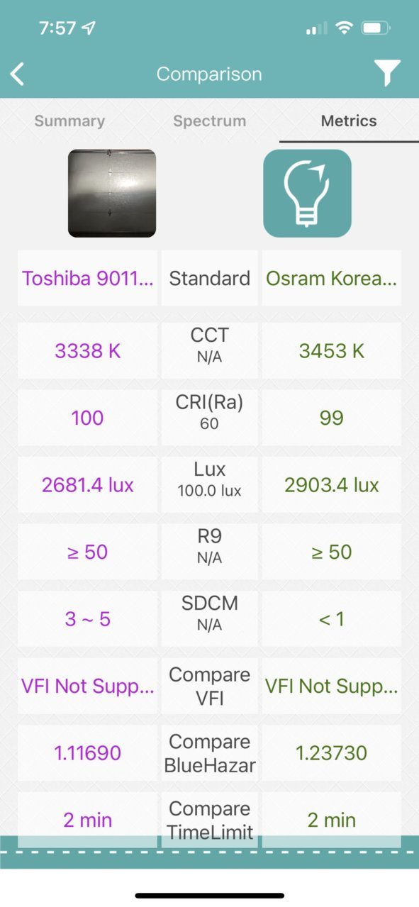

    Comparing the Toshiba 9011s vs the latest Osram Korean 9011 HIRs
    The newer Osram Korean 9011 HIRs are good for about an 8% output intensity gain over the legendary Toshibas, which is very similar to the results seen in the 4runner high beam. And they are about 41% higher output intensity than the stock 9005s. Note that the latest Osram 9011 HIRs are from Korea, packaged as Sylvania. There are also older Sylvania/Osram 9011s made in Germany. You need to physically check the bulb to ensure you are getting a Korean one for the best performance gain.

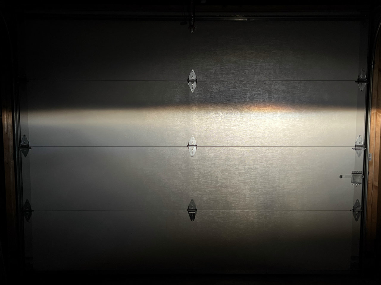

    Forgive the slight beam horizon tilt in the following photo. I hadn't designed my setup for Odyssey lights and they were a bit challenging to level two lights to the same plane.
    Aftermarket TYC assembly left vs OEM Right
    Interestingly the TYC projectors have a razor sharp cut off compared to OEM, that isn't actually a good thing. The TYC units also lack proper uplight, having just a tiny region above the hot spot that could hardly be called uplight, while the OEM projectors cast a soft uplight over a much larger area. The TYC projectors also lack light in the lower part of the pattern, meaning there will be a lack of foreground light. While you don't want an abundance of foreground light in your pattern, you also don't want a complete lack of it either.
    Output intensity was actually impressively close.
    OEM Tungsram Platinums vs TYC Tungsram Platinums
    OEM comes in just slightly higher in output intensity. In this case the real benefit of OEM performance is the better beam pattern with more uplight and appropriate foreground light, both missing from the TYC product. Although the OEM units will also likely last much longer in terms of resisting hazing and seal breakdown allowing moisture in the assembly as well.

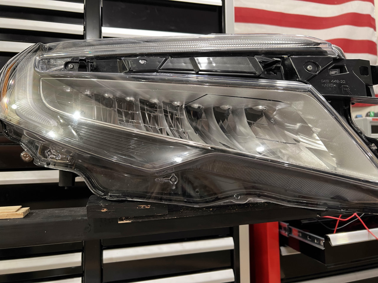

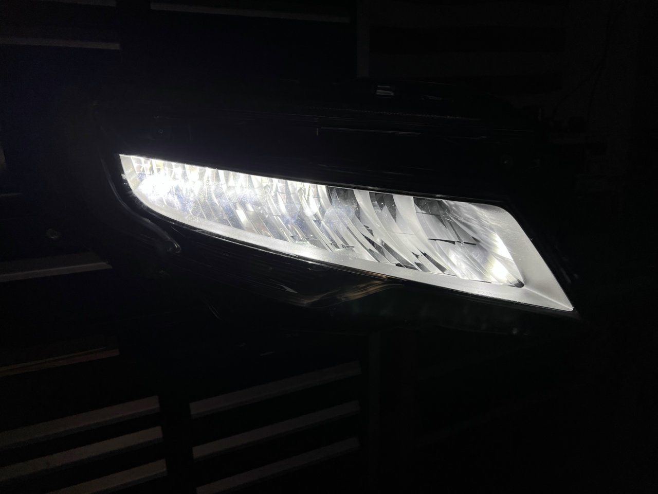

    OEM LED
    The OEM LEDs are a reflector design like the Tacomas, using 6 low beam emitters and 3 high beam emitters.

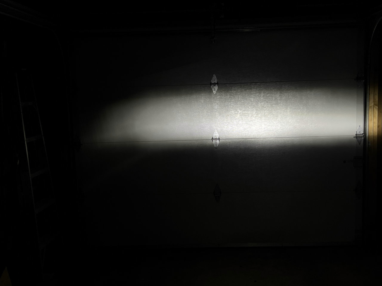

    Low beam
    Low beam pattern
    The OEM LEDs have a good hot spot with a very wide pattern spread and appropriate uplight with an interesting region just above the hot spot cut off of slightly higher uplight intensity. They are the automotive industry standard 6000k.
    OEM LED low beam pulls 1.81A, about 25w
    Compared to stock these are a big upgrade.
    Osram Standard H11 vs OEM LED
    Nearly an 82% output intensity improvement over a standard bulb, while having a wider high intensity pattern spread.

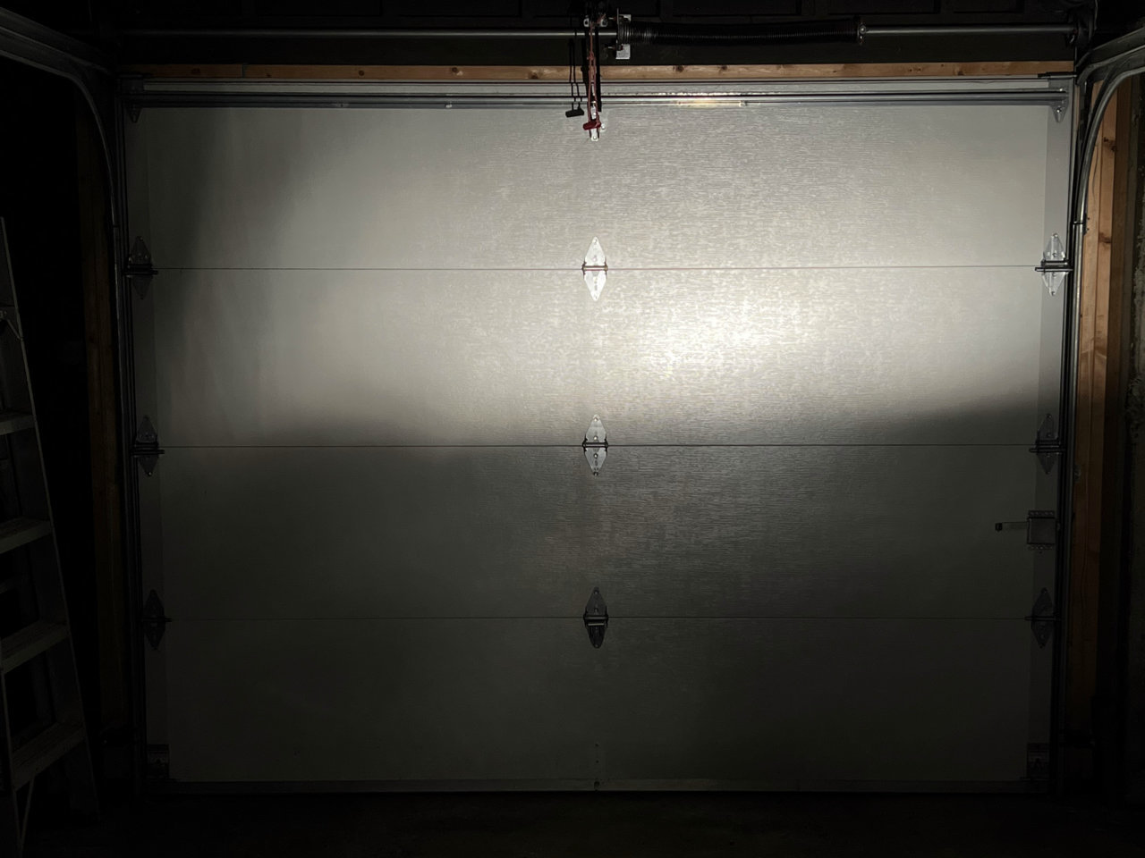

    OEM halogen high beam
    OEM LED high beam
    While the halogen high beam has a broad flood, the LED high beam is surprisingly very small in focus, targeted toward down road distance, but not the broad visibility offered by the halogens.

    Stock Sylvania 9005s vs OEM LED
    This was pretty surprising. The OEM halogen high beam is about 16.5% higher in peak intensity than the OEM LEDs, while also illuminating a much larger area. But that is with stock bulbs.

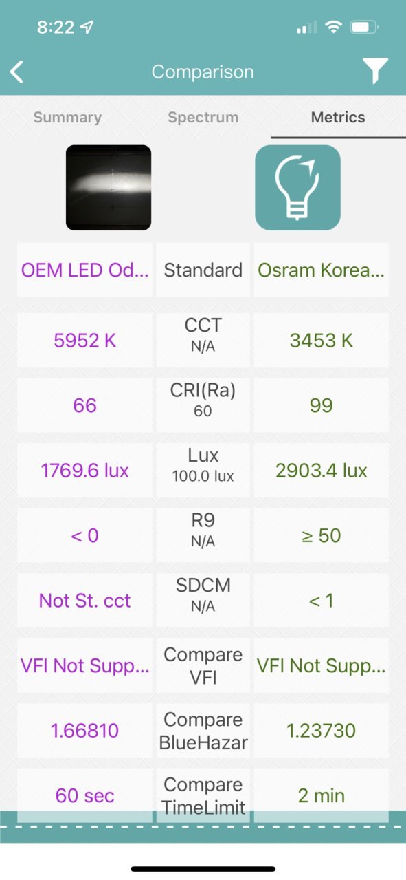

    OEM LED high beam vs Osram Korean 9011 HIRs
    Wow, the Osram Korean 9011 HIRs come in 64% higher in output intensity than the OEM LEDs while illuminating a much broader area.
    The Tacoma OEM LEDs were superior to the halogen units in both high and low beam, even with the best halogen bulb upgrades. That isn't the case with these Honda LED units, the OEM LED low beam is a little better than the best bulb upgrade but the high beams are worse than the stock halogen high beam, and significantly worse than a halogen high beam bulb upgrade. For Honda Odyssey owners, OEM LED may be worthwhile if you rarely use your high beam and its performance is not important. But a simple H9 bulb swap will get pretty close on the low beam performance, though keep in mind bulb performance does degrade over time. And a 9011 swap on the high beam will provide drastically superior performance to the OEM LED high beams.
