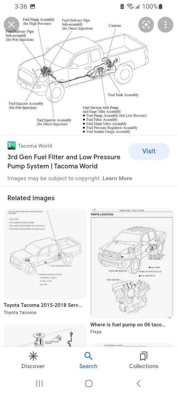

    It's inside tank buddy

    Just to clarify, the only fuel filtering in second and third generations is accomplished by the in tank pre-pump strainer? Can this be purchased separately from Toyota?
