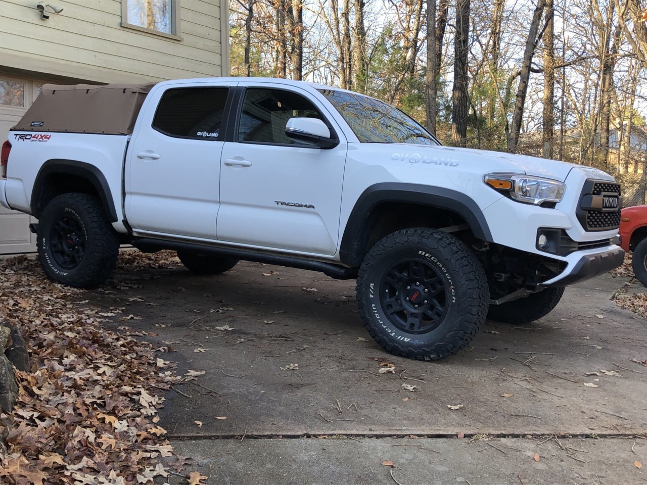

    I decided to cut my bumper and people seem to like it. I took some photos along the way and will share them to help others navigate the process a little better.
    First though, I was sent this video right after I had cut off the driver side bumper and it helped me feel confident in what to do with the inner liner and other clutter. He did a slightly different cut, but it's still very helpful:
    Here's the finished product:

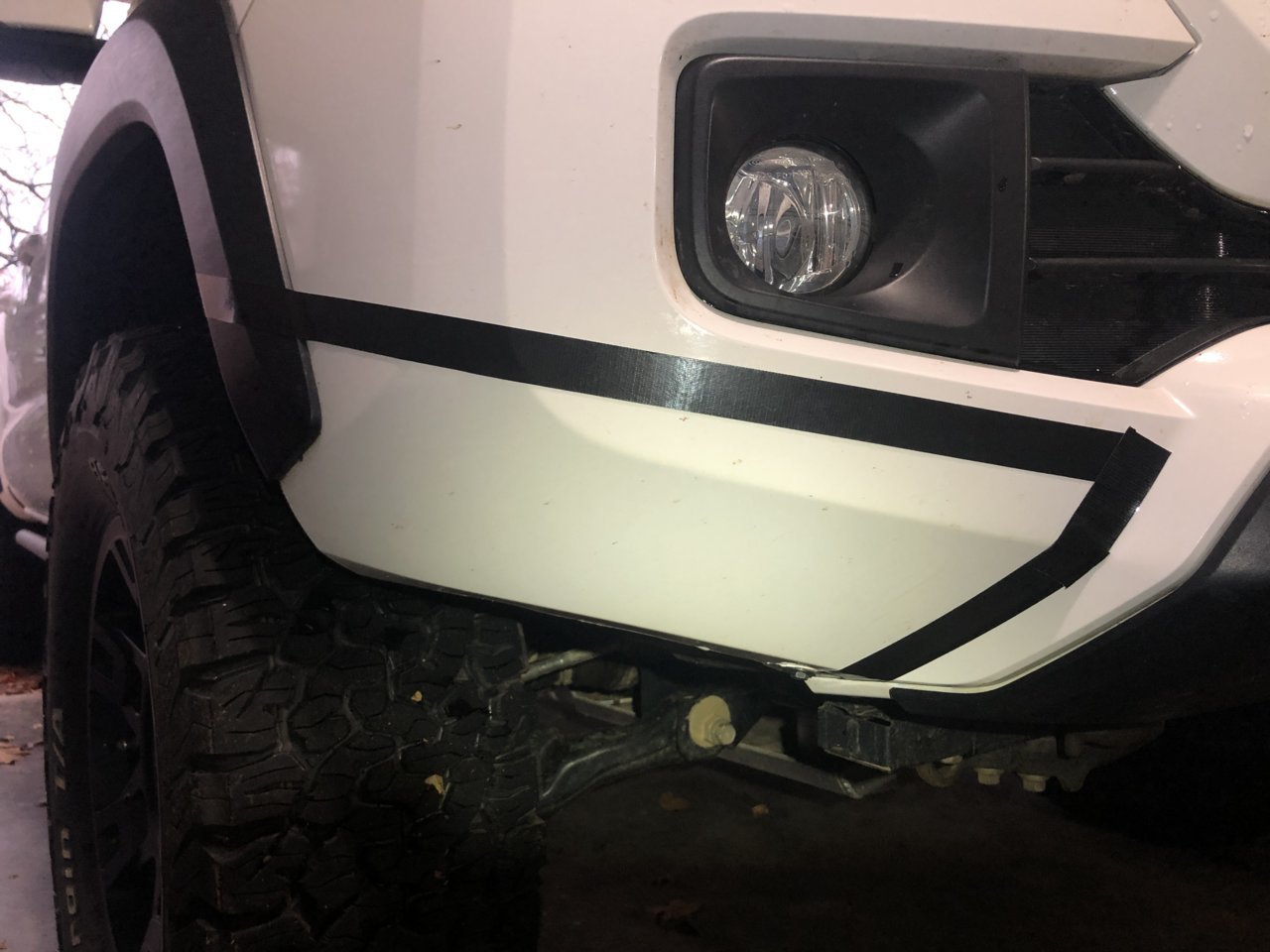

    Taping. I taped to get the general lines as straight and aligned as could be, then I penciled it on the bumper and removed the tape. I didn't try and draw the curve, I did those by hand with the dremel.

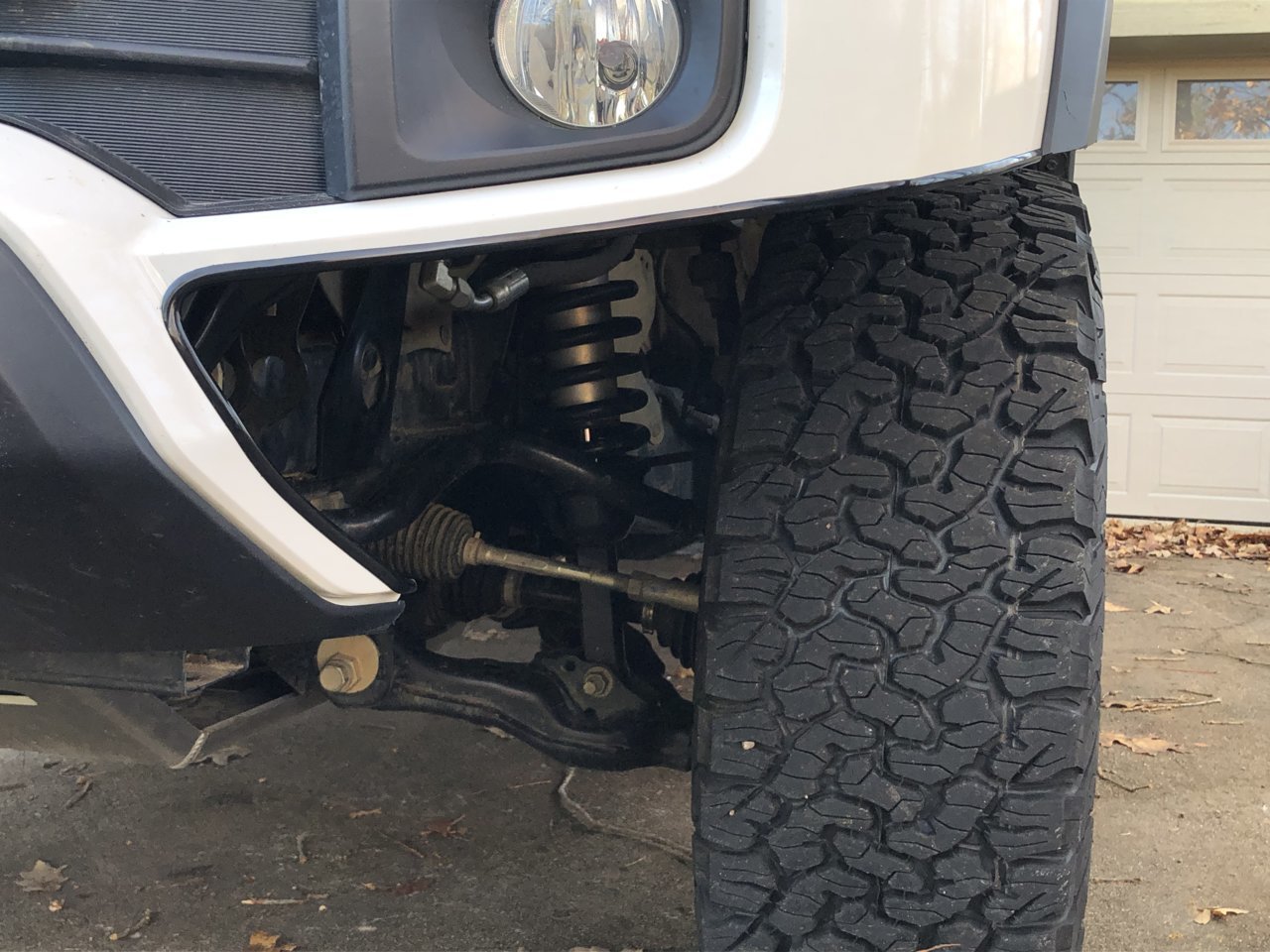

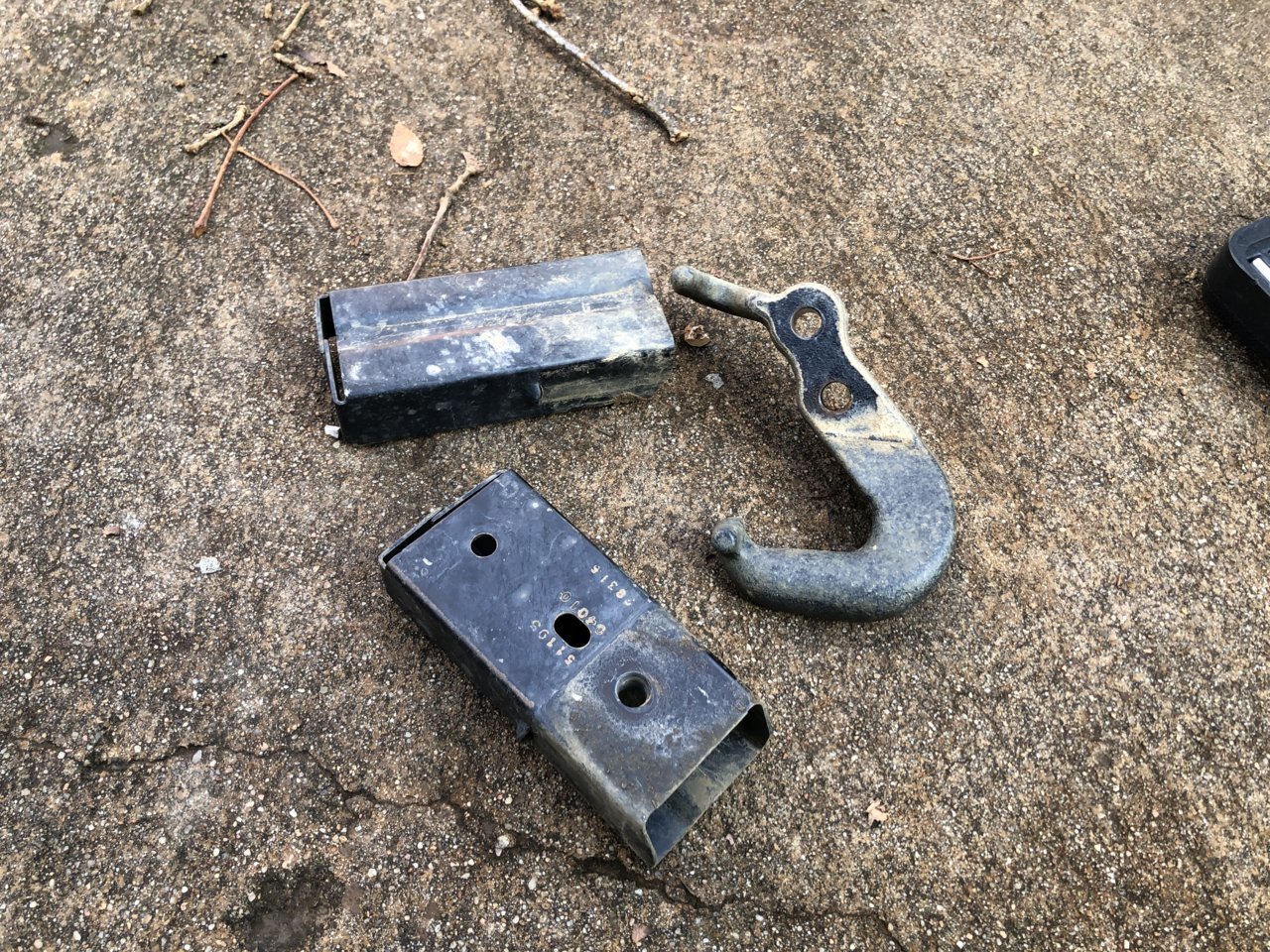

    Decided to clear out some clutter behind where I cut. This is about a 4" extension of the bumper beam and is held on by that first bolt you see.
    Removed those on both sides. You may not be able to see in the image, but this is a big step in making this look intentional and not odd.
    Then you get to this support bar. Where it is attached to in this pic is gone, so it was just hanging out in space.
    I just bent it up and out of the way for now. I cleaned it thoroughly after this pic which really helps it not stand out and look a little cleaner from the side.

    The finished product again. Hope the helps!

    Hang onto those bumper inserts because there's a captive nut inside that you need to mount bumpers in the future. I suppose you could just thread a nut from the inside instead. Another option would be keep it, cut it, fold it, weld it, and then you'll have a more sturdy insert plug for the captive nut.
    You may want to keep the hook, hardware, and a wrench in your under-seat storage for if you get stuck. Without a plate/tube bumper, you don't have any real forward facing recovery points.

    Those have gone into the "old parts that will likely be useful in the future" box. Thanks for the heads up.
    There is a good recovery point in the same place on the opposite side of the skid plate. It's a big loop that I use in recovery situations. I could be wrong (it's happened before) but the only time I could see using the hook I took off is to spread out a strap load across two points in the front to get a better pull angle. But I've never had to do that before. I wouldn't snatch or be snatched off the hook because the rope could easily just slip off.

    That is your transportation hook, not a recovery point. It's not rated and will snap eventually.

    Well damn, the more you know. Thanks for pointing that out. I never thought twice about using any loop or hook on the front. I'll either put the hook back on or replace with something like this for the time being: https://www.bpfabricating.com/products/tacoma-recovery-tow-hook
    I'm going to remove the picture above with the hook so people don't follow my lead and pull that off.
