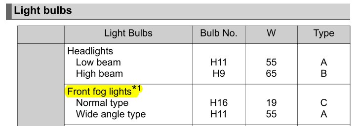

    The Toyota Tacoma User Manual shows this:
    The wattage is considerably different, as is the light pattern.
    I have not checked to see if the base configuration is the same or different.
    My truck is still in the manufacturing process, so I can't check the existing bulbs.
    Anybody have good data for a "base" SR5?

    I may be answering my own question ... here is a blurb from the Toyota Tacoma e_brochure:
    Projector-beam headights with turn Daytime Running Lights (DRL) and integrated fog lights [standard on SR5]
    Projector-beam headlights with LED Daytime Running Lights (DRL) and integrated wide-angle fog lights [standard on TRD Sport & TRD Off-road]
    So, if you have a base model SR5, "the book" calls for an H16
    If you have a TRD Sport or OR, "the book" calls for an H11
