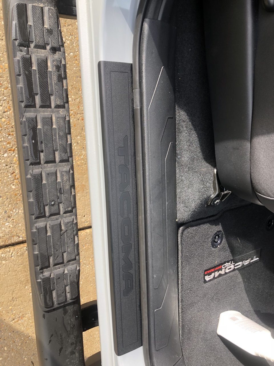

    Once they are clean I put them on dry (leave sticker back on) to get an idea of where I wanted them. On the back I measured 1.5” from the back of the door plate and on the front I aligned the front of protector with the first line on the front of the door plate. I was happy with the placement so time for install.

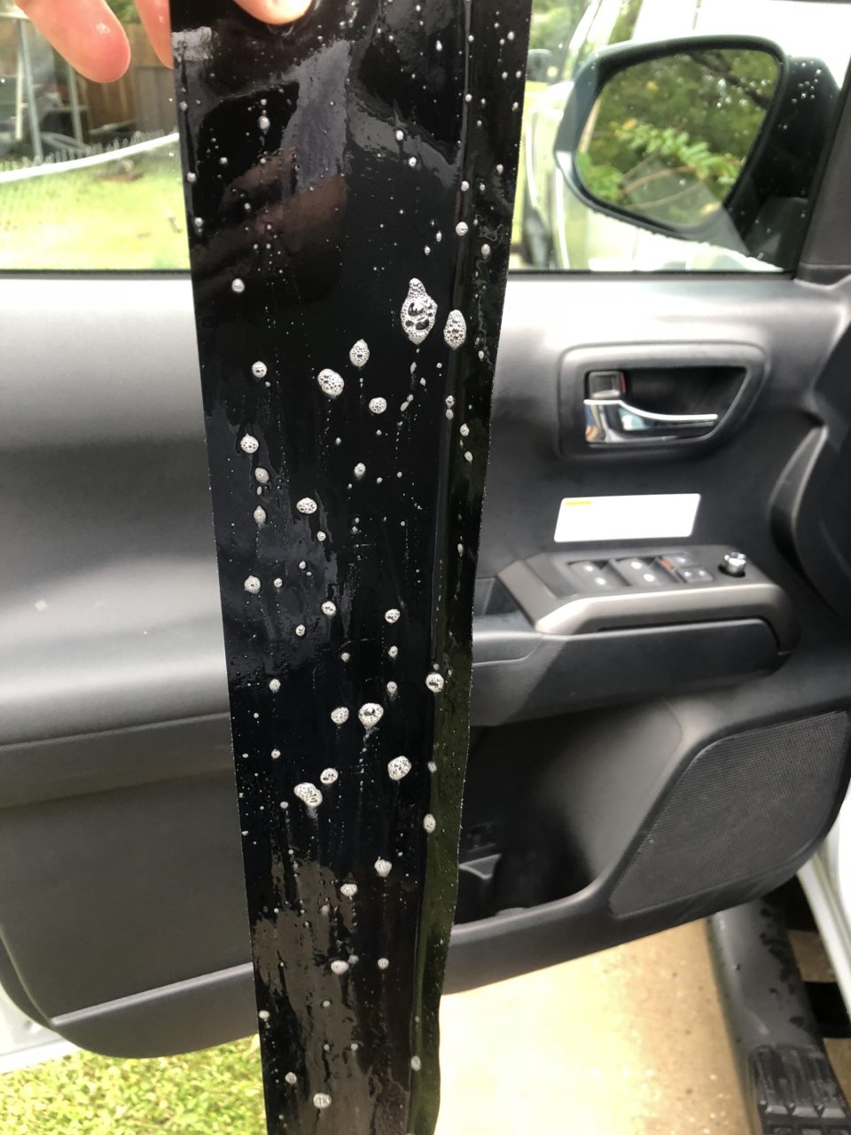

    Next peel the back off the protector and soak the sticky side with solution

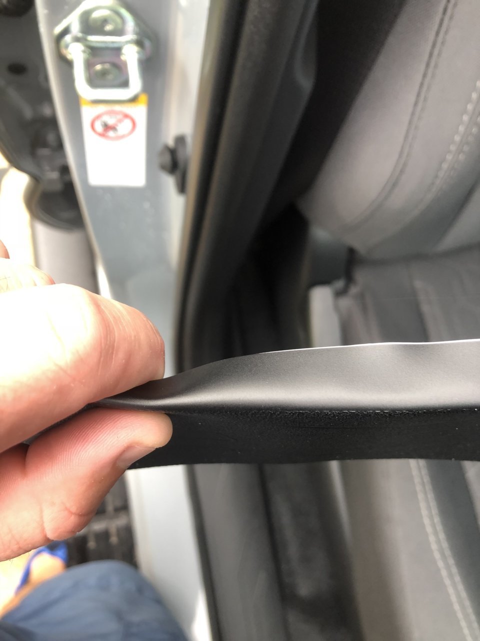

    I will tell you I found it much easier to pre bend the protector before installation. It made it much easier.

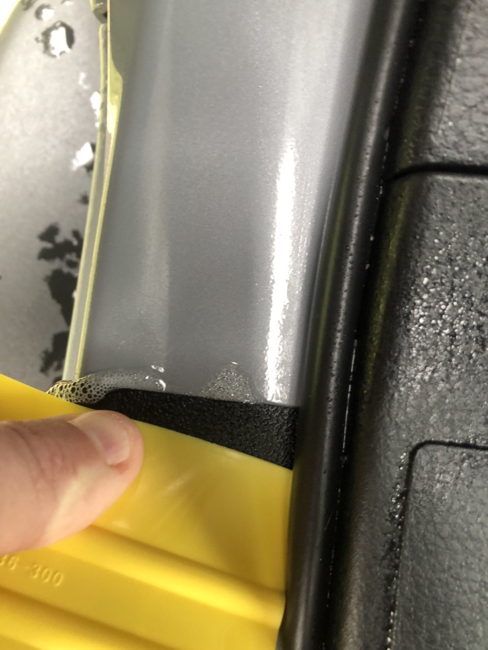

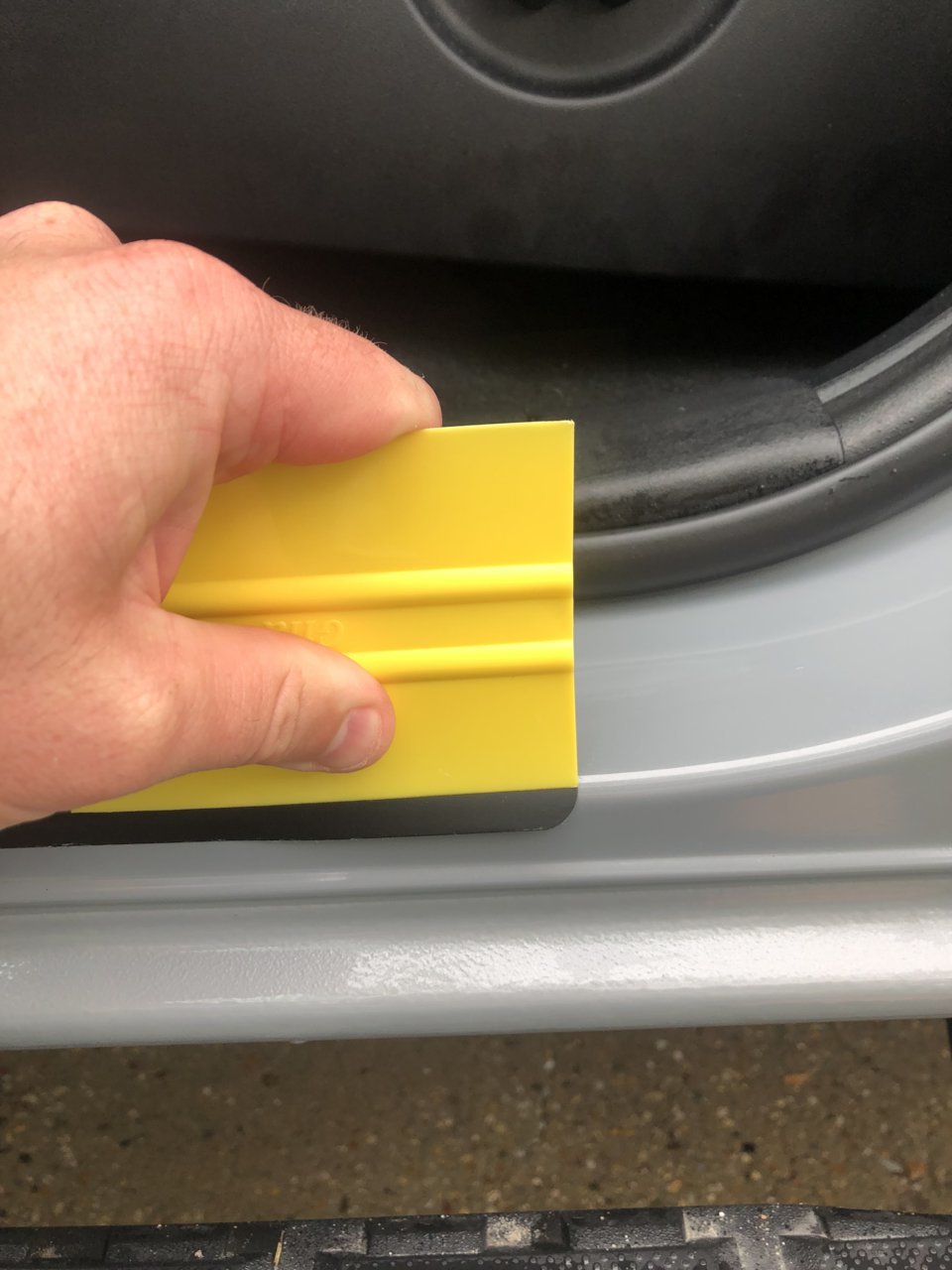

    Now once you have it in place start to squeegee the water out.

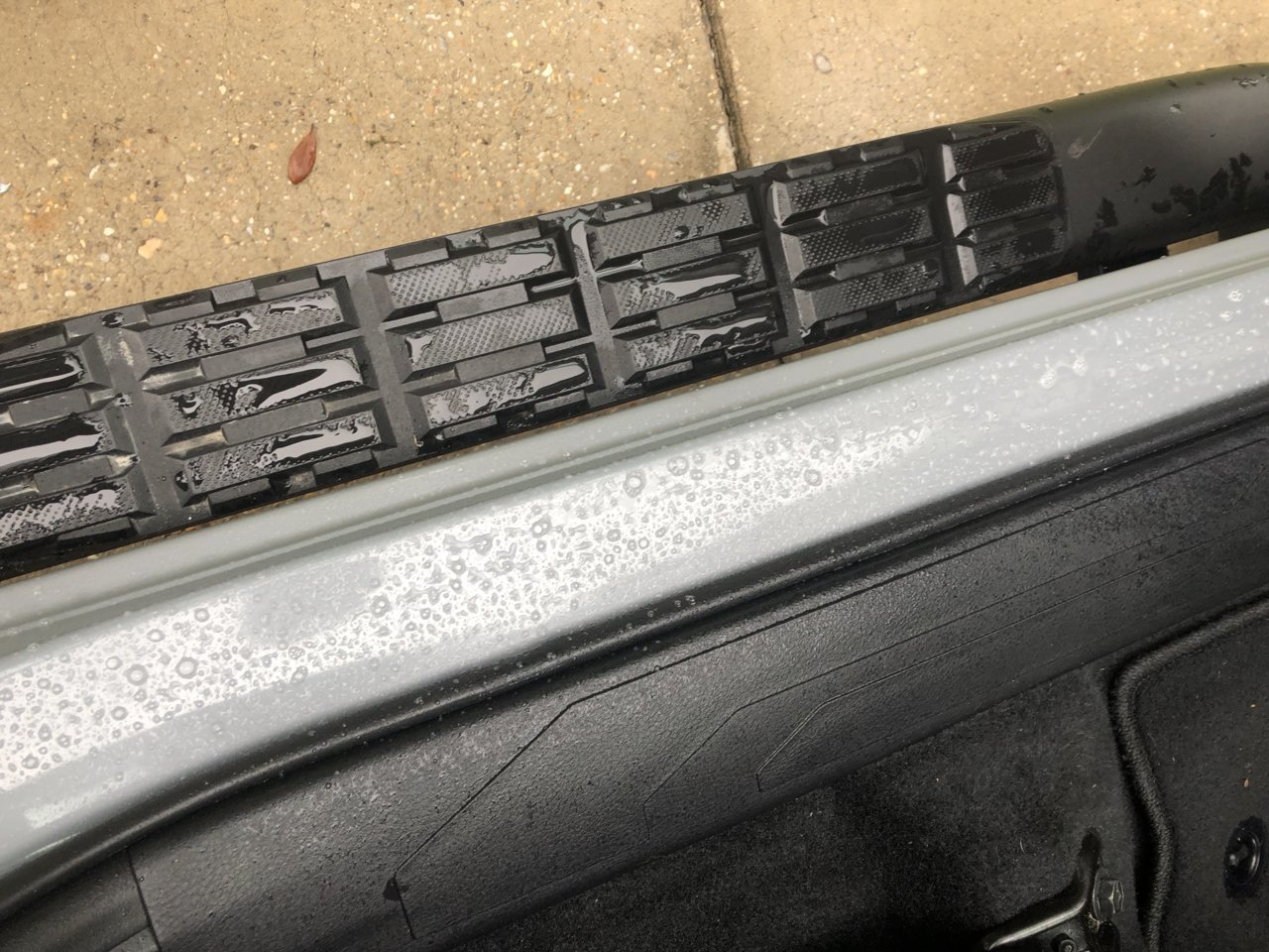

    I started at the center and worked my way out on the top first. Make sure to wipe up water after every pass of the squeegee.

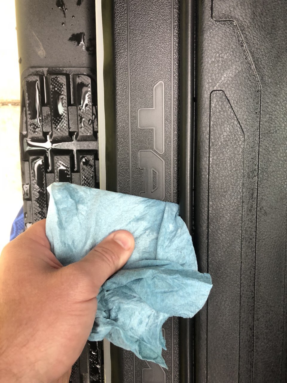

    Once you get most of the water out it works best to wrap the squeegee in the paper towel and squeegee to collect most of the water
    Once you have the top pretty much stuck, now comes the hard part. It was a PITA to get the bend down part to stick. I found it easier just to use the paper towel and my thumb and index finger rubbing back and forth to get it to stick most of the way. Once it’s stuck you can squeegee down the rest of the water out.

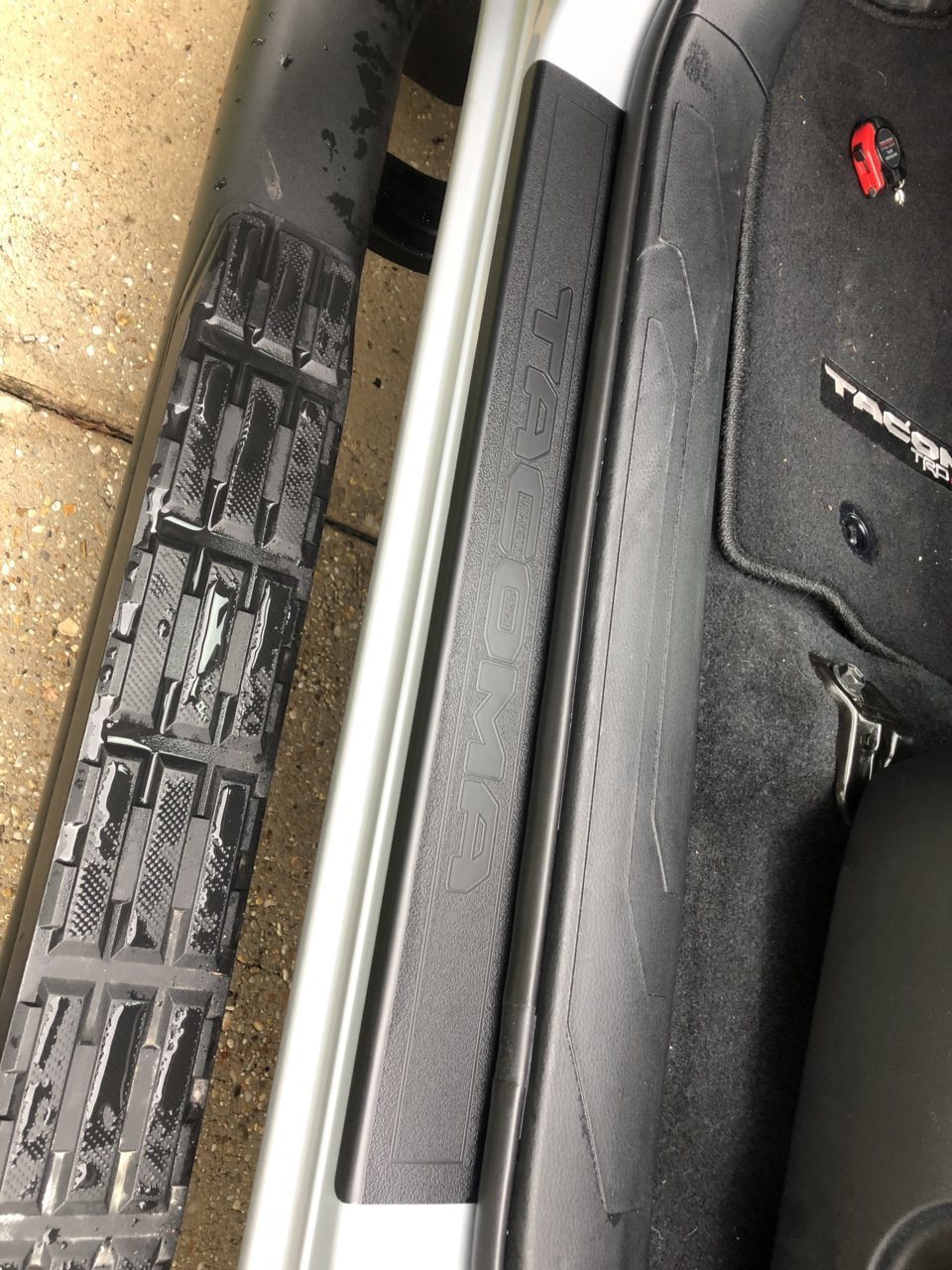

    Now that it’s stuck. Clean up the remaining water and close the door. ** make sure the edges are stuck before you close the door!!
    Try not to open the door for 24 hours. If you do just keep an eye on them to make sure corners don’t pop up. They turned out great, and I’m very satisfied with the outcome.

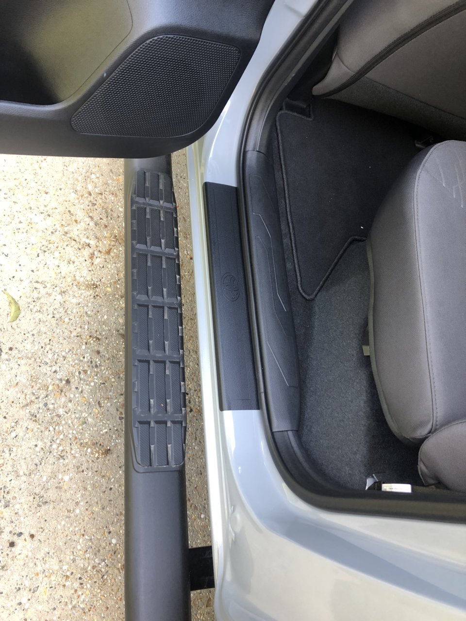

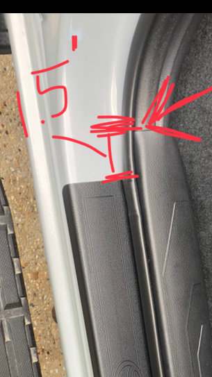

    Here are the rear protectors. I measured 1.5” from the rear of the door plate.
