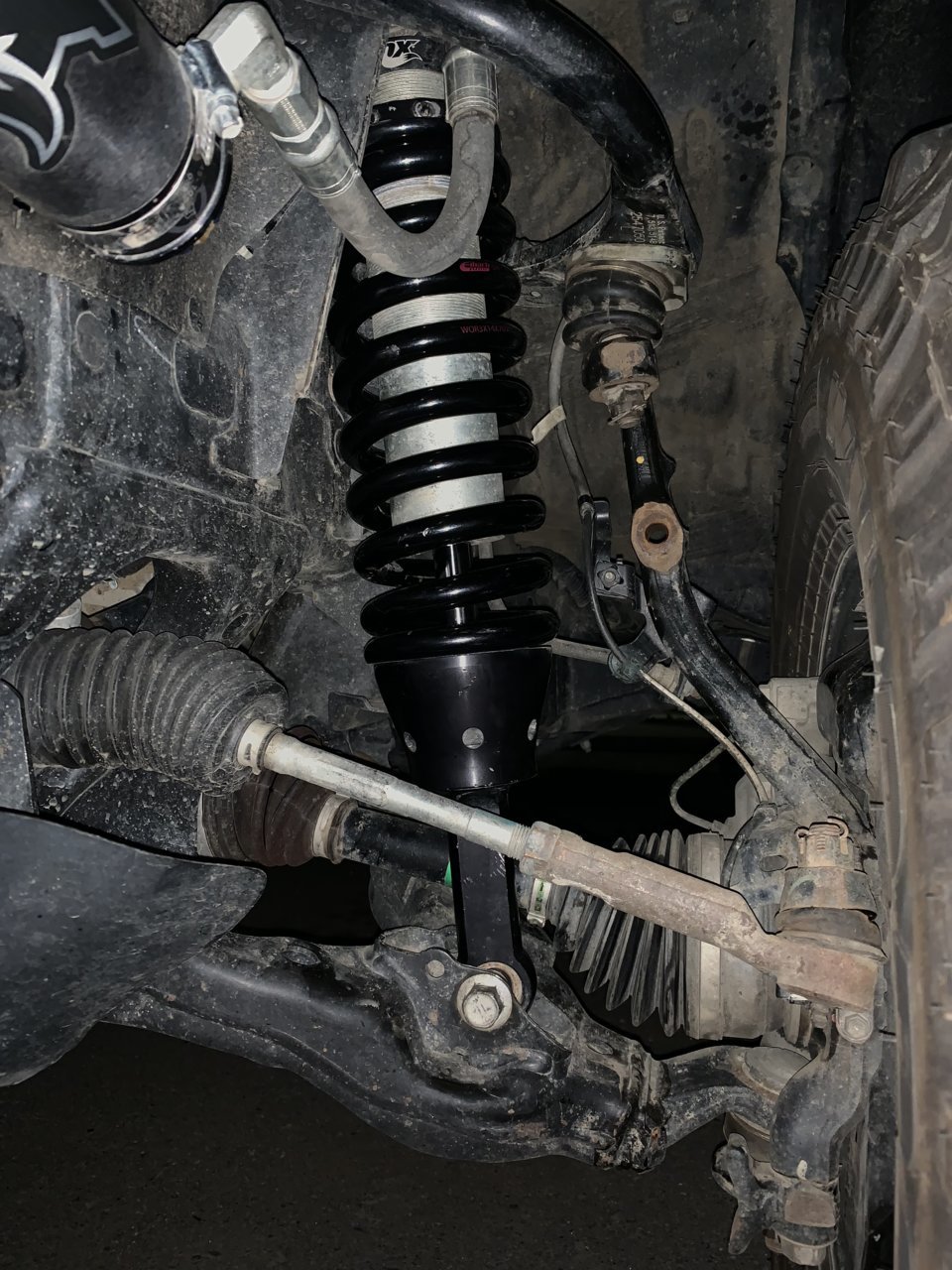

    555A2742-621C-4A05-BB2D-2C974DE055E6.jpg 2623D83C-62D8-47D3-8F27-010C88B1B785.jpg
    It’s not that bad, but I haven’t gotten a wheel alignment either, yet. Will it help? Or will a diff drop kit help in this case?

    Those angles look bad without a drop IMO. Your boot ribs shouldn’t be touching

    My CV angles with the diff drop.
