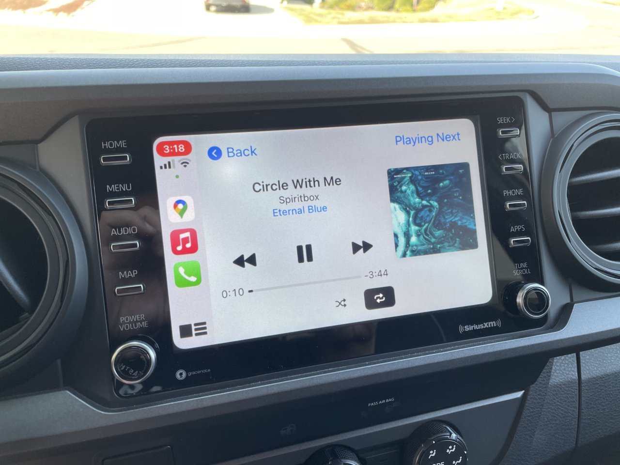

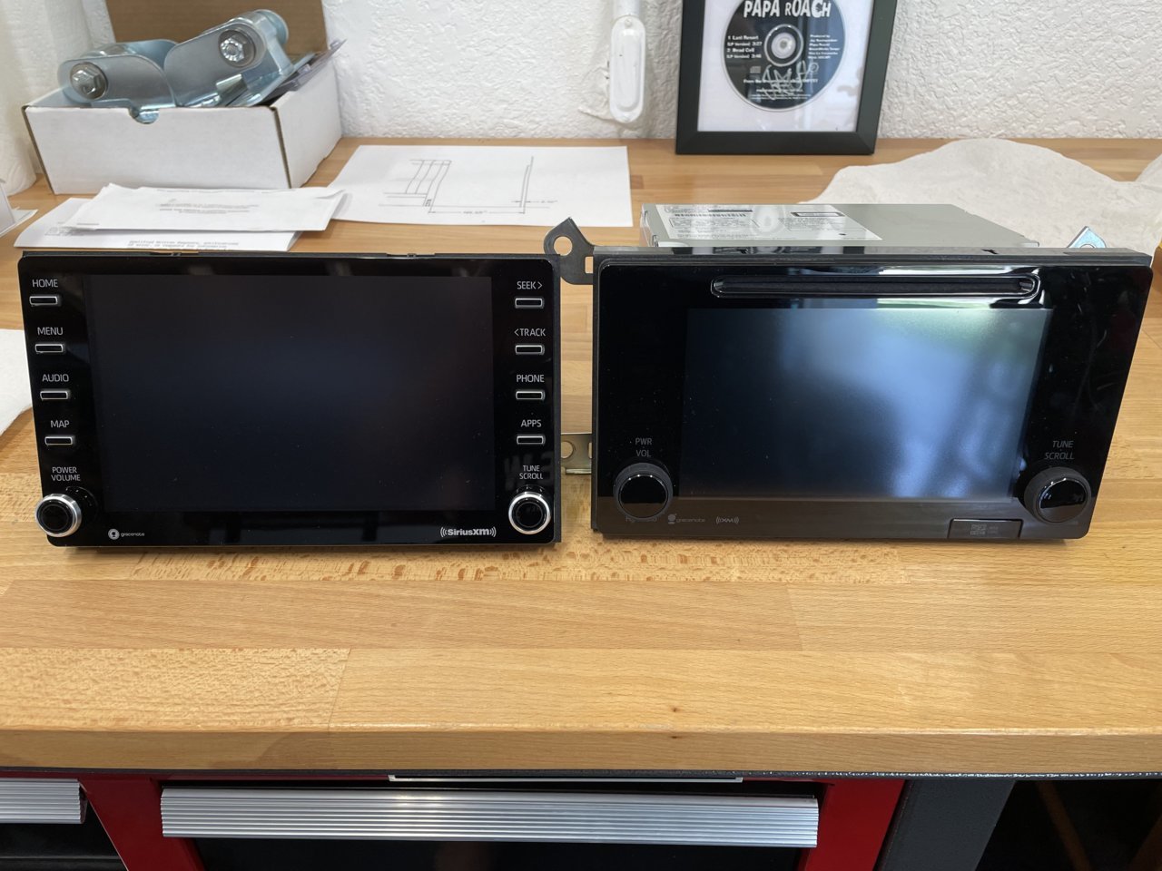

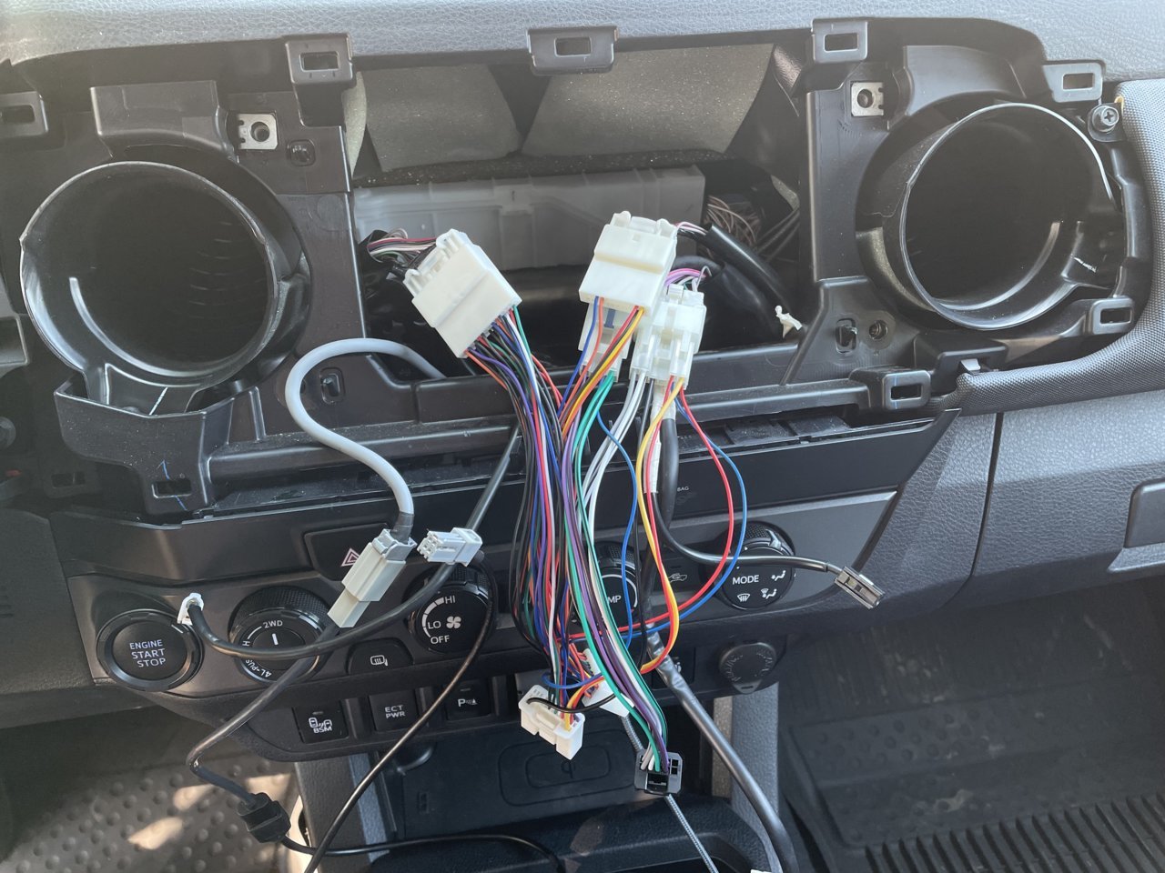

    I did the swap on my 2019 to a 2021 headunit with apple carplay. All it needed besides the new headunit was a harness to get all the connectors to plug into the new unit. Everything functions as it should.

    Autoharnesshouse.com. I don't think it's listed on their website, but if you contact them they will gladly make one for you. Super high quality.

    The harness was about $160 and I bought the head unit used from the classifieds.

    Yes. Everything functions as normal.

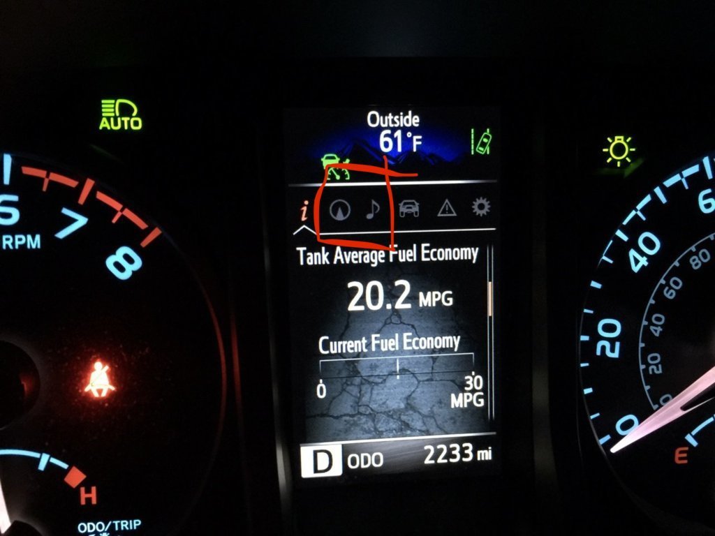

    one question I had, does display in the instrument cluster still show the now music and navigation screens?

    for others interested, I have confirmed that the instrument cluster screen retains all the original screens as before after upgrading from entune 2.0 to 3.0

    does anybody have an idea of what other model Toyota puts that head unit into? Or how one might find out?
