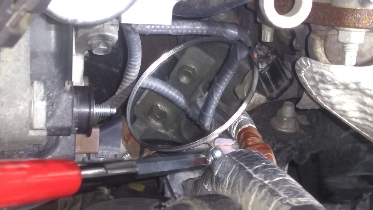

    The 270 amp DC Power Inc alternator is missing the two attachment points on the side to hold the plastic box that has the cables coming from the output (+). Also, the LIN plug faces outward instead of toward the rear like the Denso alternator. This doesn't sound like much, but there is little play in that wire and plug. It will need a couple more inches to turn the corner and get plugged into the side of the alternator. The wire that goes to that plug is [firmly] attached to a bracket on the engine that isn't easy to get to. The two bolts on that bracket aren't easy to get to either. They're both 12mm heads and seem like you're reaching a quarter way under the engine just to get to them, but cannot see them while you're fumbling around in a tight spot with almost no room to swing the ratchet, even if you get the socket onto the head of one of these two bolts. One bolt goes forward through the bracket into the back bottom part of the alternator, the other holds the bracket to the engine block. It's very tight. If you have very long skinny arms, it might seem easier.
    The new DC Power Inc 270 amp alternator will not use that bracket, nor will it have any rear attaching hardware on it. It's held in place strictly by two bolts (they provide) into the front of the alternator. There is no rear pork chop on the top either. It's completely missing.
    I called DC Power Inc, and they told me that I just have to find a way to attach that box (the one that attaches to the side of the Denso alternator via two bolts) to something else. I can't see a way to attach it to anything without significant engineering and creativity.
    Last, but certainly not least: If you have a 130 amp alternator, your 'Alt' fuse (bolted in fuse inside the fuse box) is rated at 140 amps. If you install this high output alternator, you will be forced to add a thicker battery cable outside that, and fuse that separately if you want to go beyond 140 amps. This is absolutely an absolute crucial show stopper, if for some reason the output exceeds 140 amps. I mean, that is what you bought the heavy duty high output alternator for anyway, so it would be beyond foolish and myopic not to install large gauge cable from the output to the battery to avoid blowing that 140 amp fuse.

    Nations Starter Alternator resells DC Power Engineering alternators. The others besides DC Power Engineering, only offer gen 2 or before alternators.
