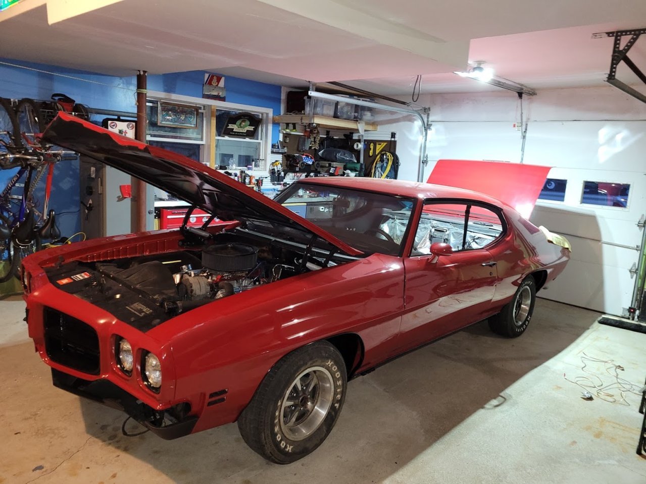

    First, a disclaimer. I have never worked with body filler or bondo, and have limited fiberglass-ing experience - but that was on boat repair. I approached my cousin Phil with a request to teach me how to use body filler and bondo in order to make pods for my truck. I showed him what I had, and he said "Ronnie, I'll do it, I owe you anyway, and it'll take you forever."
    Now my cousin Phil worked in autobody for 15 or so years and is pretty friggen meticulous. He just wrapped up his 1972 Pontiac Lemans project car - I did the audio in it for him - and the car is sweet. He does powder-coating, motorcycle painting, ceramic coating etc, all as a side hustle now, and works at a power company.
    The LeMans:

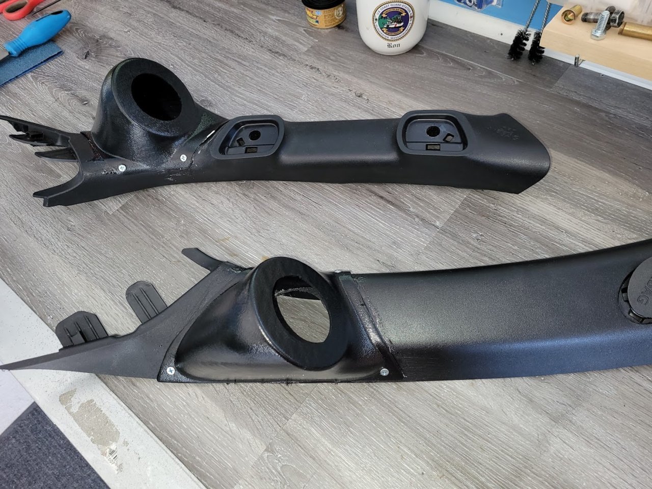

    Anyway, I left my project in his extremely capable hands. These pods were done the "easy way", as in the pods themselves are made by custom speaker pods dot com.
    https://www.customspeakerpods.com/product-page/a-pillar-tweeter-pods-for-3-5-16-21-tacoma
    The drivers (CDT ES2EX) I am putting in have a mounting diameter of 2.4", and CSP cut the hole for me. I epoxied then screwed them into a spare set of a-pillars:
    I removed the screws, and my cousin took it from there.
    More picture once they are installed later today with the drivers.

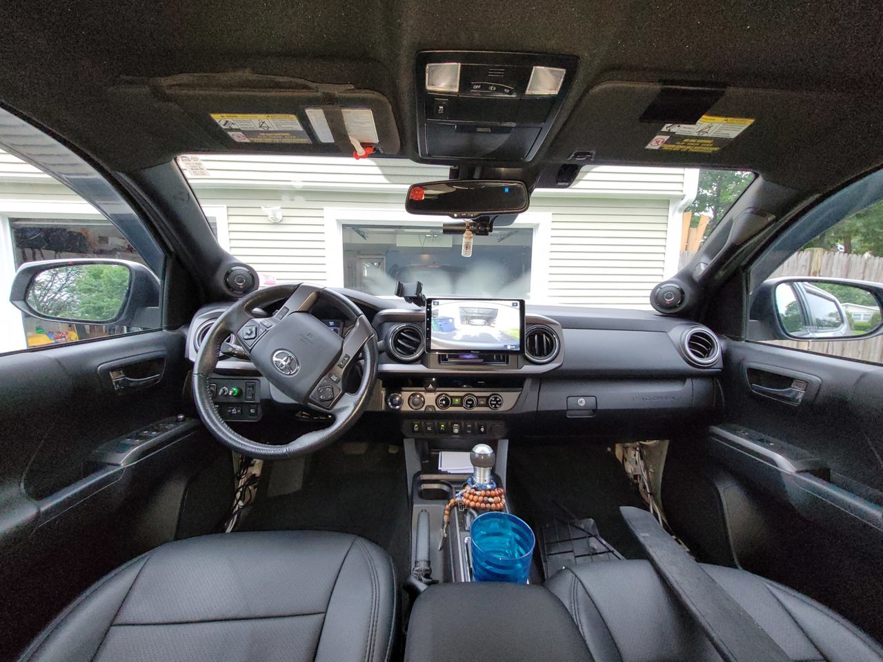

    Got some tuning to do but wow, what a difference 20210713_180103.jpg 20210713_180107.jpg 20210713_175950.jpg

    My system set up (I think this is like revision 8 or something) is:
    1. CDT ES-02EX wideband coaxial drivers
    2. Morel Tempo Ultra 6x9 drivers in the front doors
    3. Rear doors are empty
    4. JL 12TW3-D8 sub in a Mr. Marv box
    5. JL VX1000/5i amp
    6. Sound skins and Noico deadening
