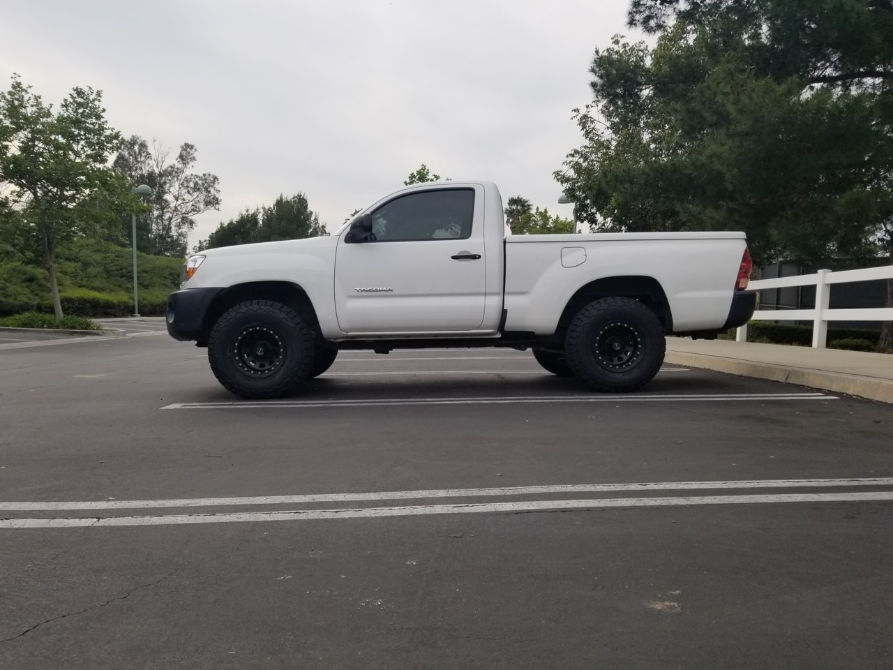

    Im going to be using 30x9.5 BFG Ko2's The wheels are
    Pro Comp 7069
    specs
    • Size: 15 x 8
    • Bolt Pattern: 5 on 4.5
    • Finish: Flat Black
    • Offset: -19
    • Backspace: 3.75

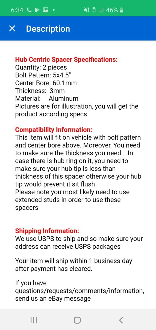

    I bought these hub centric rings, will these be okay to run? Screenshot_20200211-063454_eBay.jpg Screenshot_20200211-063440_eBay.jpg

    They fit bro, make sure you get a custom hub centric ring for the rims too they look so good

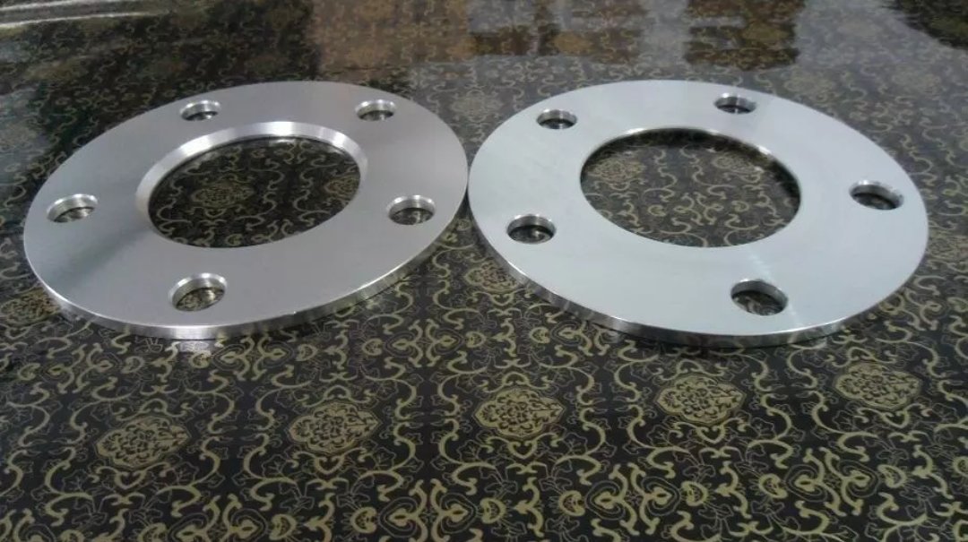

    Oh I see what your saying. I went with these from Titan Wheel Accessories
    3mm 5x114.3 Hubcentric Wheel Spacers for Toyota Camry MR2 Supra Lexus IS250 IS350 (60.1 bore) - Set of 2

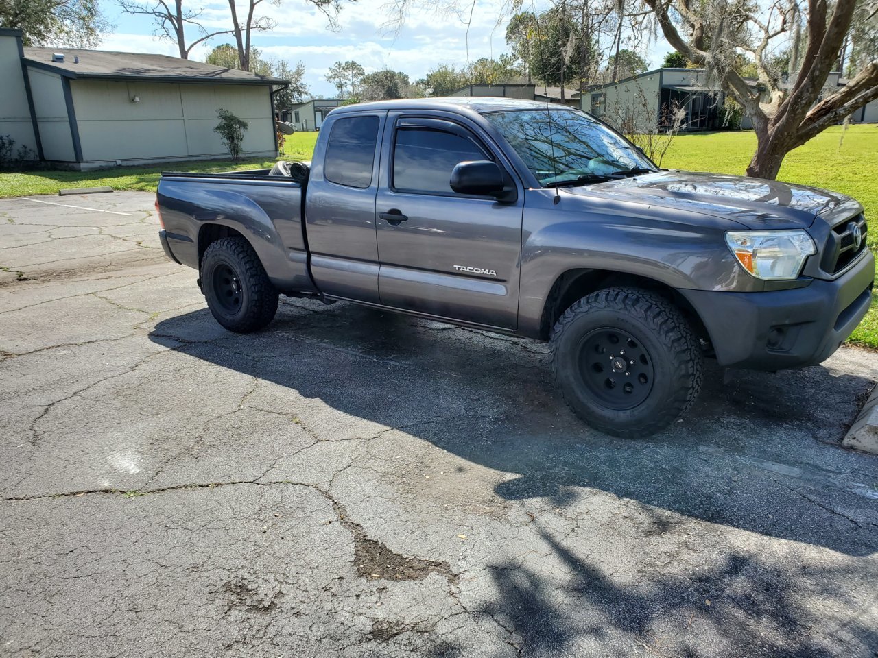

    If the setup is the same as mine it bites with 6+ turns also i used a tourqe wrench every 50 miles and snuged them to 90 ft pounds for about a week because I was nervous but now they are super solid just check occasionally with the spacers. Also ko2s are the best guys stopping power and grip is insane. 20200219_120924.jpg

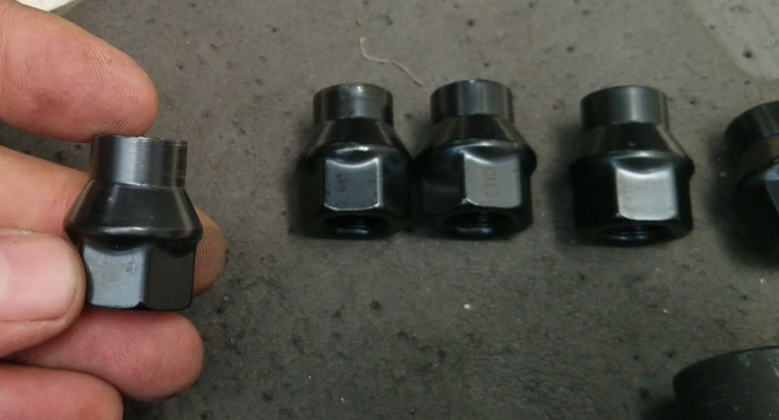

    I just went through this w/ my truck
    The factory lug nuts on fatory wheels have 9 turns
    I am using adapters on my truck and I only got 6 1/4 turns (I did not feel confortable w/ that)
    I ended up getting extended threads lugs nuts and they got 12 3/4 turns :)
    here is a picture of what they look like
