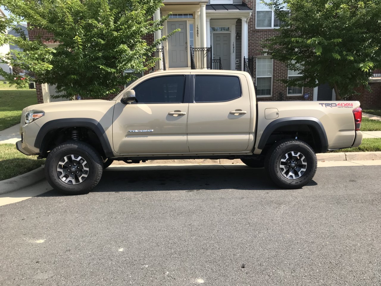

    Slammed on 16s
    Lift with 265s
    * 265/70 not /75
    Lift with 285s

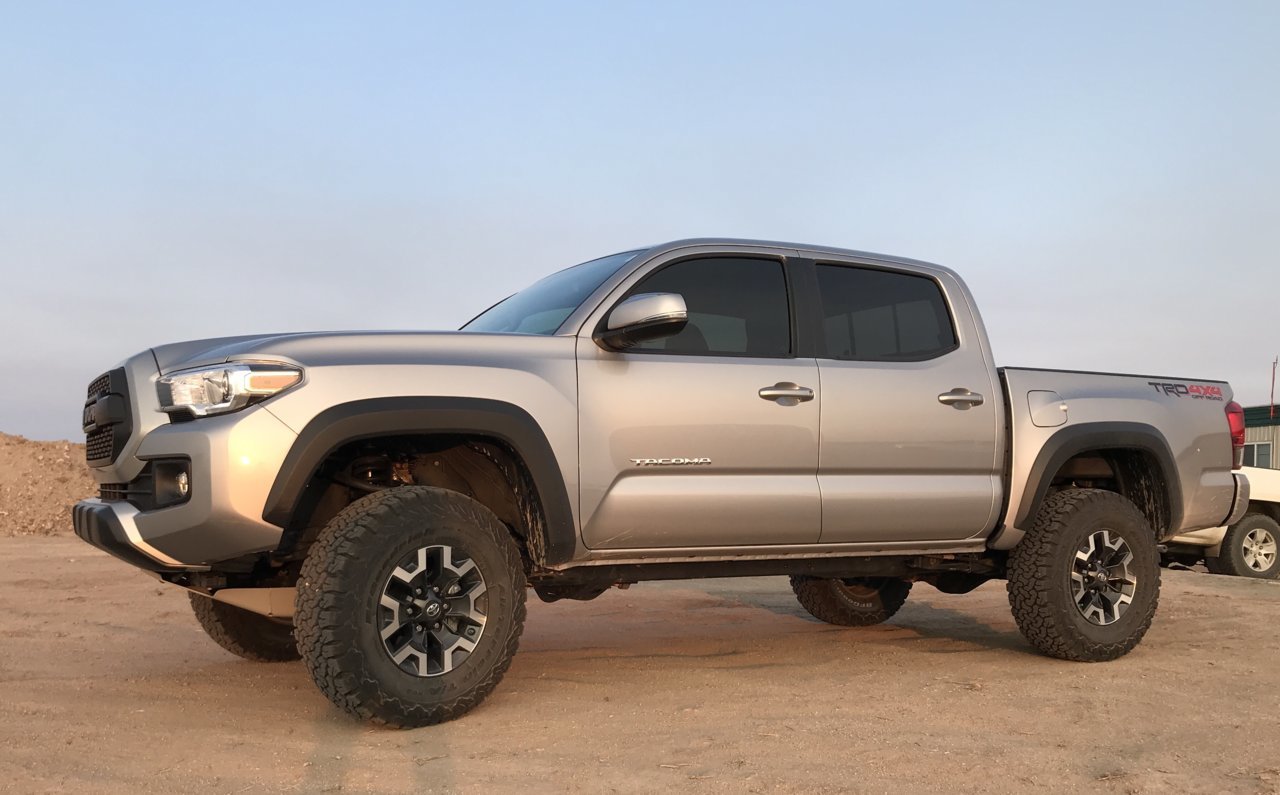

    F:OME Nitrocharger Sport 90021 w/888 Coils R:OME Nitrocharger Sport 60091 w/CSO47R Dakar Spring Pack
    This works for me. I have 2.5 + inches more suspension with a 4 corner OME kit. No spacers or blocks. I’m running 265 75 16.
    Sorry, Photo doesn’t capture the stance.
    I like the look and ride. Tires are noticeably, bigger than stock; but my goal is not to fit the largest tire possible. This just allows for a fully functional suspension and you won’t take a big hit in mpg or speedo error.
