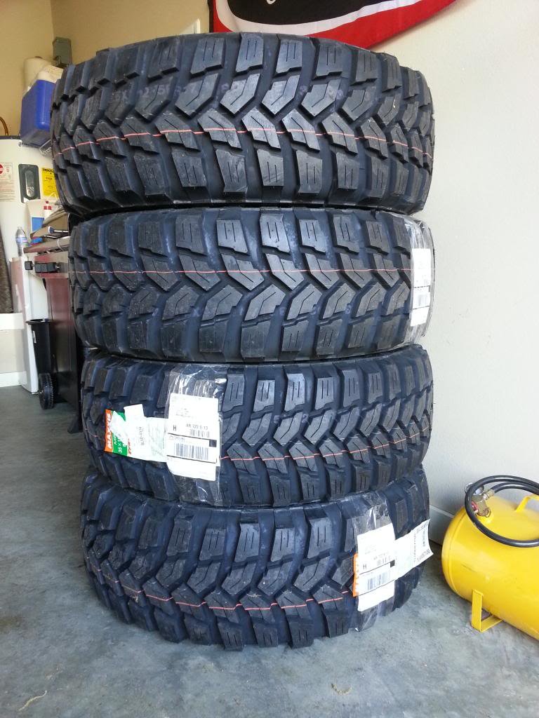

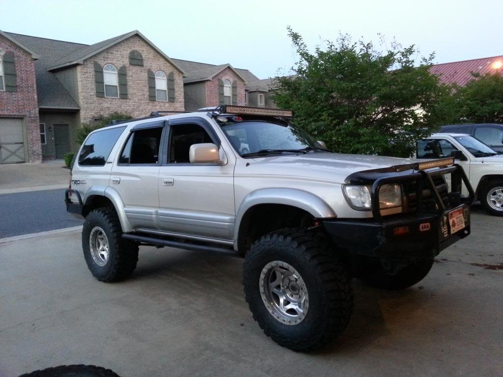

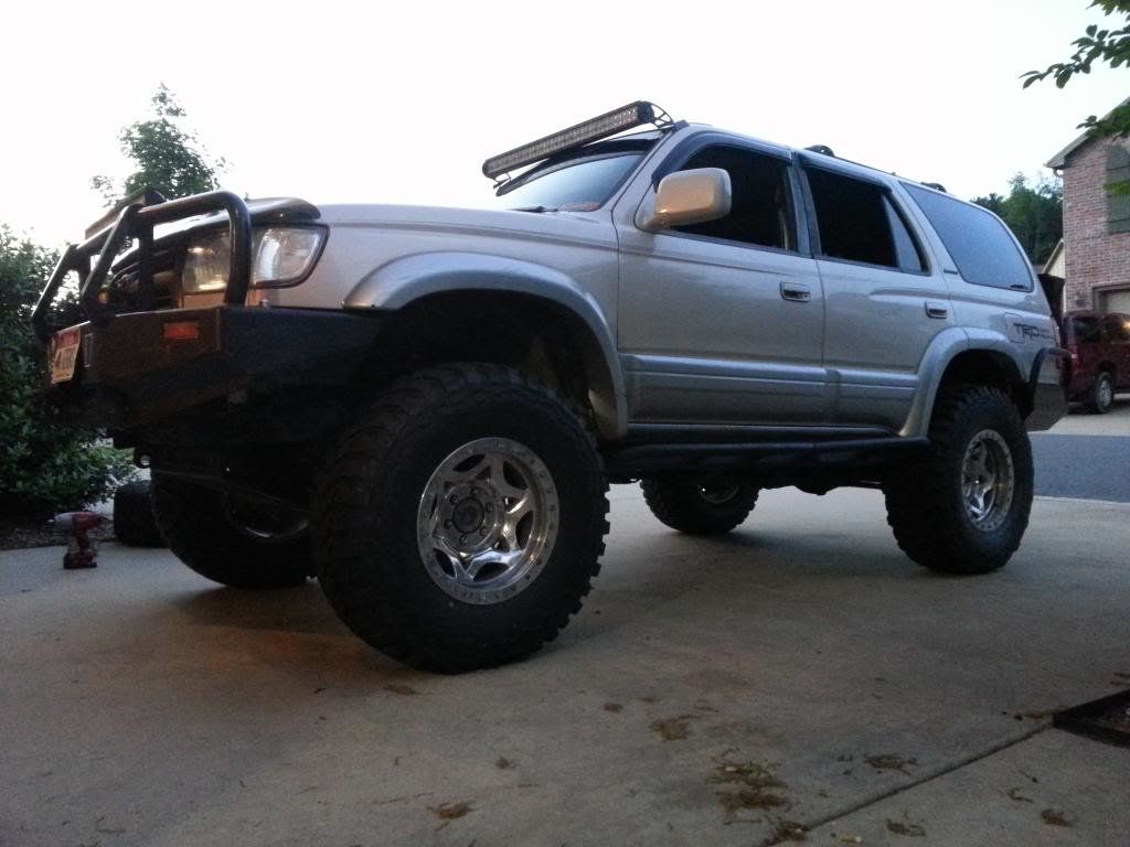

    Haven't seen much talk about these. Figured I'd start a review on them. I decided to go to a 17" wheel when I stumbled upon some Walker Evan Beadlocks for a good price. I took the plunge and bought them but also needed tires as I currently only had tires for 16's. So I decided to go against getting the MTZ's again (which I loved) and try something new. So, I went with the Maxxis Trepador M8060's.
    Tire Specs
    Actual Measurement: 34.65x12.6
    Weight: ~72lbs
    Ply: 8 (D)
    Tread Depth: 21/32
    Wheel Specs
    Measurement: 17"x8"
    Weight: ~40lbs
    BS: 4"
    Balancing
    8.5oz of .25g AirSoft BB's > Crosman Airsoft Ultra Heavy Ammo
    Installed
    Date: 05/11/14
    Mileage: 182,100 miles
    Initial Review/Inspection
    Tires look completely badass. They're very aggressive. Sidewall isn't too aggressive visually (especially compared to the big brother bias ply treps). The ability to be aired down in single digits however ought to make the sidewall stand out some more. They're also directional which almost screwed me up when mounting the beadlocks. Since they are directional I wont be crisscrossing the tires when doing rotations. I've narrowed it down pretty close to the sweet spot for psi on my truck after a couple chalk tests. 30psi seems to ride the best and use all the tread with little to no chalk left on the tires. As far as balancing goes, I'm still unsure. They ride pretty well. Only a little front vibe. I probably will end up getting them balanced, I just have a hard time finding someone who does a good job balancing heavy duty tires/wheels. I've read reviews that they have a stiffer tread. Comparing to my last tires, the MTZ's were a little bit more spongy from the beginning, but as hopefully the Treps will get that way after a few more miles. As far as stiffness on the road, I haven't really noticed too much difference compared to the MTZ's. They might be a tad stiffer but also will likely see better road manners when I get them balanced. They seem to be pretty quiet starting out, but again, mileage will tell that story. I haven't given them any real test offroad yet but that will change soon. In rain and slick conditions they seem to work well. A lot of forward travel with these heavy things so I have to be sure to give myself ample time to stop. The same went with my previous tires. Think that's pretty standard.
