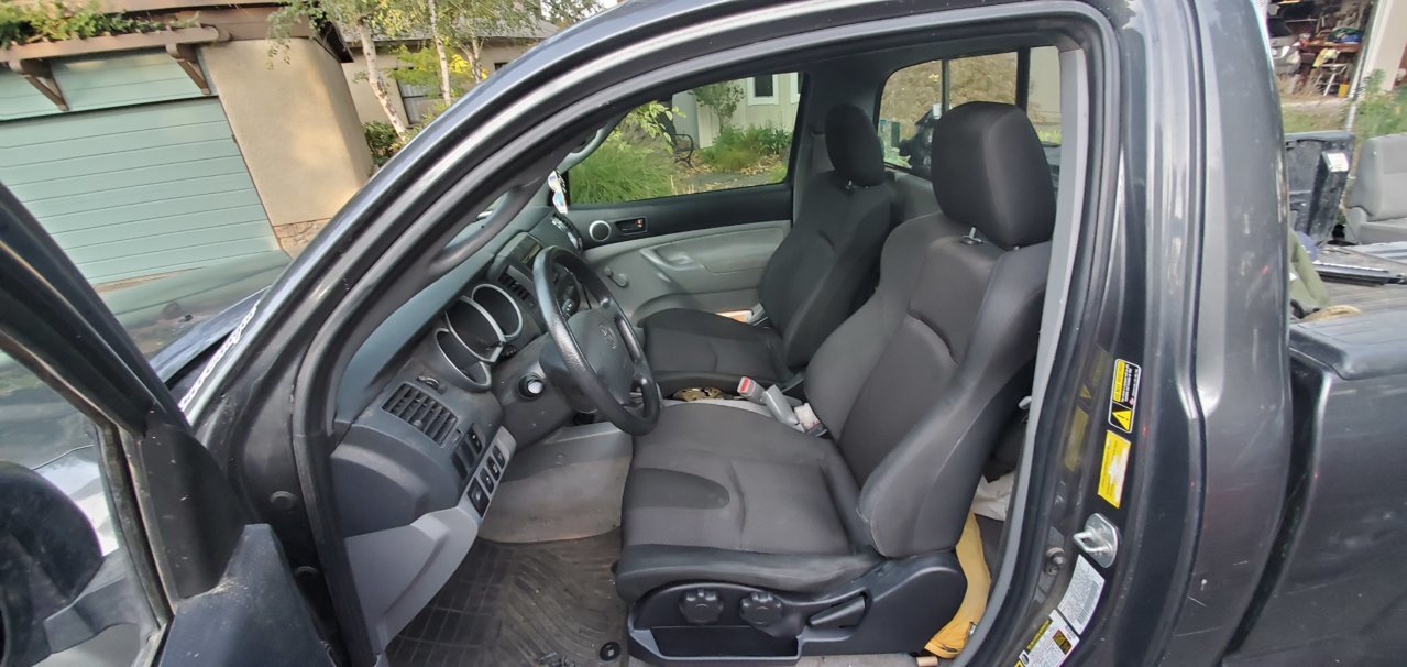

    Thread revival: They fit mint in a second gen regular cab.
