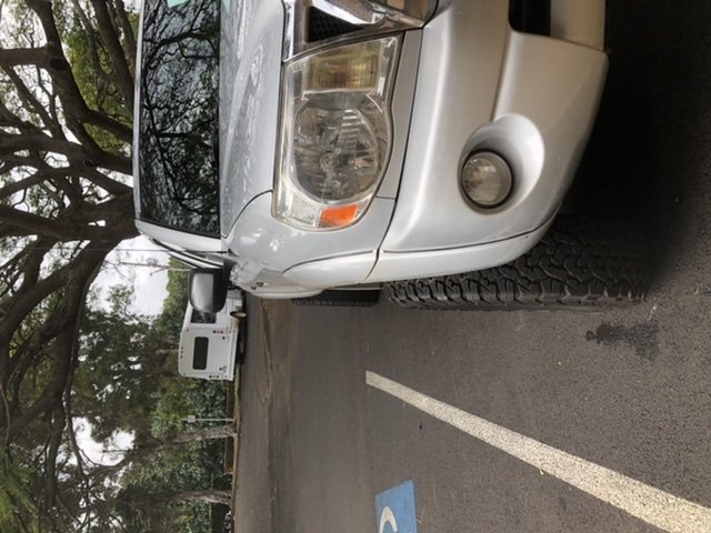

    Here’s a photo of how much my tires stick out...1D5E559D-7069-4D9B-ADEF-04991C79511D.jpg

    You truck looks sick!
