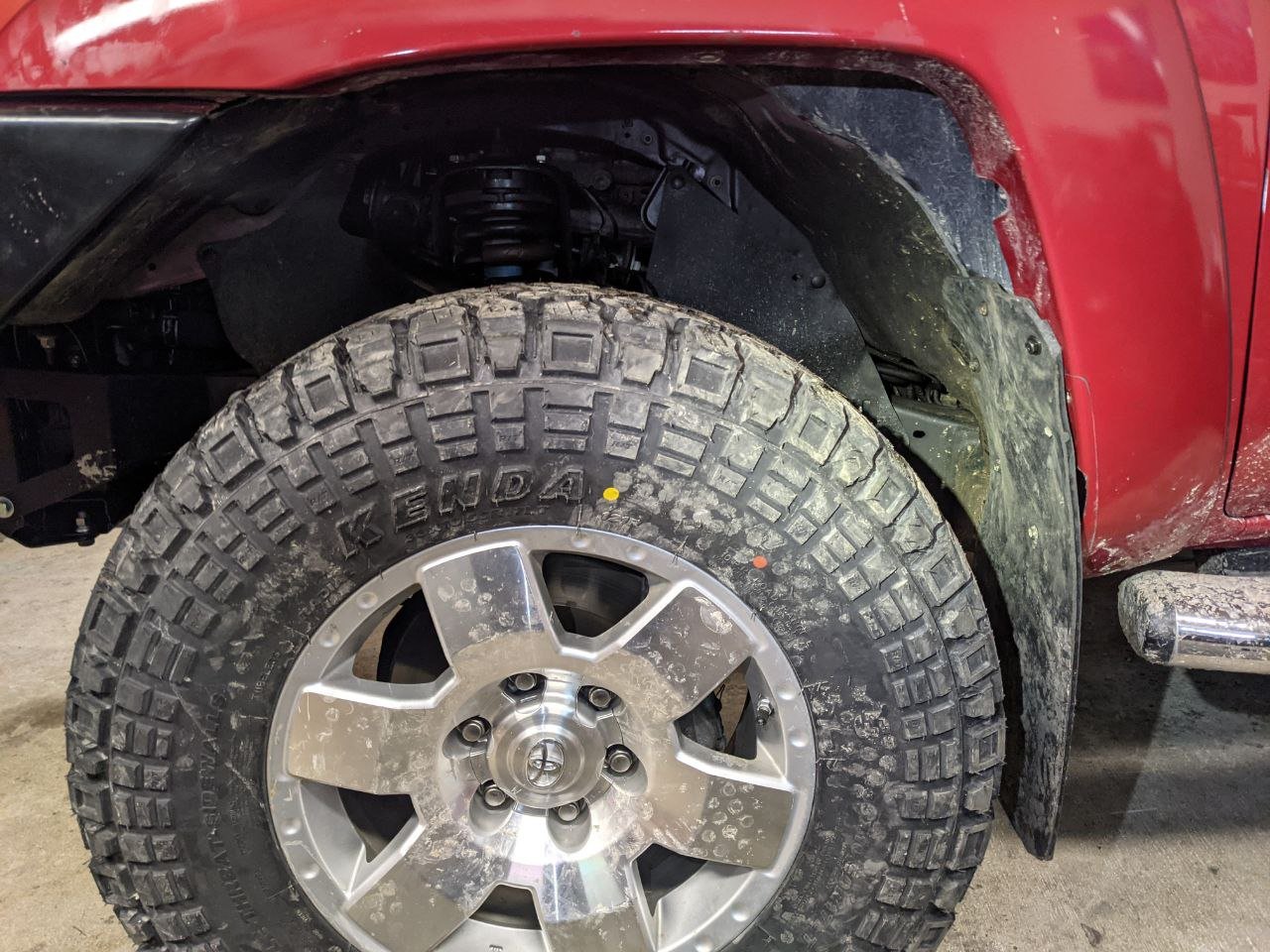

    FYI Kenda Klever 33x10.50R17 tires on FJ OEM wheels fit a stock TRD with minimal effort.
    I beat the pinch weld down, cut a bit off the bottom of the fenders, and put on some NAPA universal mudflaps. No rubbing anywhere at all. I had 35x10.50R17 Kendas on my old Tacoma, but it took a lot of work to get that extra 2". I have a set of Eibach coils and AAL in progress now to get some more load capacity and ride height.

    What has more clearance? A truck on 33's with no lift or a truck on 33's with a lift?

    Tall and skinny helps. You may not have any rubbing on the road, but offroad in situations where you need a lot of wheel travel you're going to rub quite a bit.
