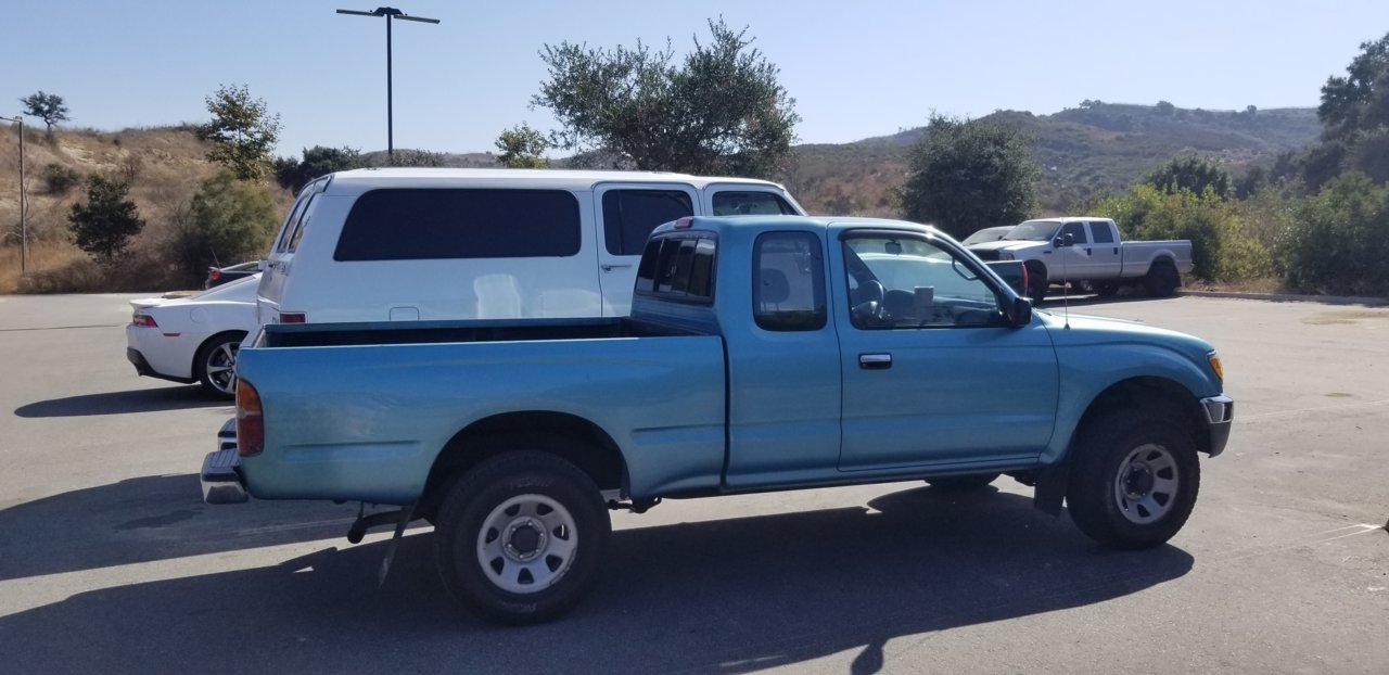

    Noob question. Will 31x10.5x15 fit the stock steel wheels on my 95' 2.7l 4x4
    Pic for attention

    The 31 10.5 15 is what came stock on my 97 and that’s whats there now. What tire size is on your door sticker?

    Yes it will fit just fine, I've been running Michelin in that size for years. I get about 100K miles per set.

    Yes sir they fit like a dream in my factory 15x7s.

    Before you jump on it check your wheel size. "Budget" version of 95 came with 6 inches rims, that is not enough to put 10.5 wide. Later years came wit 7 inch rim, and they will take 10.5 tires. So while all guys with later models are correct (about their years), 95 might be different.
    My 95 has 6 inches rims and the biggest I am able to put is 9.5 wide tire. Anything bigger is dangerous.

    Good call!

    dumb question maybe but what tire size do you reckon these are? i'm new to trucks i can't tell if it looks like a lift

    Looks like two inches of lift. Start a new thread and introduce yourself. Nice Truck and we would like to see more
