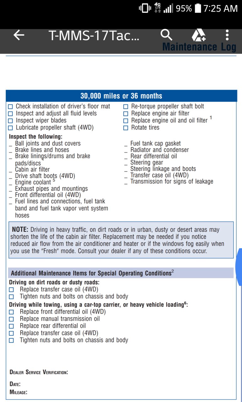

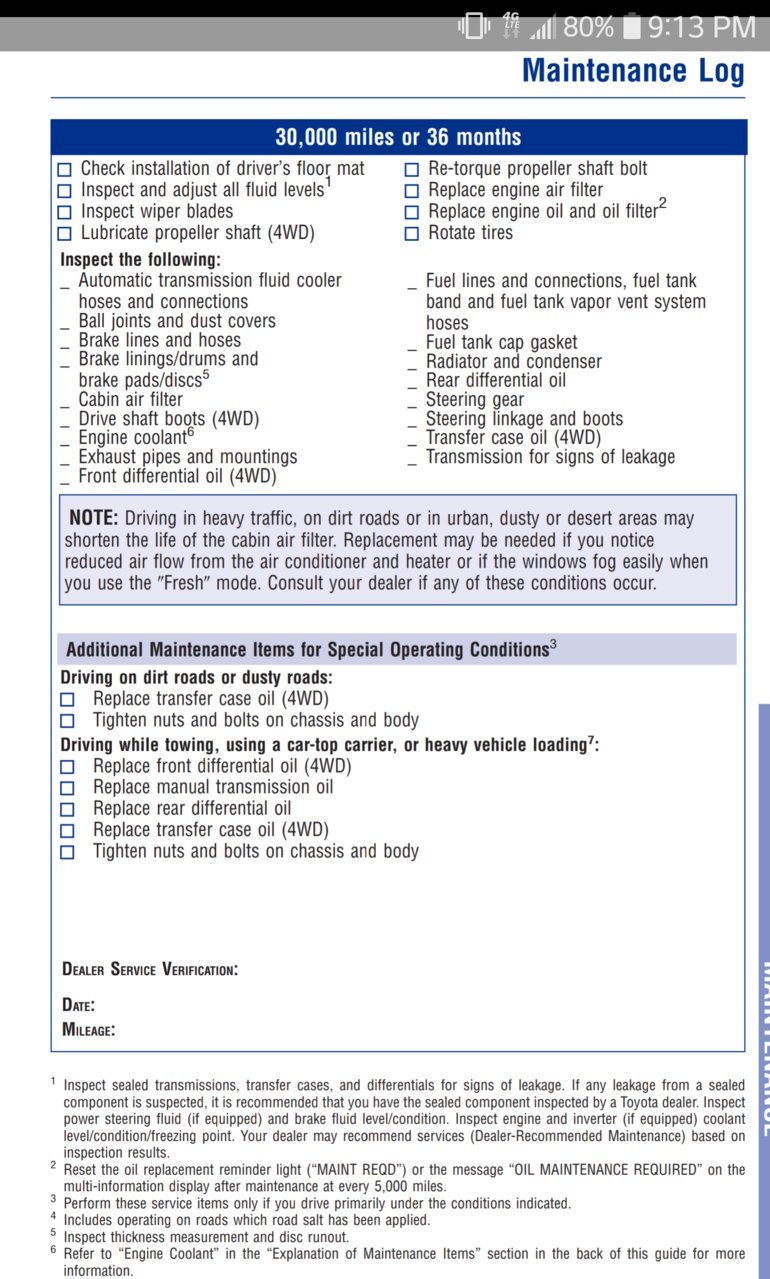

    What all does the 30k service include!? That’s steep!

    Yea all that shouldn’t even be over $200, dealerships are highway robbery for service. Paddle your own canoe when it comes to maintenance.

    My dealer quoted $217 for the full service, which is basically an oil change, tire rotation, and pulling a few fill plugs on the driveline.

    *if you are driving under "Specific Operating Conditions"

    My favorite line item, "check installation of drivers floormat."

    It's basically an oil change, air filter replacement and tire rotation.
    About 1.5 hours of time and $100 in parts AT MOST. Tire rotation can be done by self or a tire shop. One down the street from me does rotations for free.

    CYA measure so they can check a liability box after the Idiots in a Prius debacle.
    That's to get you in the door. Once they have it on the rack, they'll call back with the rest of the stuff they're supposed to do in addition to a bunch of BG upsells.
    Nobody quotes the actual 30K price over the phone because nobody wants to pay 3+ hours of work at a dealership.

    This is the result of an unintended acceleration that happened on the 06-07 models. The gas pedal got hung up on the floor mat that shifted forward and got stuck open. Floor mats didn’t have tabs to hold them in place. This happened a few times to me but I thought little about it until the recall was announced. Toyota had to settle because the issue was real and they’ve been obsessed with floor mats ever since.
