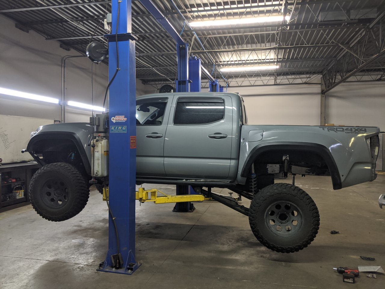

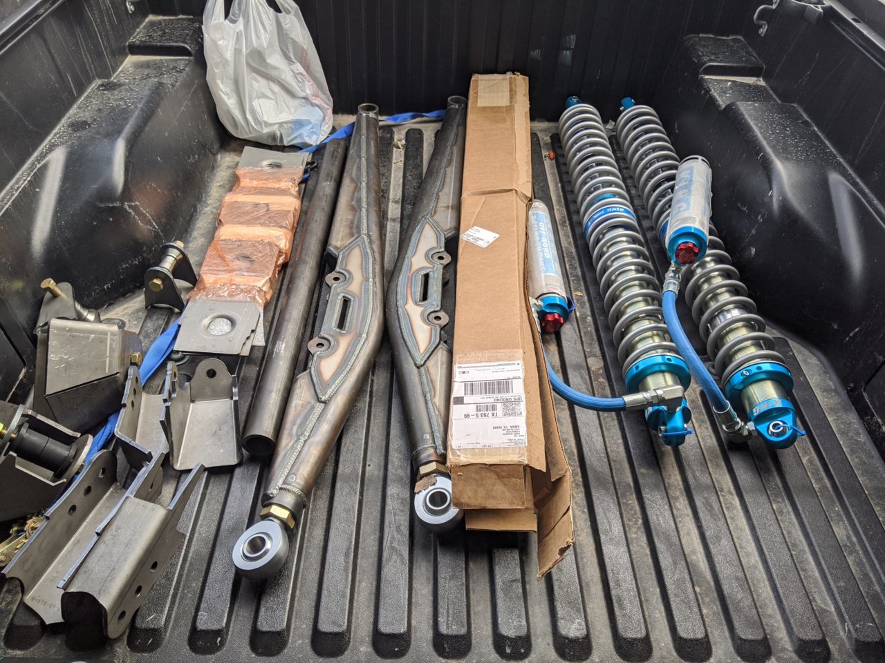

    I'm starting this build thread to help others explore different options to long travel the rear of these trucks.

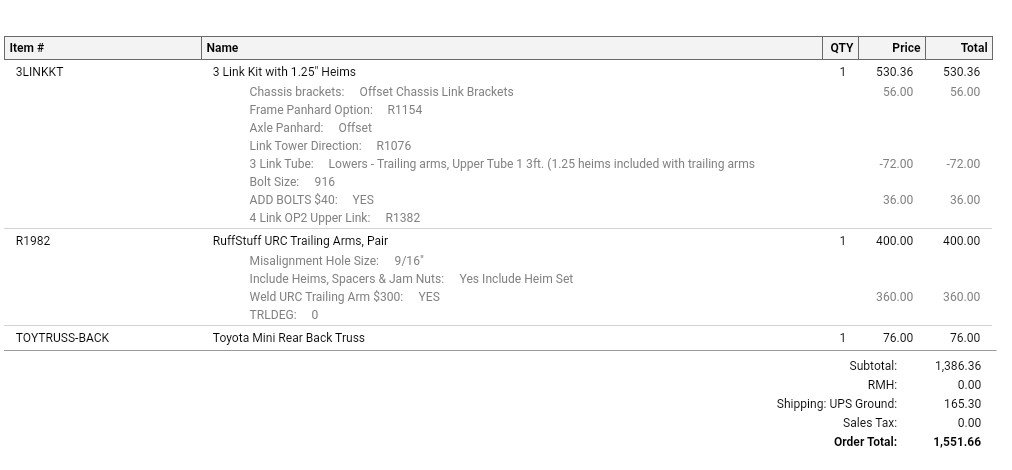

    In summary, SUA is not your only option. I've put together this 3Link kit from RuffStuff Specialties for you, so no more guess work. Screenshot_20200215-201305.jpg

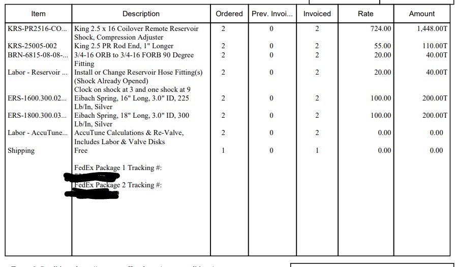

    And Im running these King 2.5 x 16" coilovers with these spring rates. Keep in mind these shocks are from Accutune, and they take consideration of your build to help you get close to a spring rate needed. I added +/- 30' of DOM 1.75 x .120 wall for a bedcage and spare tire carrier.
    I also added some frame boxing plates and extended brake lines from DMZ Fab, but I don't have that invoice.
    That's pretty much it for the kit itself.
    As always, I'm not responsible for modifications you make to your truck.

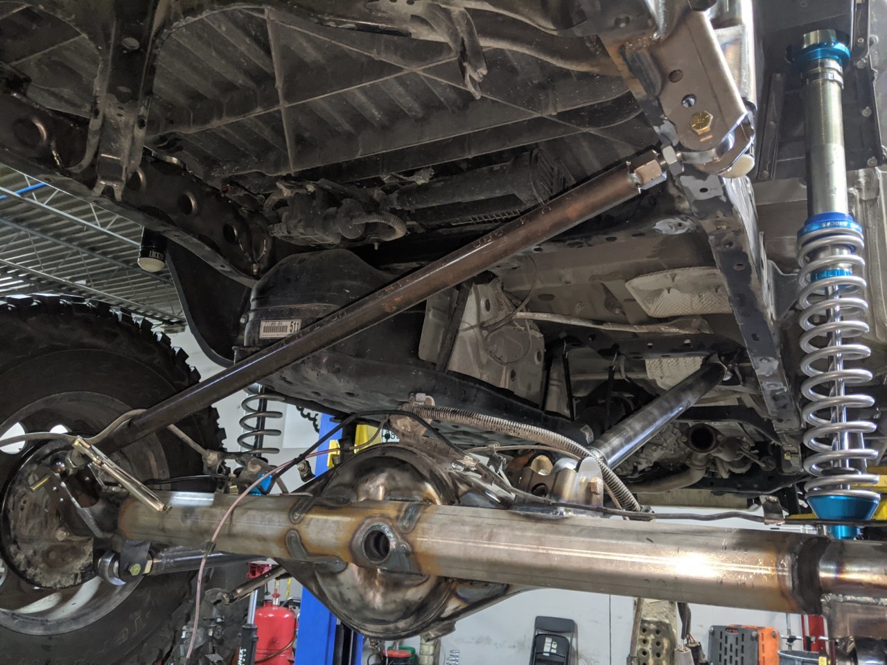

    Moving on to the installation of this universal 3 Link Kit.

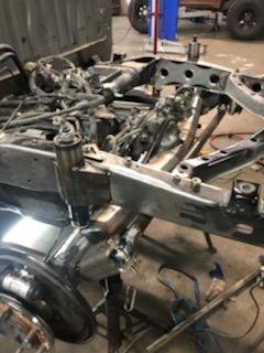

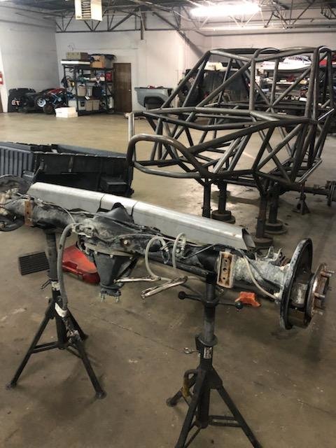

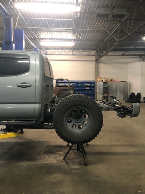

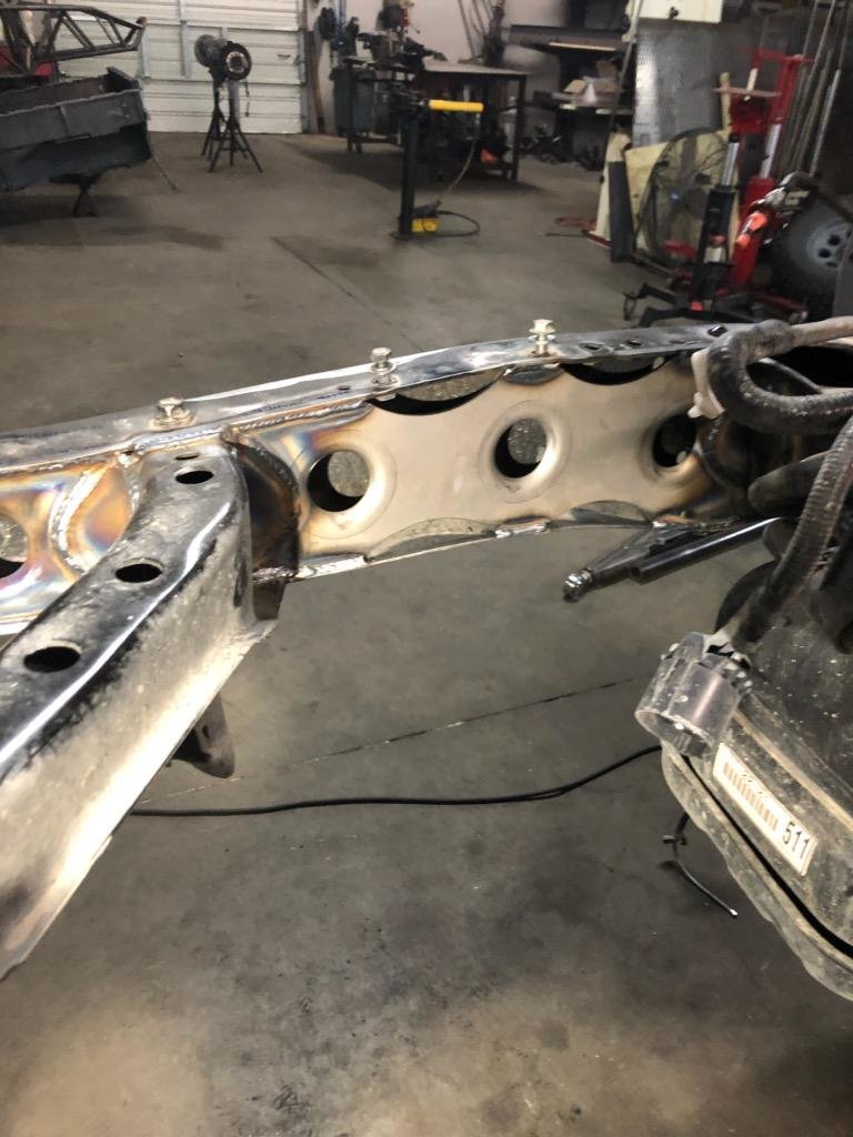

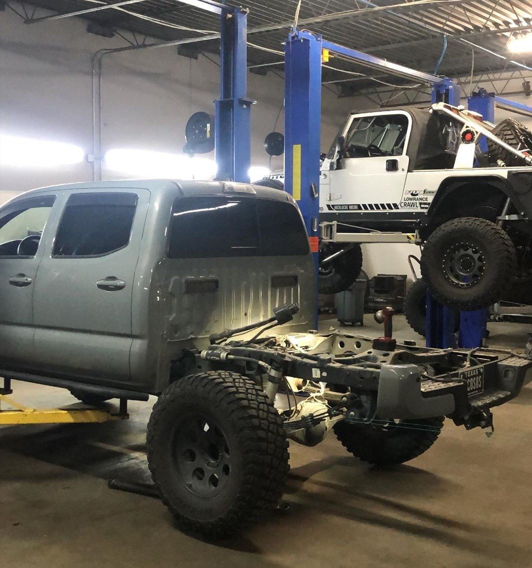

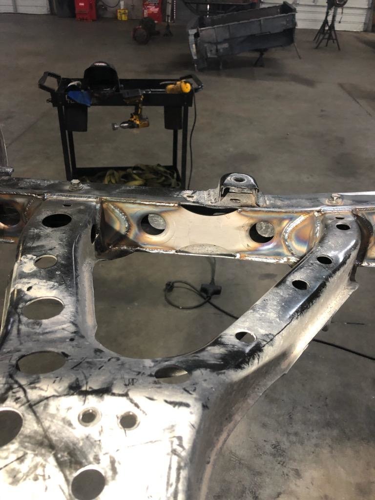

    First step was getting the frame ready-

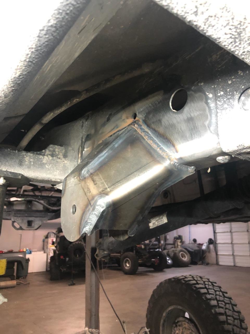

    Pulled off all the factory suspension components. Then installed the frame boxing plates from DMZ Fab.

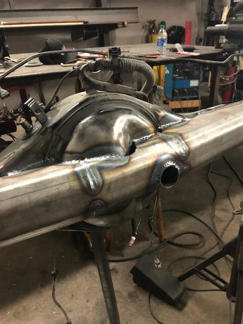

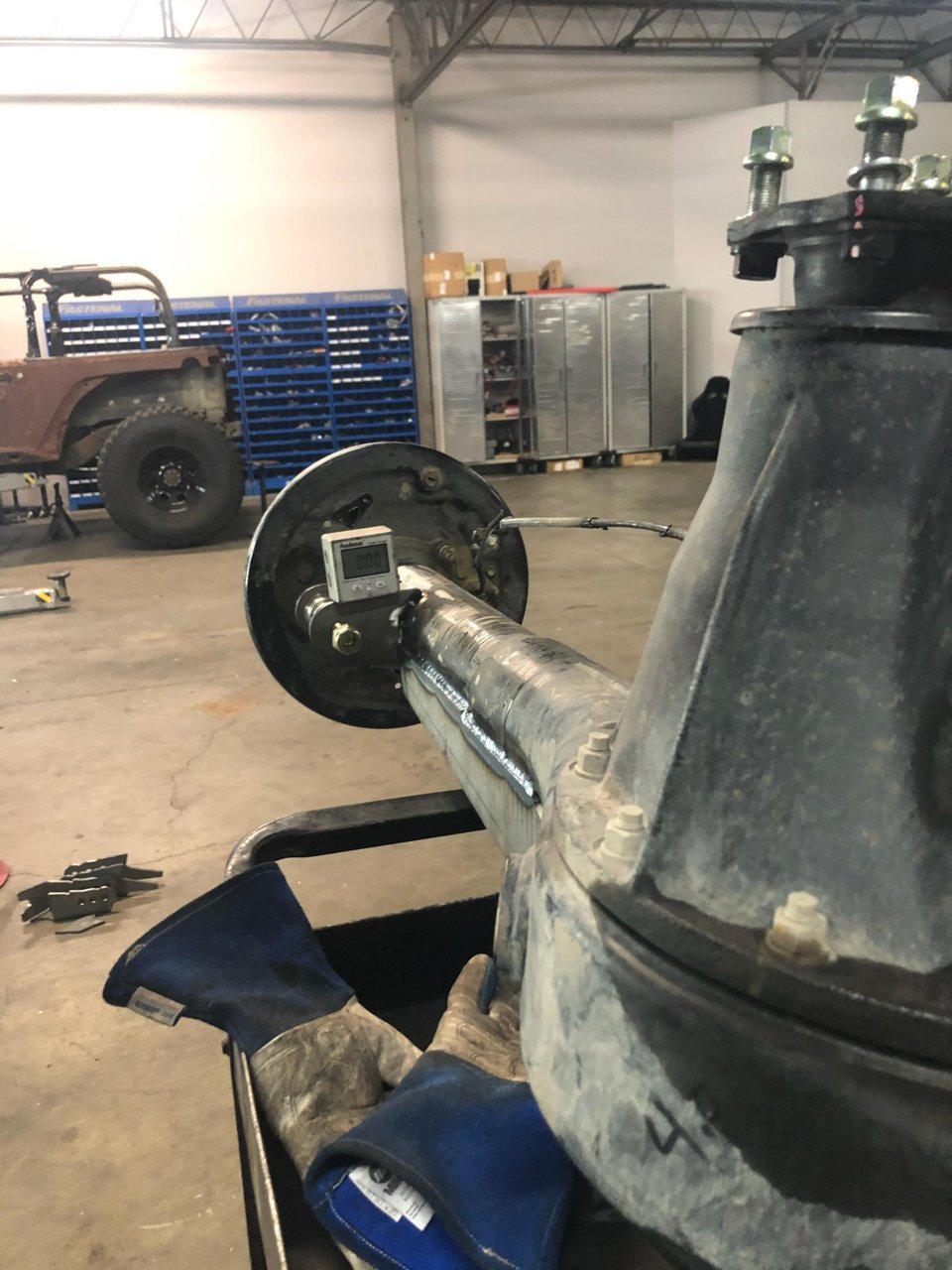

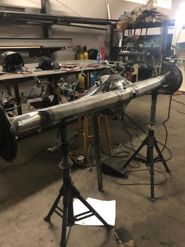

    Next up was the $76 axle truss from RuffStuff. This took some grinding to fit.

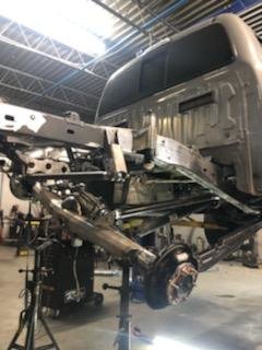

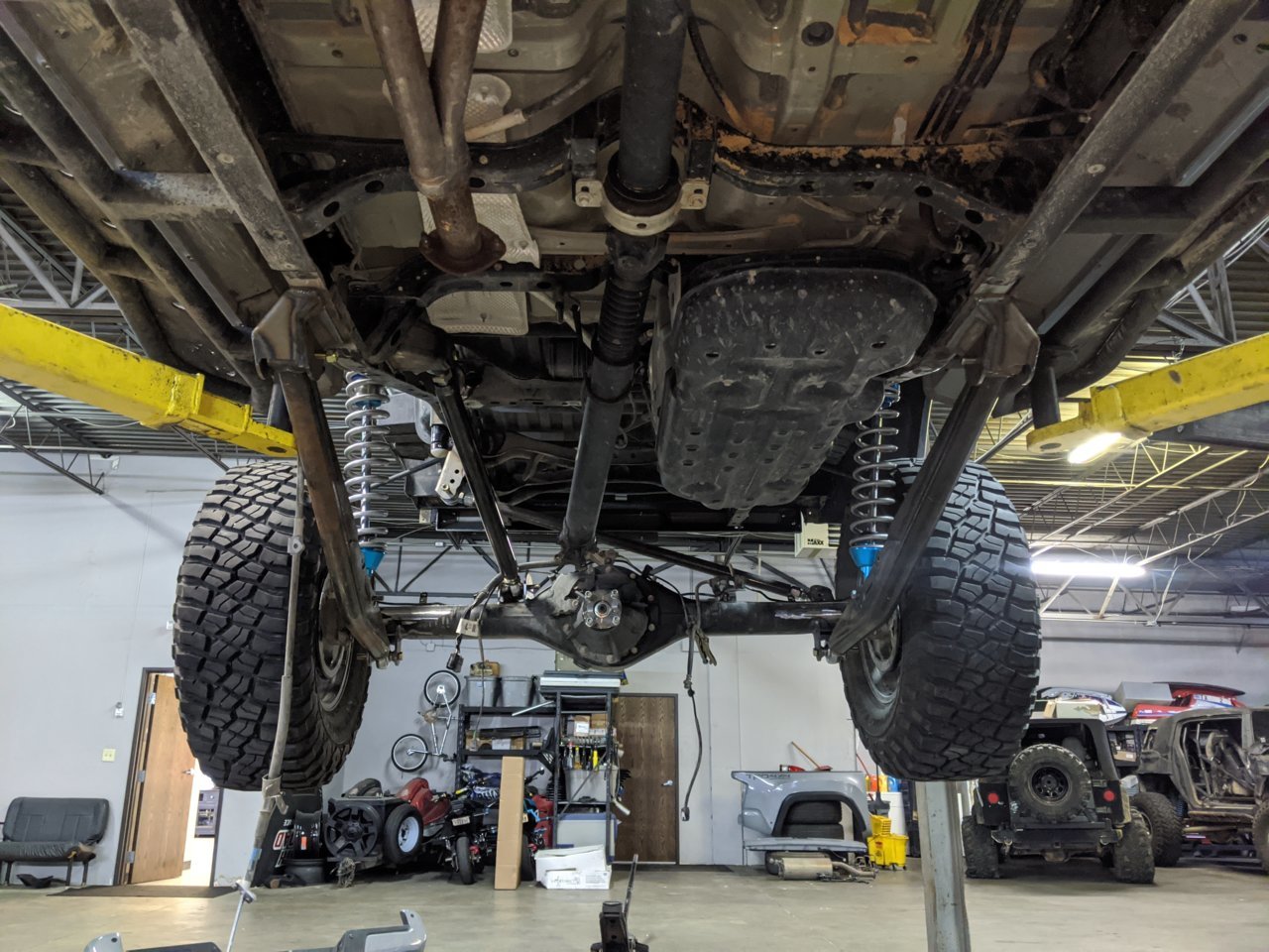

    Next was getting the axle located. For my build, I extended my wheel base by 2" because of the swing from the arms and also because Fiberwerx had a bold mold when I bought my rear fenders and the axle sat too far forward. So I fixed the issue by extending the wheel base. Now the wheel is centered in the wheel well.

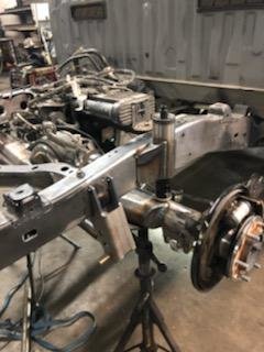

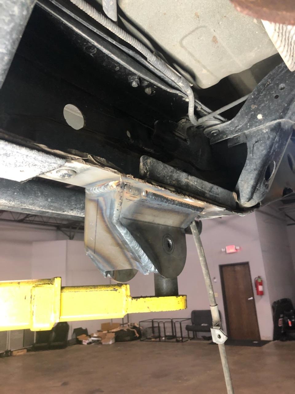

    After the axle was located the links went up, I sub'd all the correct brackets when I put this kit together from RuffStuff, I chose the outside frame link bracket and it worked perfectly. Knowing that the leaf springs mounted to the outside of the frame this was a dead giveaway when designing.
    After the link brackets were installed, the axle link tabs were squared up. Those were mounted to the bottom of the axle. I could sit here and research linked suspension all day, or just look at photos and see how the other guys are doing it. Which led to mounting them below and centered. This should give me some good anti-squat numbers. For articulation they should mounted to front of axle and centered.
    As you can see I'm still articulating quite well-

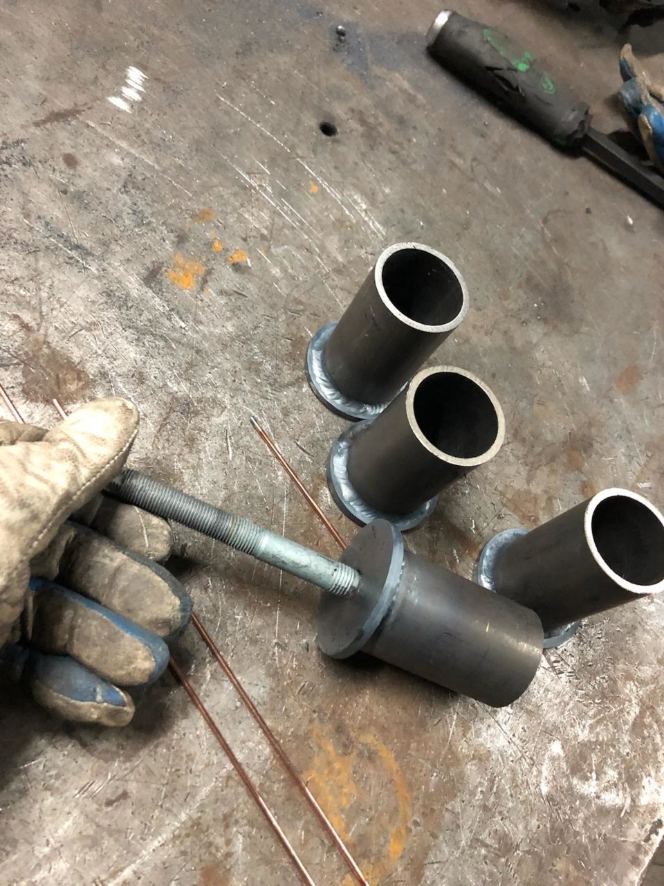

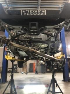

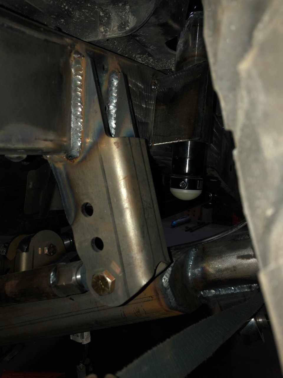

    Alright, links are mounted. Moving on to the panhard bar. This needs to be as long as possible to relieve lateral movement. So I chose the outside frame panhard mount and RuffStuff let's you cut your own panhard bar. They don't send one, but they do supply the heims. Mated with the panhard axle mount, this bar needs to be measured and cut when sitting at ride height. IMG_4976.jpg

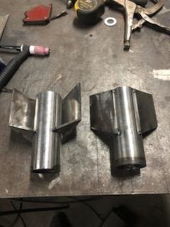

    The upper link tower in the parts list worked, but was chopped down. This made better contact to the axle. That was important because that single upper link has a lot stress fighting axle wrap.
    So that gets the kit mounted. We'll put some King 2.5 x 16" Coilovers on it next and start cycling the suspension.

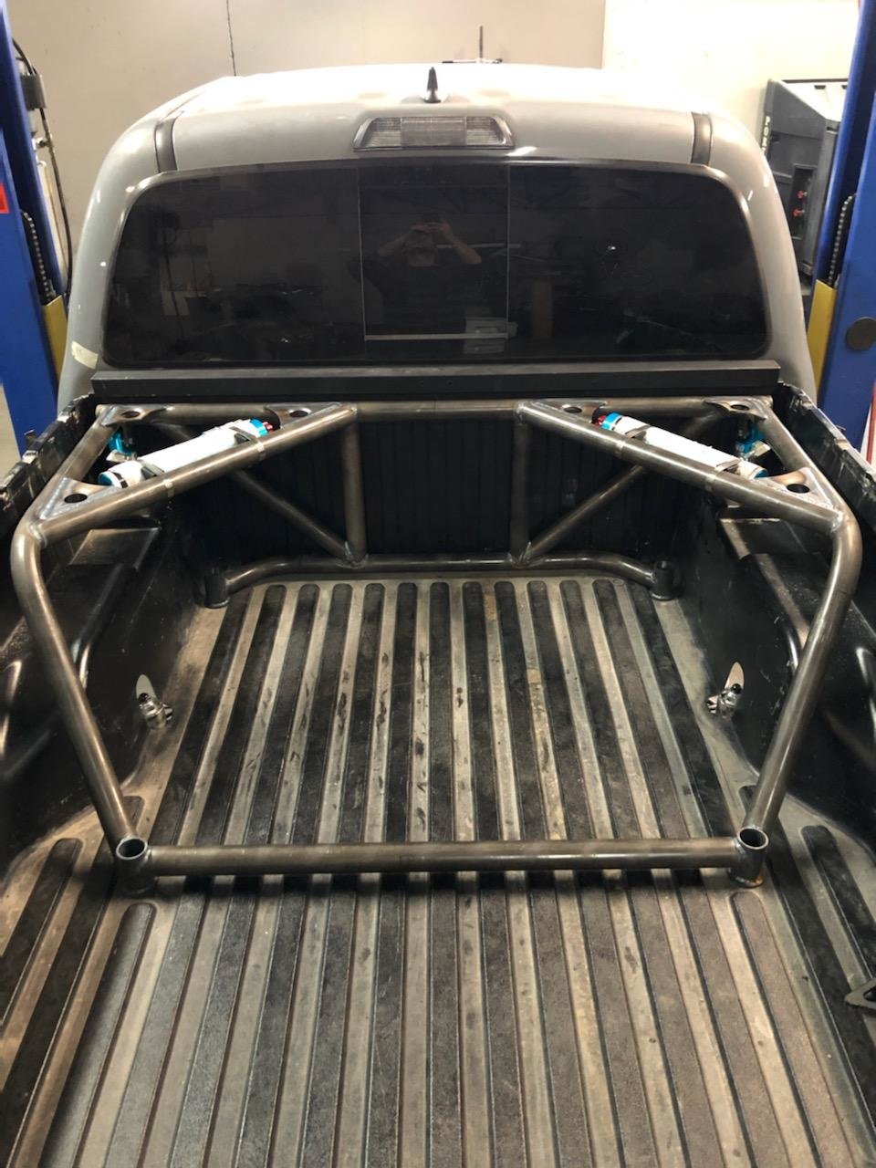

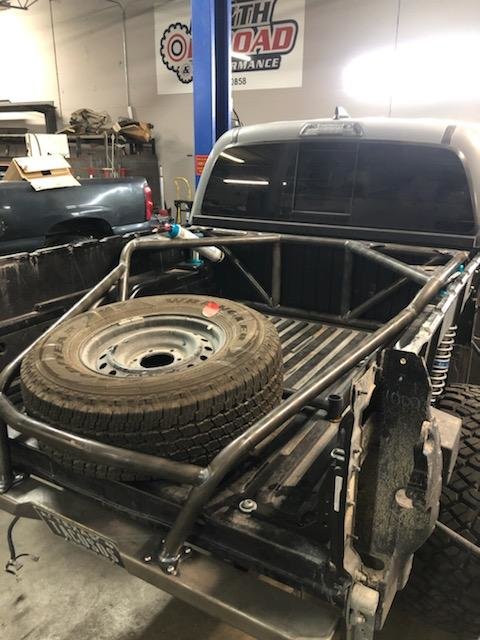

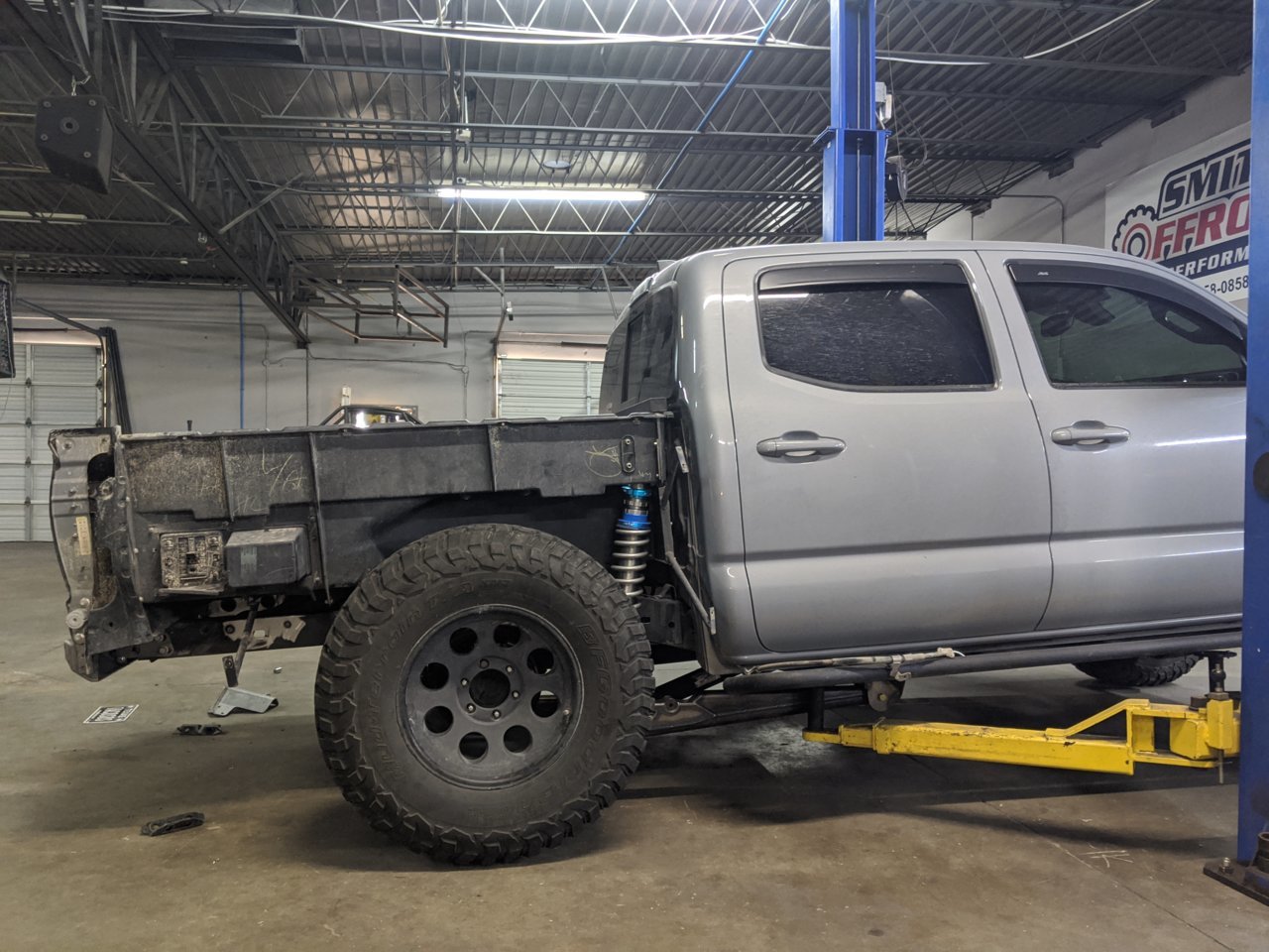

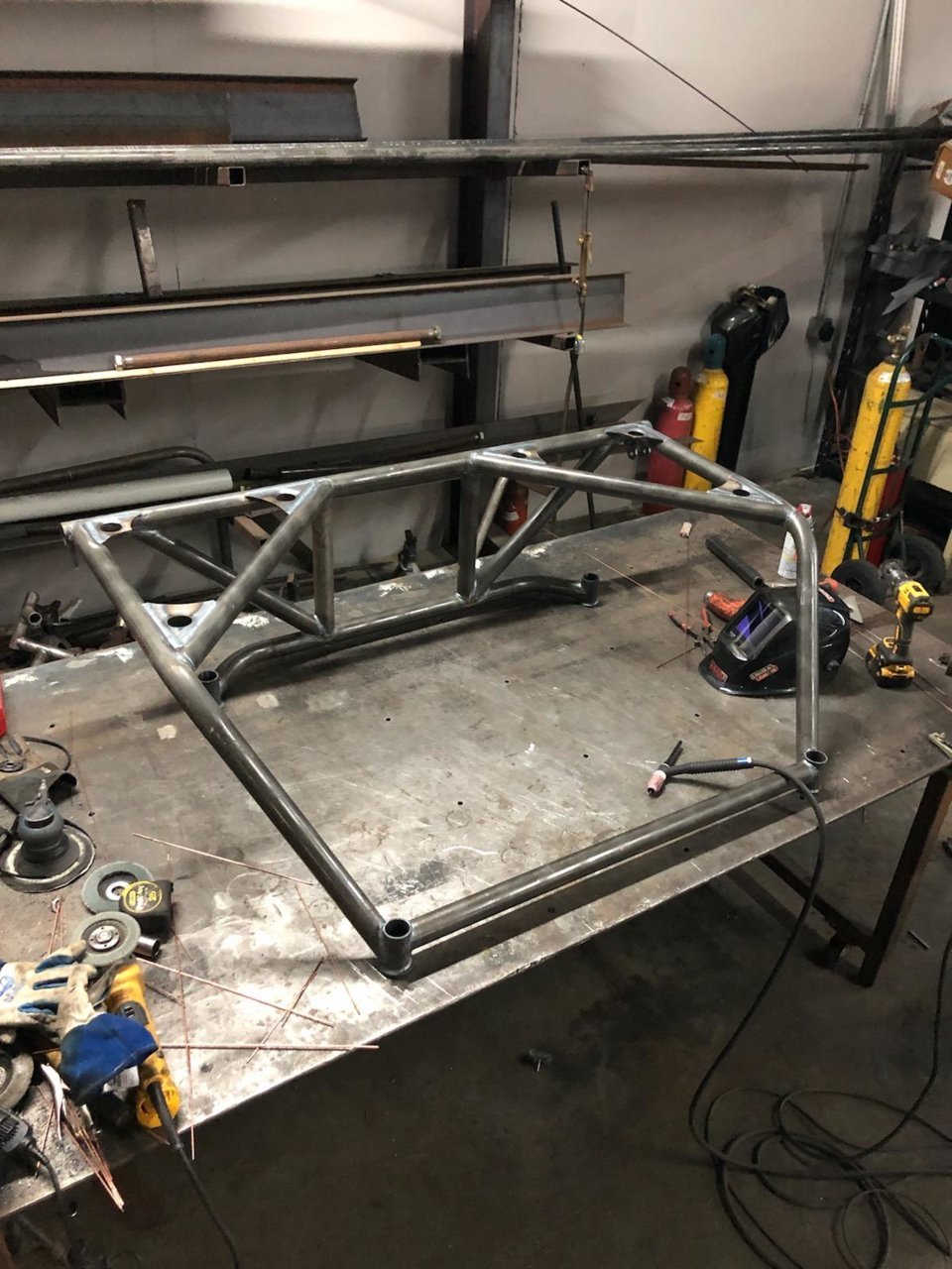

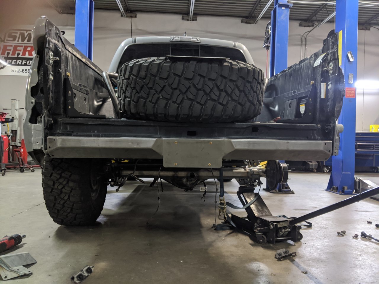

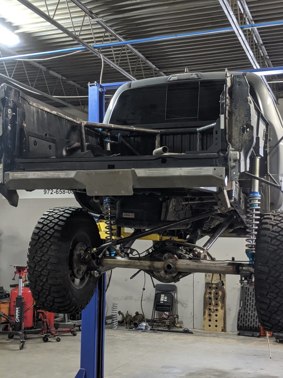

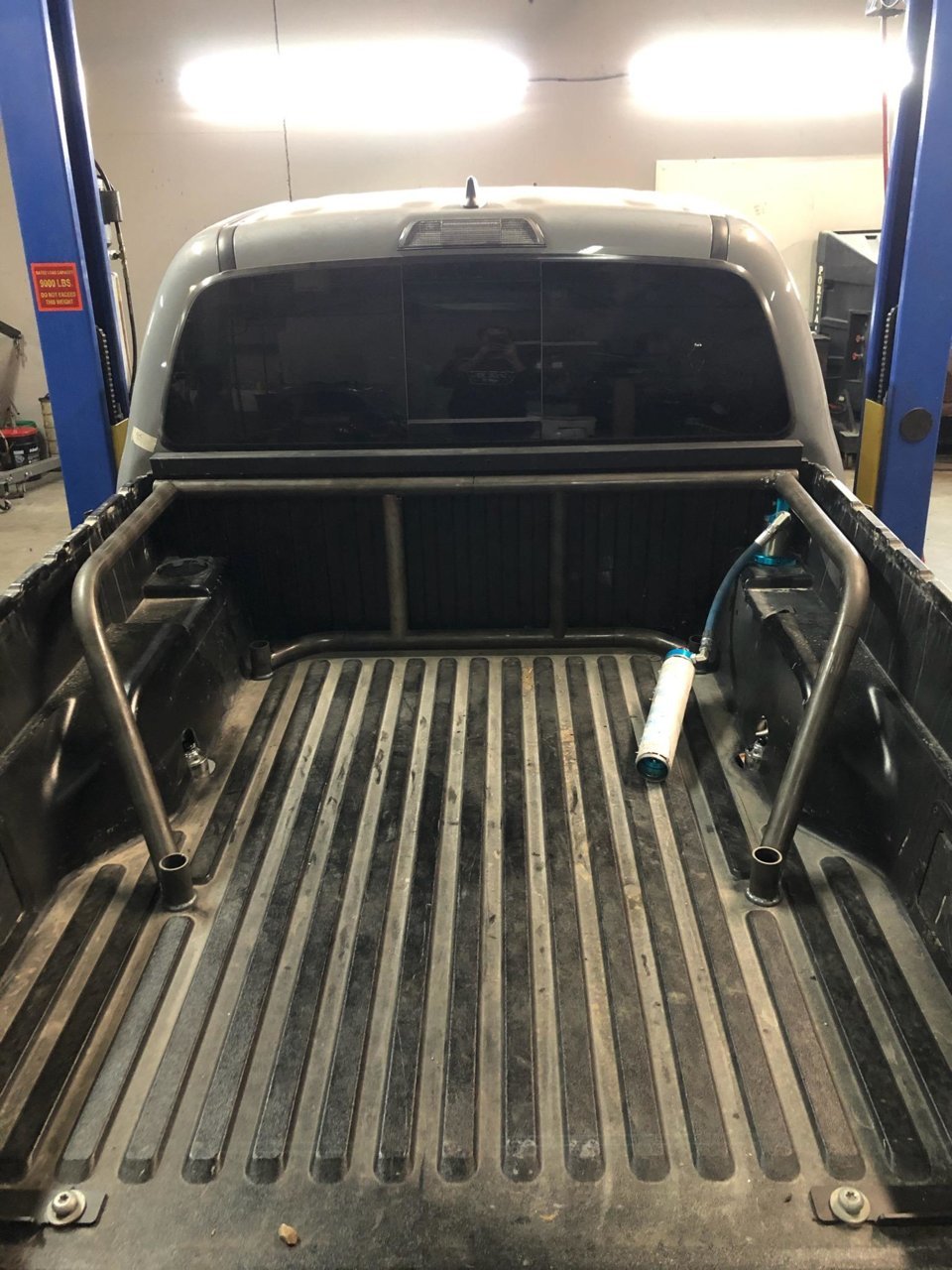

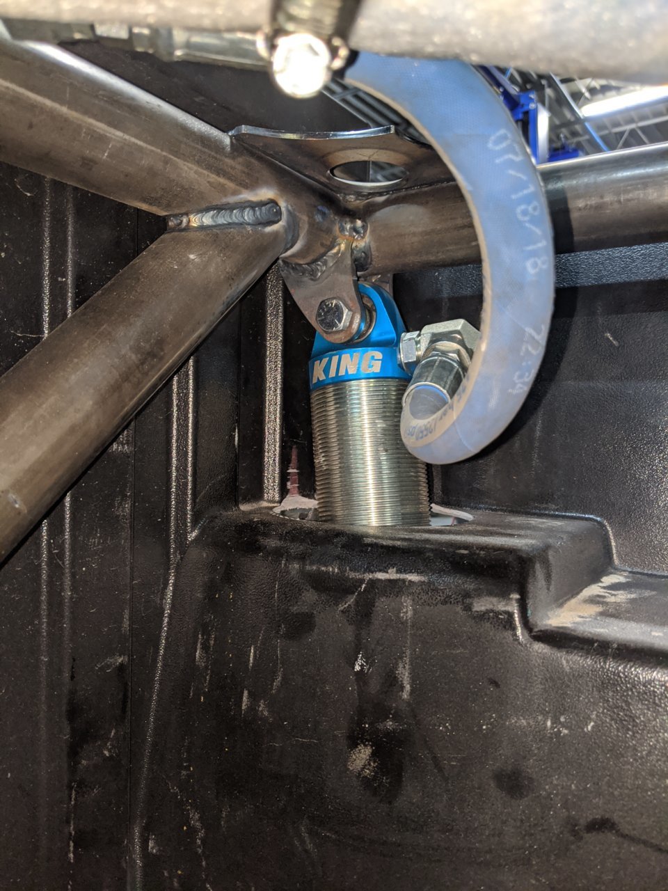

    Now it's time to get the bed cage completed. Gotta get shocks in there so we can see where we're at.
    Bedcage is done and shocks are mounted. Shock height was determined from full bump. I wanted my cage to sit nicely inside the bed.
    We added some 4" air bumps from Locked Off-road.
    Alright, so we're bumped and shocks are mounted. We're starting to find the kinks and working on getting usable travel. We'll be adding a sway bar to this kit down the road to limit some of the articulation. When the passenger side is full bump and driver drooped, the driveline is a hair away from hitting the gas tank skid. Sway bar will fix that.
    Anyways, bed is back on and we didn't cut much of it. A hole saw through the wheel well proved to be enough.
    Now that the bedcage is done, we can really see the progress.

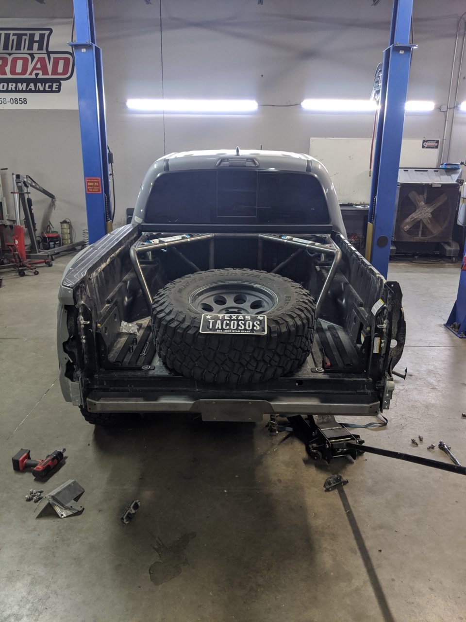

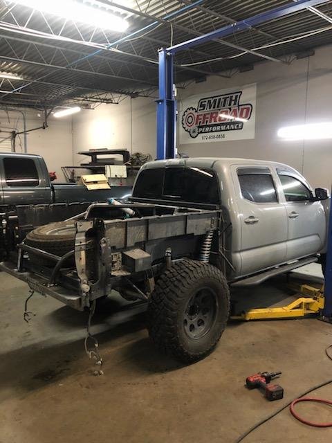

    Put some hardware in it and call it day? Not yet. We added some desired touches to it. Added this tire carrier to the bedcage. Great! Now I gotta buy a spare too! IMG_20200215_115121.jpg
    And a good shot of the Mazzula Off-road bumper. They started building a Tacoma variation, so I picked one of those up and drizzled taco_sos on it. We Tied the bedcage in to the rear bumper. See pic above for that. IMG_20200215_115128.jpg
    That's the build as of now. I'll add some pics for final, but hopefully this thread will help you explore more options. All together the entire kit in the photo below was right at $5k. See more on Instagram @taco_sos.

    Hey bud! Glad you found this thread! It's important to take a few measurements before taking the truck apart. Measure your ride height so you have a reference when putting it all back together. I knew I would be lowering my ride height, the truck had bad rake. So I accounted for that. It's very important to make that panhard bar as long as possible. The axle is neutral location when at ride height.
    Another good measurement to grab is pinion angle. Mine was 4 degrees.
