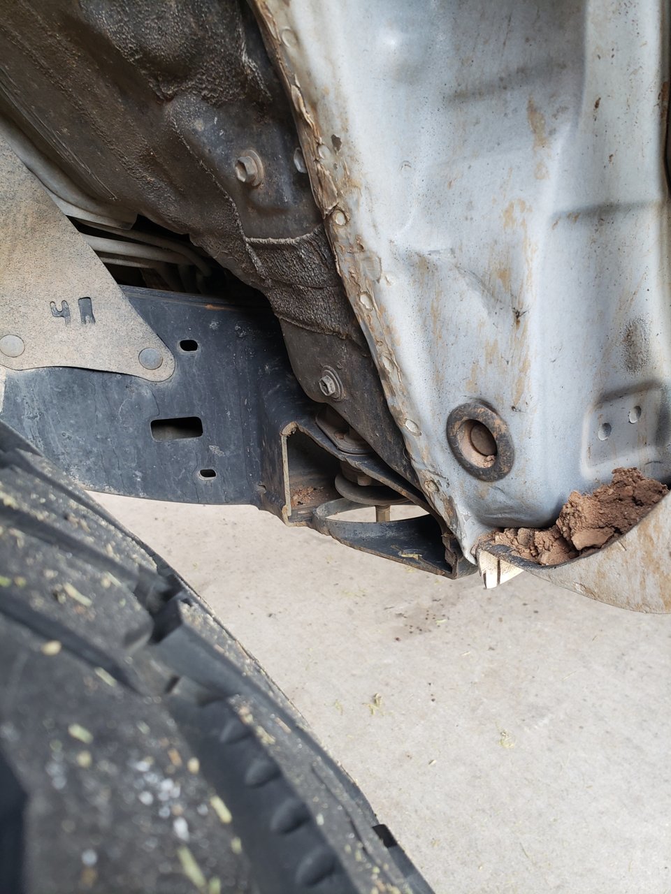

    I'm running a 3" lift with 1.25 Spidertrax spacers, 285/70/17 Cooper STT Pros, and Method Double Standards with something like -12 or -14 offset. Required a cab mount chop for sure, but no rubbing afterward. Imo you'll have to do a cab mount chop, but depending on the wheel offset you may not rub as bad

    How many inches and do you have pictures of the chop?

    I have ~3 inch lift. Maxed out lift on icon coilovers. The cab mount chop is really not a big deal. Mine's held up fine through all kinds of abuse. But you will rub unless you chop some of it. And pound the pinch weld flat with a sledge hammer, as shown in pics. Took me about 60 seconds to do and it's water-tight still.

    Thanks for the pictures, looks real good!
